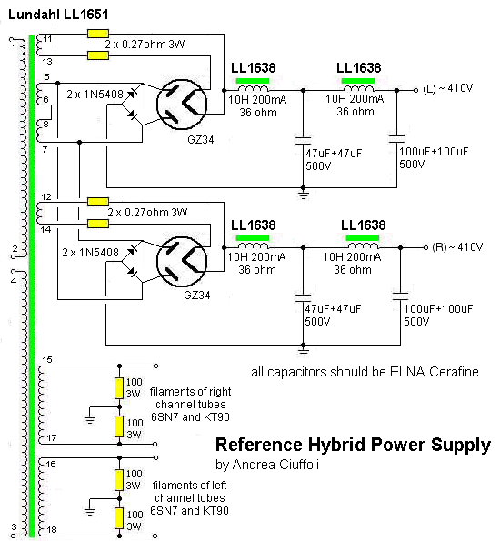

If I put two transformers in series that each can deliver 100 mA, can I then take 200 mA from the pair ?
Approximately, yes. However, if one of the tansformers delivers slightly less voltage than the other, or behaves differently when loaded, the other transformer will sink some current in the 'different' transformer. So I would be very careful.
(and remember that you'll need to have the phases of the windings correct, or otherwise you'll have an instant short-circuit)
Would you not get double the voltage, not double the current running them in series?
Perhaps you mean in parallel, where the above comments would apply?

Nope.
Series doubles voltages, not current. Actually, due to I2R losses, the current will probably be 0.95 times that of one unit (ref: Hammond data sheet)
Parallel doubles current while voltage remains the same.
now I understand
why I can fry an egg on the transformers. I will set them parallel and will a take another circuit to get the needed voltage (scottky diode + tube rectifier in a bridge, omitting the center tap).
Thanks guys !

scottky diode ? are 40volt max. after it s a short circuit
but send a schematic to understand your design
but now turn off 🙂 your power supply because
transfo are very $$
transfo are very $$
ok it s not a schottky diode but a 1000volt diode
test :
1-take just 1 transfo +BYW96E bridge +tube diode(for turn on
delay if i understand)
2-without load check temp after 1 hour (max. 40 to 50 C )
3-if ok try maybe 25ma after 50ma after 75ma to find the
max load for 1 transfo
