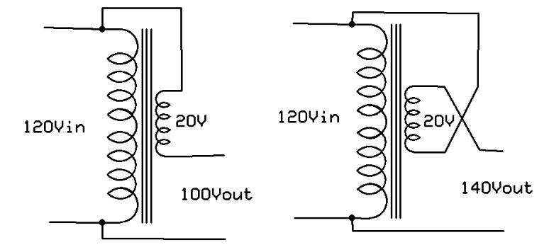

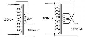

You only need an 120V to 20V transformer with 215W/100V=2,15A capability.That is 20Vx2,15A=43VA.With a 50VA 20V transformer opposite phase in series with the 120V you get 100V 2,5A to use.

It seems to me that for not-LOUD use, a 120V:24V 40VA transformer as used in furnace and A/C applications could be re-wired as AutoTransformer. However this is dangerous if not done exactly right.
