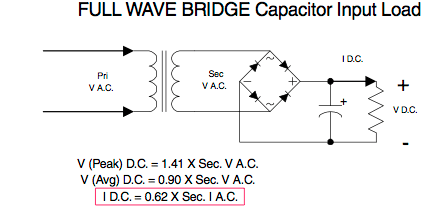

The only thing I don't understand is why PSUD2 is seemingly inconsistent with the Sowter/Hammond design guides. They both indicate the AC current should be specified as 1.6x the DC current for a bridge/capacitor configuration. If I simulate the same in PSUD2, it's more than 2x the DC current. I'm sure they're both right, and it's just a matter of definition, but can someone help explain the difference.
Thanks.
You probably have an unrealistic source resistance specified for the transformer in the model.
Just eyeballing it, I would expect the transformer to be closer 70 ohms. That makes your Rs/Rl ratio around 0.05 and the Irms/Idc ratio about 1.8. Not far off the typical figure of 1.5. http://valvewizard.co.uk/psu.html
