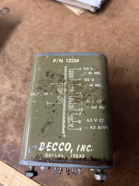

Got this PT below, as you can see it has 2 235v @ 60ma winding. Can I connect terminals 3 and 4 to create a center tap for a 235-0-235v @ 160ma?
Also the input is 115V @ 50Hz how will this be effected by a 60 Hz input.
Wanting to use it for a preamp.

When connecting terminals 4 and 5 to form a center tap, if the voltage then between terminals 3 and 6 is small and not ~470VAC, remove the connection and jumper instead terminals 4 and 6. Now check for 470VAC between terminals 3 and 5.
It will perform better at 60 Hz than at 50Hz.

Connecting T3 and T4 together will short out that winding and destroy the transformer. Connect terminals T4 & T5 together to get a CT. If you get no voltage across the pair of windings, then reverse the polarity of just one of the two windings; either one will do.
Blind Lemon,
Before making any connections on the secondaries, I suggest to connect
the primary to 115VAC and measure the AC voltages on all secondaries,
especially compare the voltages on 3-4 and 5-6 windings.
I find it suspicious that 3-4 depicted with 4 "turns" and 5-6 depicted
with 3 "turns"...
Also, make sure that your transf is not buzzing with only primary engaged.
<Would it still only handle 60ma with using it as 235-0-235 because its
in series not parallel?> -Yes.
If you want to connect the two identical windings in parallel, you must first be certain of the correct phasing of the windings.
Connected wrongly, the transformer will be destroyed instantly upon applying power.
