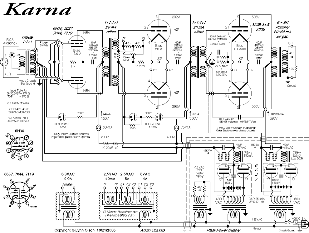

The other considerations
The test you made with the piece of steel buffered by aluminum does show that it is mostly external field linking that you have to solve. The thing to keep in mind is that these things are essentially infinite in reach so you have only a few methods of control open to you.
One is just what you did, create a flux shadow by compressing the field lines directly between the two transformers by attaching them to a mildly permeable material and steering them around the OPT's. More of this is a good thing, to a point. Extending the shield piece too far beyond the core pieces will actually hurt your effort. so do not get much more than an inch beyond the transformers metal work. You do not need to shield this external sheet with anything more than .010 of cardboard, even a piece of scotch tape is a good enough insulator. In some cases attaching the shield metal directly to the core of the emitter is a good idea, you will not short the core out.
As an aside, when wrapping a core band around a transformer core, it should extend about 0.050" beyond either core edge. Less will increase the emitted field dramatically and more will be wasted to no further benefit.
When reorienting the power do not hesitate to also reorient the OPT's and do not worry too much about getting everything nicely lined up and squared away. Your situation may require all three to be at odd angles to each other and the edges of the chassis. Also it would not hurt to alternately flop them over on their sides, if that is possible, and steer the power generated field around with the two different types of transformers alternately on their sides and then on end bell faces.
These two, the shield and diverse core orientations, may also need to have the OPT's on standoff's to complete the process.
