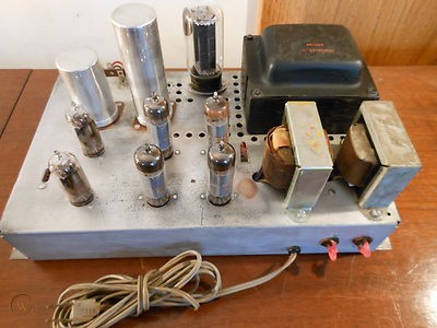

The RS177 amp from my RCA stereo console - 4x 7189A's - 2x 12AY7's - 5AS4 rectifier (Original 1962 date code).
And modified with Concertone output transformers, additional filtering, etc.
That PS transformer runs hot like an oven, but it's still chugging like a prince.

I an known for running my stuff hot, Those temps seem fine to me. If it's under 100C, it's probably alright. I have an SE MOSFET amp that reaches 95C heatsink temperature, and that's within spec, too. Even the latest CPU designs are running at almost 100C now.

oldtimers seldom see traffo heating as an issue, the newcomers do....
but wanting a power traffo that does not heat up much is not an impossible thing, you just have to pay extra for it...
using M6 silicon and running the traffo at lower flux density can make the traffo run cooler, in other words, oversizing it...i take this into first consideration in all my traffo builds, "build it like a tank" says PRR, but within reason of course....
A transformer can also heat up if the load is not in ballance (in case the transformer has a center tap) or a single diode is used or a dc voltage is applied on it (and dc current flows).
A transformer can also get hot doing F all. Just plugging in a transformer without a load will heat it sometimes.

transformer heating is of the following; hysteresis loss wing to the weight of core and grade of steel used and flux density, eddy current loss owing to the thickness of laminations and surface insulations...
there is another source of heating, the rectification process distorted the secondary currents contributing to heating the core by 30% from what i gleaned from technical writings...
