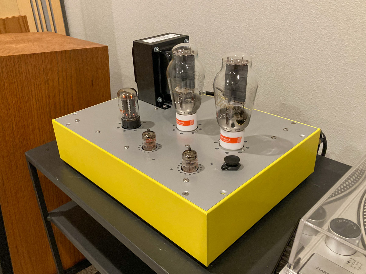

I built a Tubelab SPP with Hammond transformers throughout and really enjoyed it.

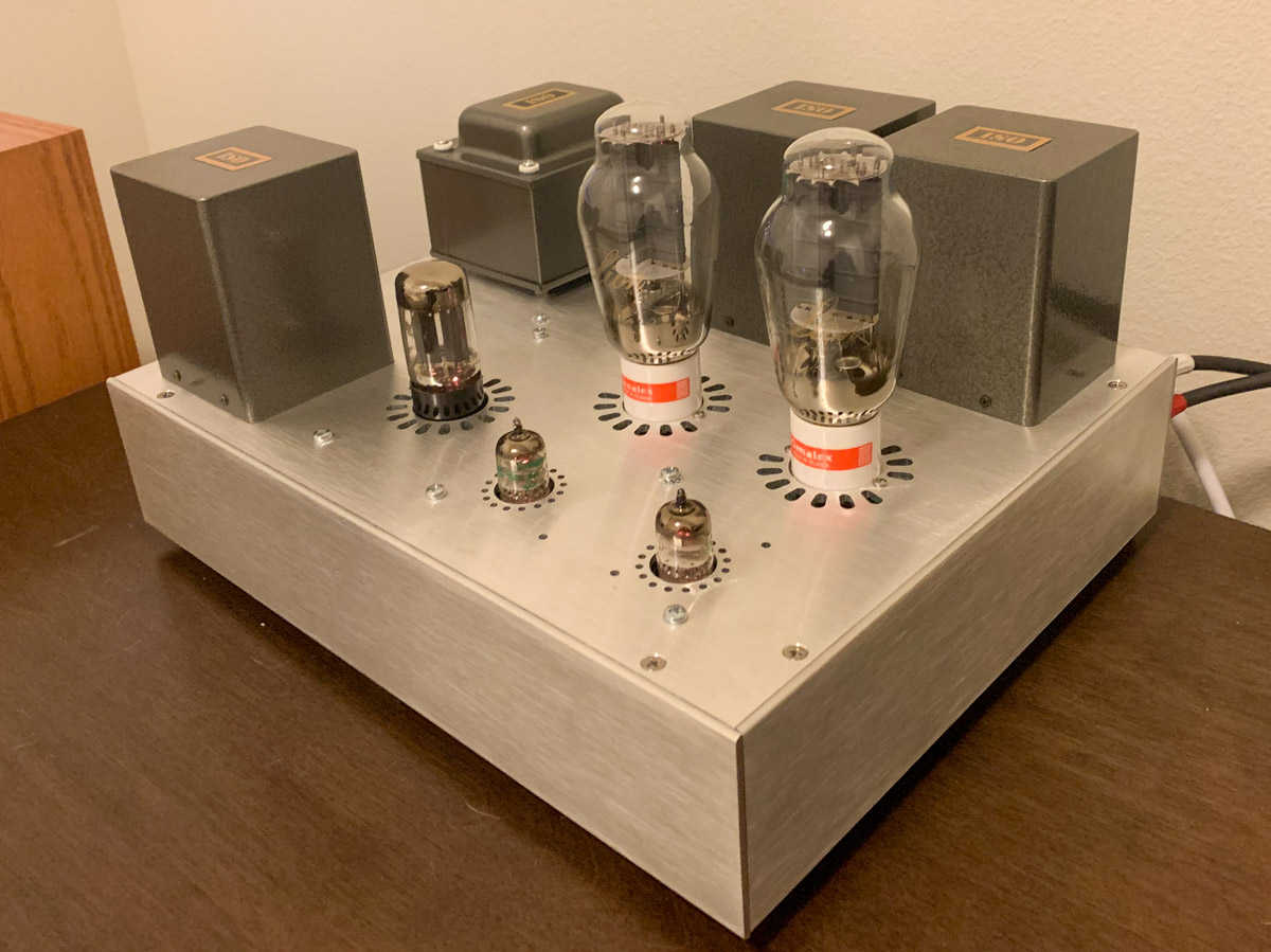

I recently decided to build an upgraded version, where I'm using Hashimoto power and output transformers (with a Hammond 193 series choke as the Hashi was very expensive)
I purchased them from Mr. Isao which is the US distributor and the PT was 120V (has a "B" suffix)

The Hashimoto SPP is assembled in the chassis but not wired yet... I'm hoping to complete that within the next week or so.
The build quality is amazing, but you probably know that from the OPT's you already have.
I've built a TSE in the past with ISO (ex-Tango) transformers, also very good but I suspect a notch below the Hashimoto.
The biggest difference when going from a Hammond/Edcor PT to the ISO was that it was super quiet and cool after hours of operation. No buzz or noise at all, whereas I could hear the Edcor buzz from a few feet away. The amp was also dead quiet even with my ear near the speaker, so I believe that choke was better at filtering than the open-frame I used prior to it.
To give you another option to consider, I just finished another TSE with Lundahl output transformers, the LL1663/50mA. I originally bought these for a single-ended EL84 but ended up using something else for that build.
I chose the operating point of 350V B+, 50mA per 300B, which is limited to about 6-7W but has low THD. I used a Hammond 372JX and have been really pleasantly surprised by it. It also runs very cool and quiet compared to the 370HX I tried in the past.
