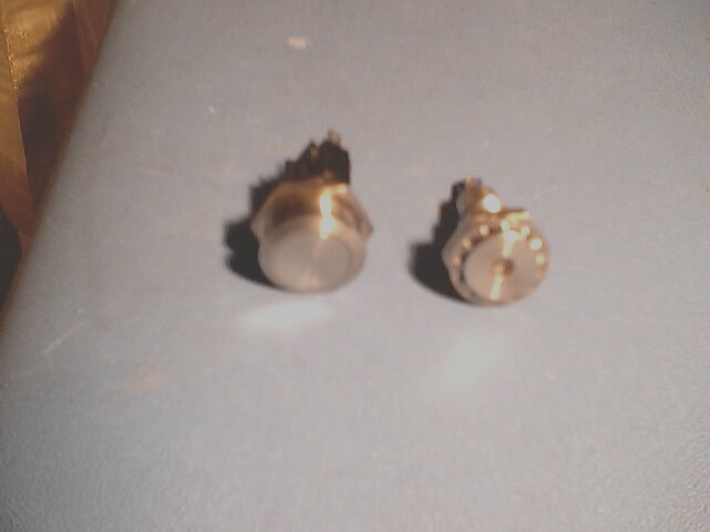

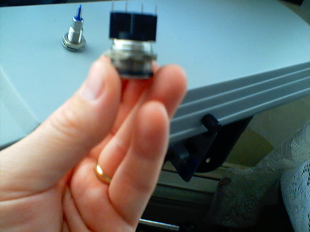

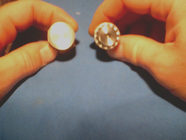

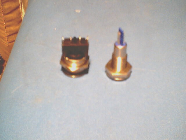

hello guys , I just got these power switch and blue led, of course! from bulgin, but I need some inputs on how to set up these beauties.

It's a momentary switch, with bugger-all power capacity, so you need to build a bi-stable circuit to operate a relay. I use the exact same switch in my preamp to torn everything on (except mine as the green centre LED). I can't remember what circuit I used, but if you search the forums for 'bi-stable' circuits I'm sure you will find somthing.
I'm also interested in how the heck you get the back off these switches, as I want to change my green LED for a Blooooooo one :cool:
