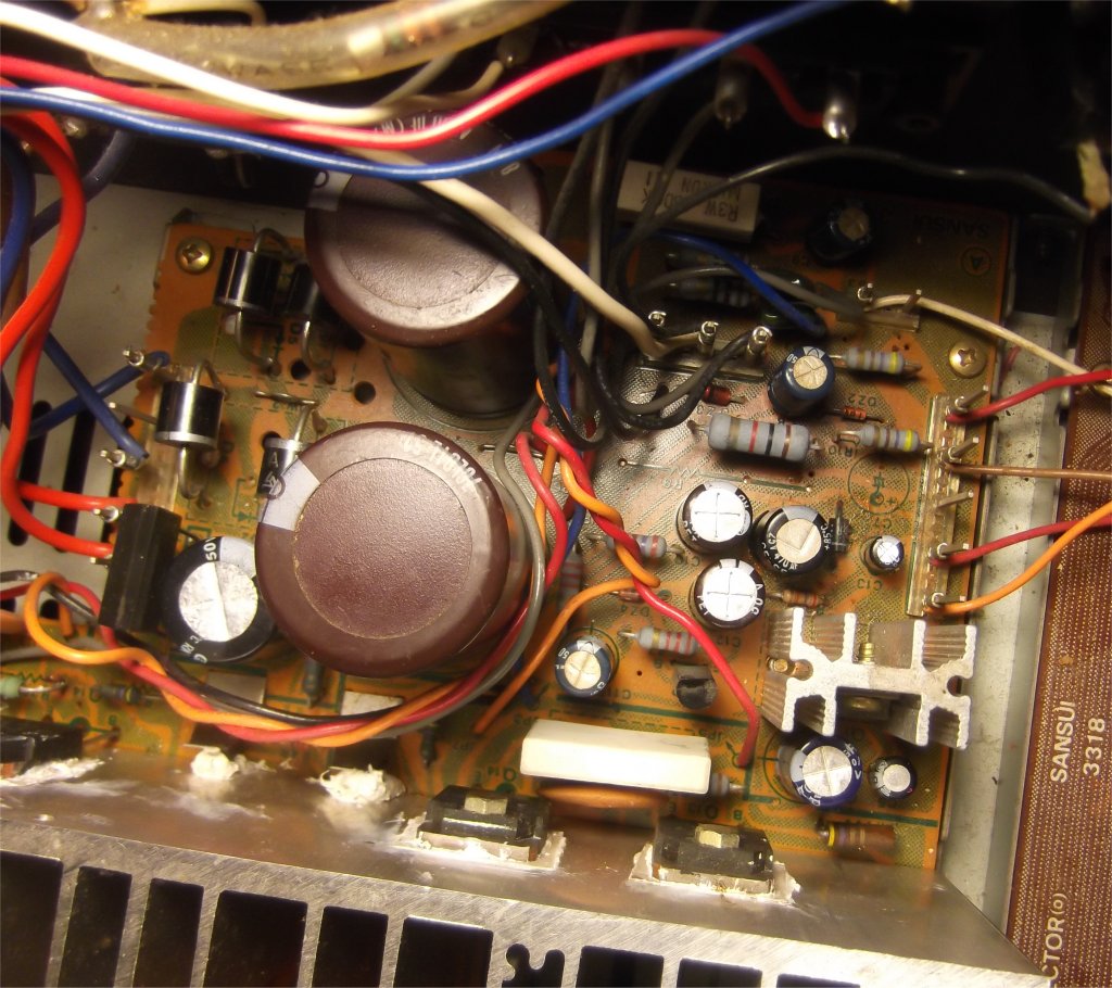

Just replaced ALL the PS caps in my 32 YO sansui (1981 Z3900 -below).
Turned it on - at high volumes amps crackled = bad main rail caps.
All seemed good , phono preamp hummed - the +/-15V aux. supply caps.
Tuner would drift after warmup = all the other aux. supply caps.
Every cap (all 12 of them) in the supply section was either "shot" or "on the edge". 😀
BTW , it were the caps that saw the most ripple (main rails + main aux PS)
that were actually leaking. All semi's survived , luckily. 🙂
