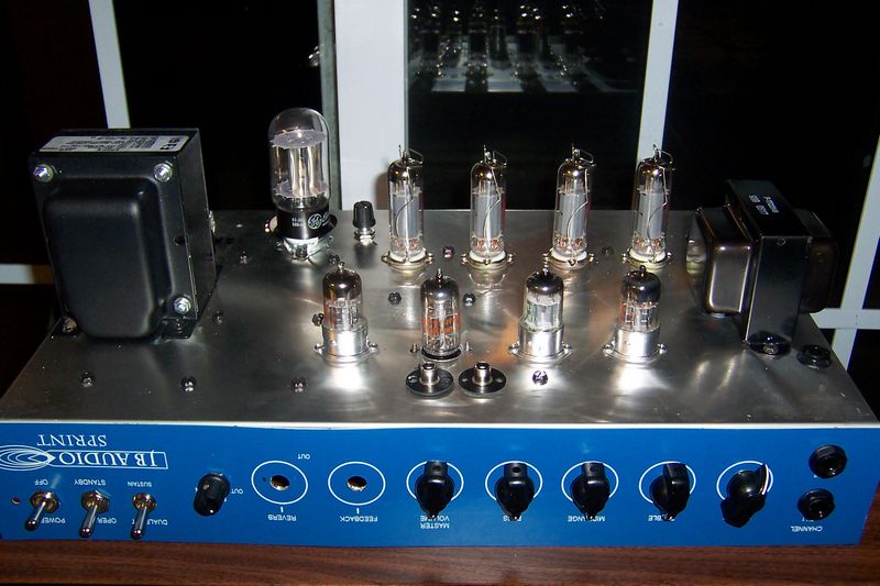

I prefer a modest power transformer that has some voltage sag on peaks for a bit of compression. Thus, agree with reply above. The opposite is true when I design home entertainment amps.
My daughters project below should be finished tomorrow. It uses four EL84 & a modest Hammond 370FX for about 35-40 watts out.
Where do you get the really nice front panel labels in your photo???
That one is nice!
Trout
Front panels.......
They are made on a laser engraving machine.
I should add, the small transformer feeds a small 10uF Solen input filter cap for lower peak to average current demands on the power transformer. Then, that feeds a LC to the EL84 plates thru the audio xfmr. Back to the 10uF input cap, that also feeds another LC to the EL84 screens & reverb driver, then to two RC sections to the other tubes. No electrolytics in the B+, all are Solen caps.
Top that off with NOS Raytheon 5751 windmill getter black plates, 5751 Sylvanias & an RCA 12AT7 reverb driver. The amps sounds excellent- musical. Cab is pine with a birch ply front speaker panel.
