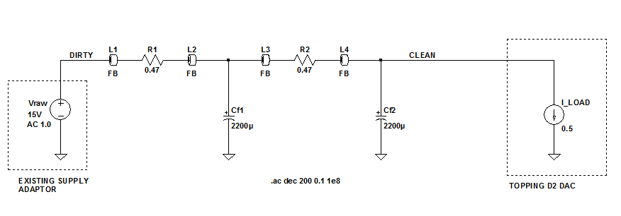

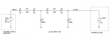

Maybe you could try a passive filter between the adaptor and the DAC? Perhaps resistors, capacitors, and ferrite beads can filter out much of the switching noise.
