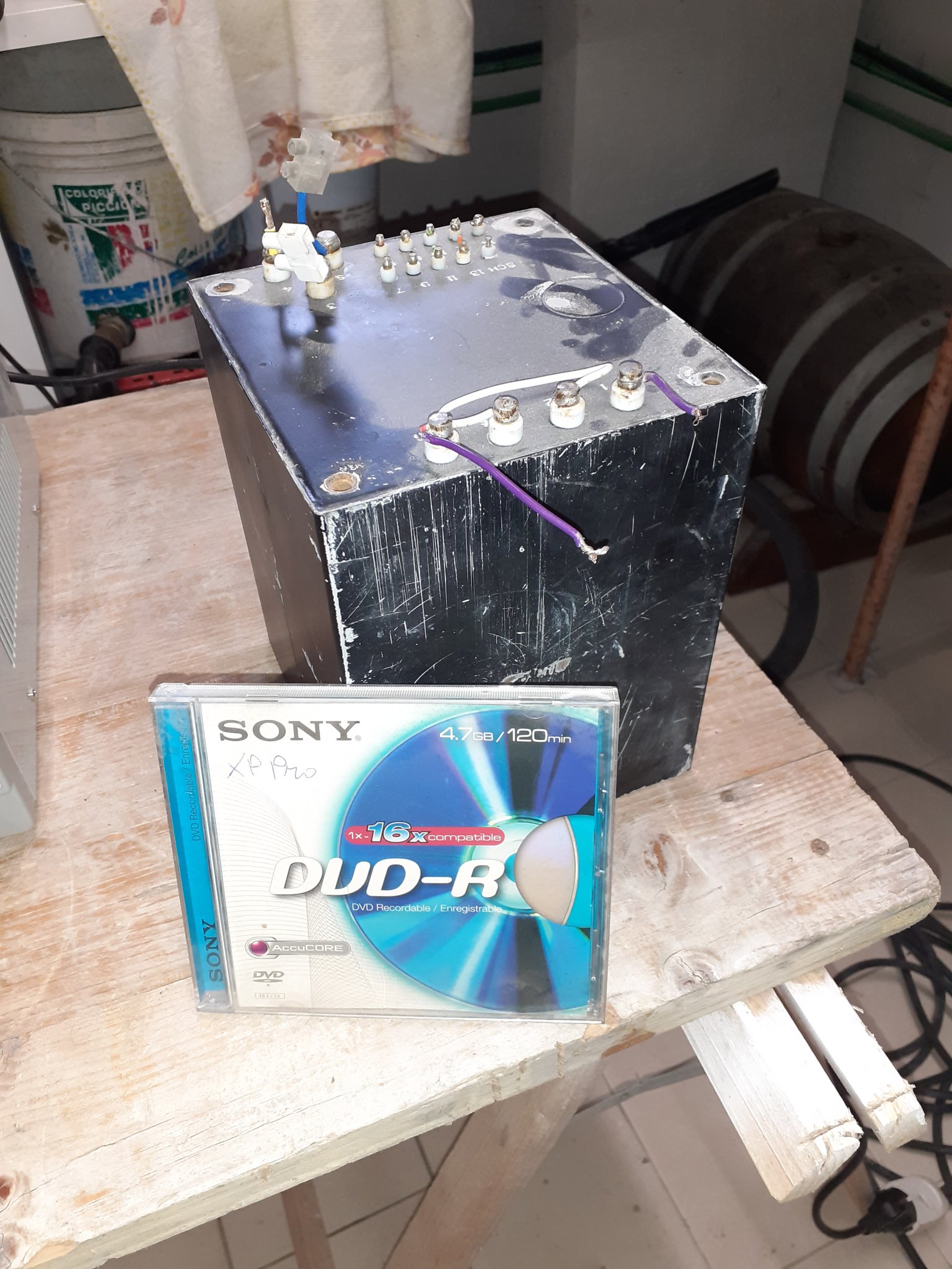

Hello everyone! I need some advice, I own a 1200va transformer with 45-0-45 outputs and I would like to use it to "son of zen" with about 20v per rail. I was thinking of a stabilized power supply. Is it a viable road? Thanks to everyone who will help me!

No, not unless you can turn it into a 22.5-0-22.5 transformer by re-connecting the primaries. Show a pic of your transformer for more inspiration.
Often transformers have two primaries which are normally connected in parallel, but instead if connected in series result in a half-VA transformer of half voltage (22.5-0-22.5V in your case). And that would rectify to about +/-29VDC bipolar rails, so you could make almost any typical Pass DIY amp (and not one like SoZ which needs a single rail).

Oops that was incorrect, as SoZ also uses a bipolar supply.(and not one like SoZ which needs a single rail)
Poke around on that transformer you have, as it appears terminals 2 and 3 are already connected in series...?
