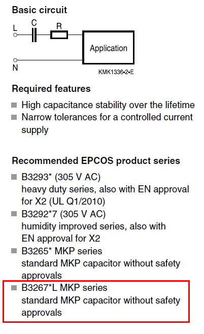

In my opinion it might be worth looking into this EPCOS film capacitor: part number B32674D6105K. Its characteristics are
  • 1.0uF
  • 350VAC
  • 27.5mm lead spacing
  • 19mm case height
  • 5.0 amps ripple current rating @ 70C
EPCOS provides an application note .pdf file (attached below) which includes the following image; please notice that B3267 capacitors are specifically recommended for in-series-with-the-powerline applications:

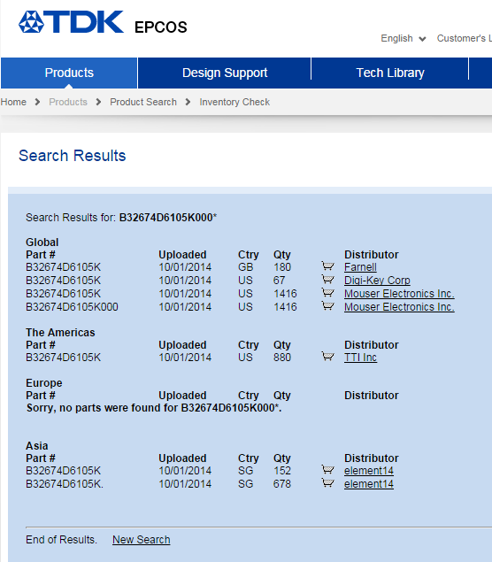

This capacitor is in current production and available from distributors worldwide; see attached image from EPCOS's website. (Here is its sales page at UK Farnell)
