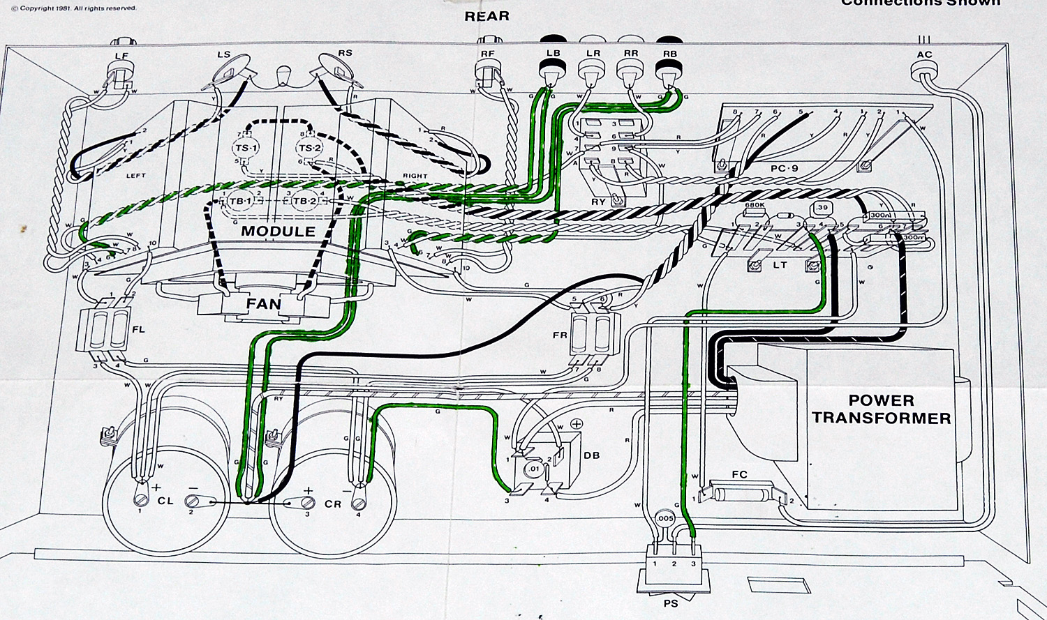

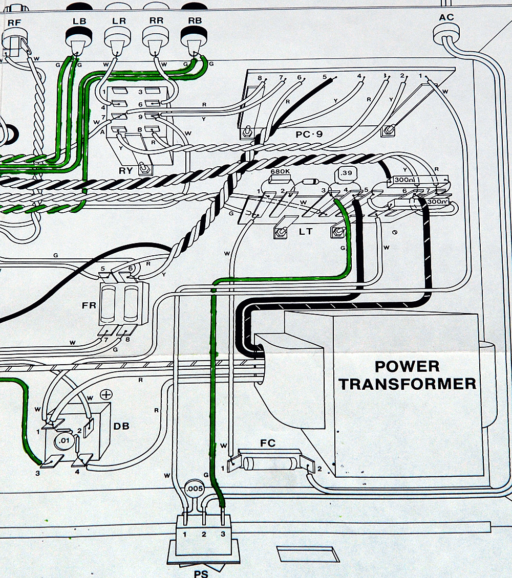

Hi. I just finished building this board, but I'm a little confused as to how to attach this to my amplifier. I have a new power supply in my Hafler DH-500 with 2 separate supplies each with a 64 volt 500 VA transformer and 80K uF for 160K uF total. I basically installed the Musical Concepts PA-4 boards & dual mono power supply upgrade. Everything is in the same case so AC is shared. The live AC wire goes to the center pin of the switch. As you'll see in the attached photos
, the switch is SPDT and creates 2 separate live wires that are turned on at switching at pins 1 & 3 of the switch. Both switched wires go through a terminal strip. The neutral is connected directly to the terminal strip (fuse shown is eliminated as it's part of the IEC, so neutral is a straight run to the terminal strip). Fuse & switch are now both on the live wire. So I believe I would attach the mains neutral AC wire to the neutral tab on the board. Then, it looks like mains AC live to Live/Sw 1 on the board. Live /SW 1 also to the center pin of the switch. Here's where I get a bit confused. Would both live switched pins connect to the SW2? Then would one Xformer tab (XFR1} on the board connect to the terminal strip where the neutral connected and would I run 2 separate wires off the other transformer tab (XFR2) to the 2 points on the terminal strip for the hot wires that were both originally switched through both sides of the switch? Then from the terminal strip to both transformers as it is now (unchanged)? Appreciate any help you could offer. I want to be sure to wire this in correctly before powering anything on Thanks
OOPS!! The photos don't appear to be in the post, just X's that spin if clicked on. I'm not sure what I did wrong. But they are both in a gallery that I created called Wiring DIY Audio Soft Start. Thanks.
I just checked the switch with a meter and realized that only the 2 switch terminals with the cap across them are switched (1 & 2). So terminal 3 doesn't appear to switch on. The amp works perfectly as wired now, so that wiring is correct. Terminal 3 is not switched on, so I'm not sure what function it's connection serves, maybe as a ground wire back to the terminal strip. So would I just leave that terminal 3 on the switch connected as is to the terminal strip, and just connect pin 1 of the switch to tab SW2 on the soft start board?
