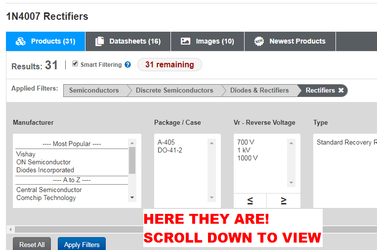

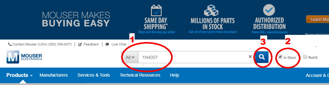

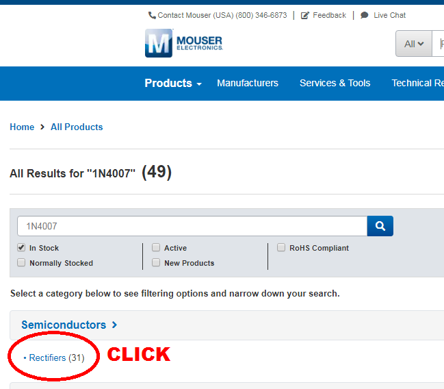

Hi friends
I was collecting the parts for the softitart/speaker-protection.
Some parts seem to be "end-of-lifed". Both the speaker-delay and the soft-start's BOM are concerned. I threw both in here out of laziness, pardon...
It's (softstart):
D1, D2, D3, D4 1N4007 Rectifier 1000Vr 1A 512-1N4007
and (speaker delay):
K1, K2 Relay Relay SPDT 5VDC 72mA 653-G5LA-14-CF-DC5
K1, K2 Relay Relay SPDT 12VDC 30mA 653-G5LA-14-CF-DC12
What can I substitute them with?
Thank you!
david

Thank you Mark.
It is a bit embarrassing having the solution right there...
Now there's just the relays left, not sure on those (mouser's proposed alternative seems to have a different size) 😕
will look further soon.
