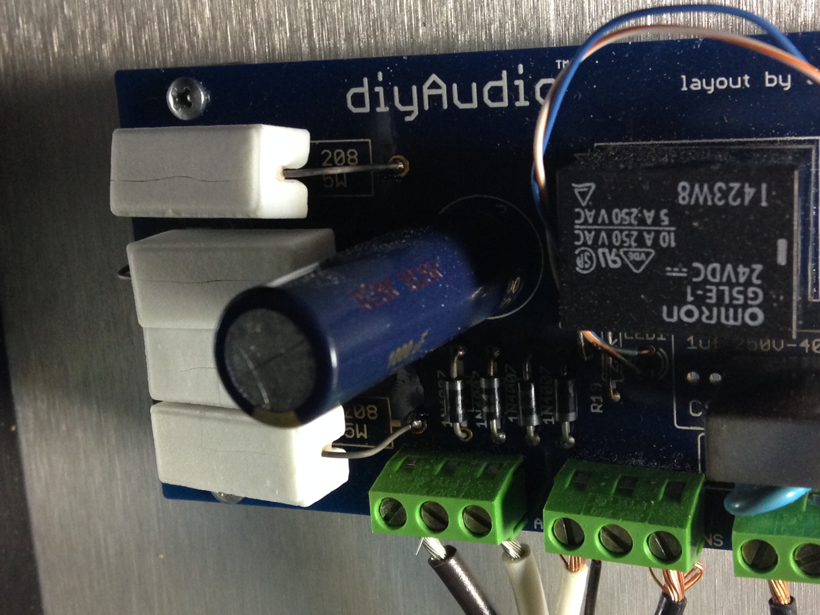

AndrewT & Co.:
The ice storm has passed and I've returned from a two week business trip. As noted in another thread (see #2988 in http://www.diyaudio.com/forums/pass-labs/207103-f5-turbo-builders-thread-150.html), I set this amp aside and tried dialing-in a second F5T V2 stereo amp with similar (smelly) results. 6L6 and others have suggested that I verify that the leads extending below the softstart boards are trimmed. I will do so (thought they weren't bad before), and also add to the height of the standoffs to ensure the boards aren't arcing to the chassis, but does this seem like a likely fix? Both of the failed softstart boards worked properly for several hours before the power resistors blew up. I will also offset the power resistors from each other to allow for better cooling on the four long sides, but these minor tweaks seem like an uneducated patch. If you have any further thoughts, I'd be grateful for the advice.
Here's a photo of the second blown softstart board. The photo doesn't do the power resistors justice: there's a crack running the length of each one and nice brown toasting at the ends.
Scott

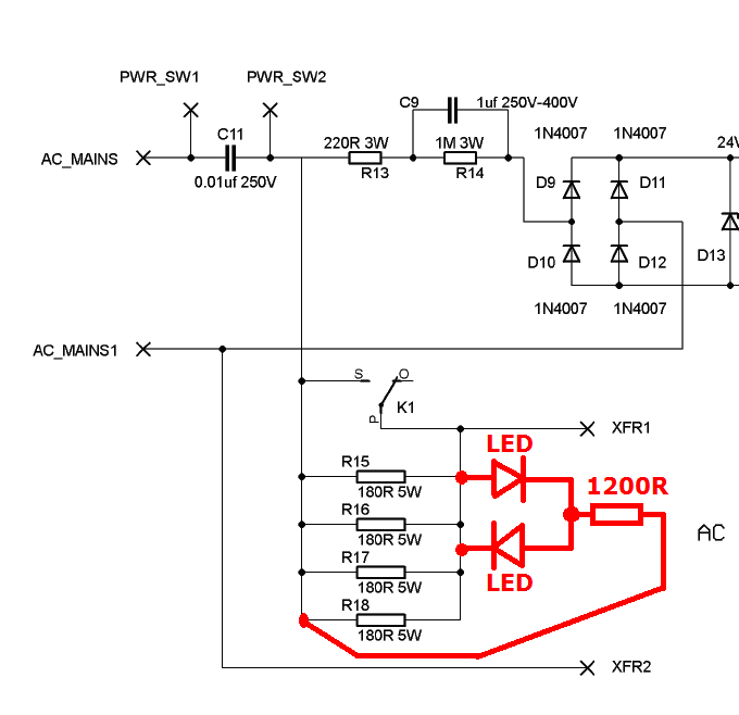

Maybe there is a mismatch between {the PCB layout} and {the relay you purchased}. Maybe your board does not start-soft-then-run-hard. Maybe your board accidentally implements start-hard-then-run-soft. One way to quickly check this with full skepticism, is diagrammed below.
You tack-solder three small components in point-to-point air wiring style, across the top of one of the power resistors. The LEDs light up whenever Softness is engaged. The LEDs go dark whenever HardOperation occurs.
Putting it another way: Whenever destructive power is applied to the 5W resistors, the LEDs light up. So you can carefully watch to see when the resistors are in danger, and when they are not. Remaining skeptical the whole time.
Expected behavior of a good board: When you flip the power switch on, the LEDs glow for just 0.2 seconds, then they extinguish and never illuminate again.
Behavior of a faulty board: When you flip the power switch on, the LEDs glow continuously and never extinguish. (Destructive power is continuously applied to the 5W resistors).
Using two LEDs back-to-back allows them to operate from AC rather than DC. Each diode protects the other from excess reverse voltage.
Edit: the 1200 ohm resistor needs to be rated for 1 watt. Shoulda mentioned that earlier.

Scott, I made an error in calculating the value of the LED current-limiting resistor in post # 132. I didn't plan for the ugliest worst-case.
Clearly there is enough voltage across each 180 ohm, 5W resistor, to burn them out. Let's make a conservative overestimate of voltage, and then size the LED current-limit resistor to survive even in this worst case scenario.
Assume the voltage across each 180 ohm, 5W resistor so large, that each resistor is being asked to dissipate 25 watts instead of 5 watts (making them go kaboom!). This turns out to be 67 volts across each resistor { math: (67^2 / 180) = 25 watts }
The LED + current limiter sees this same voltage, 67 volts. If we choose LED current to be 8 mA in this case, its current limit resistor value should be (67 / 0.008) = 8400 ohms. The power dissipated in this resistor is (67 * 0.008) = 0.55 watts. So we need an 8.2Kohm, 2W resistor in series with the LEDs.
