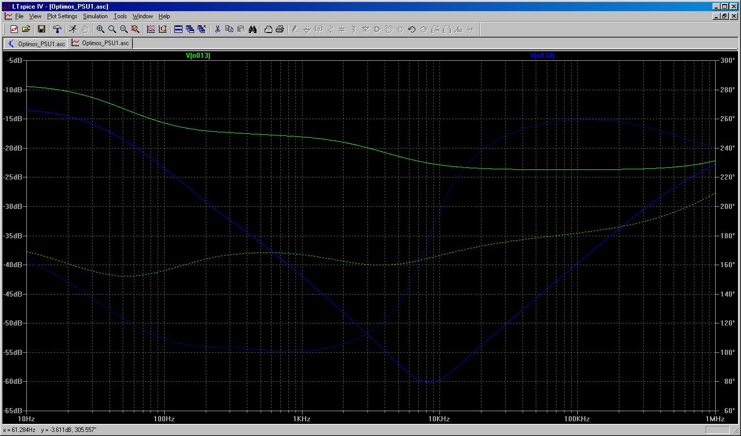

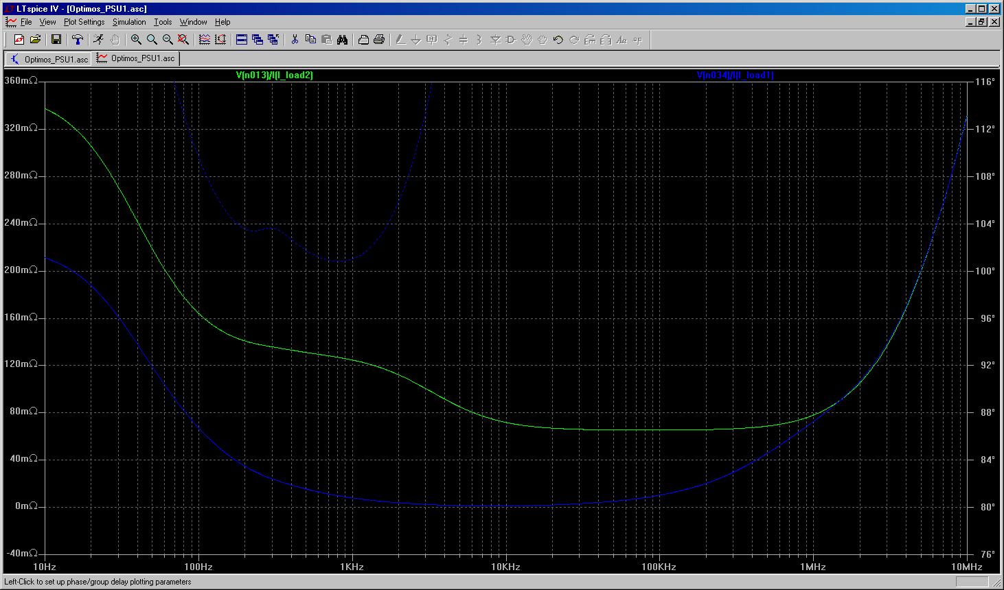

Here are some graphs to illustrate.

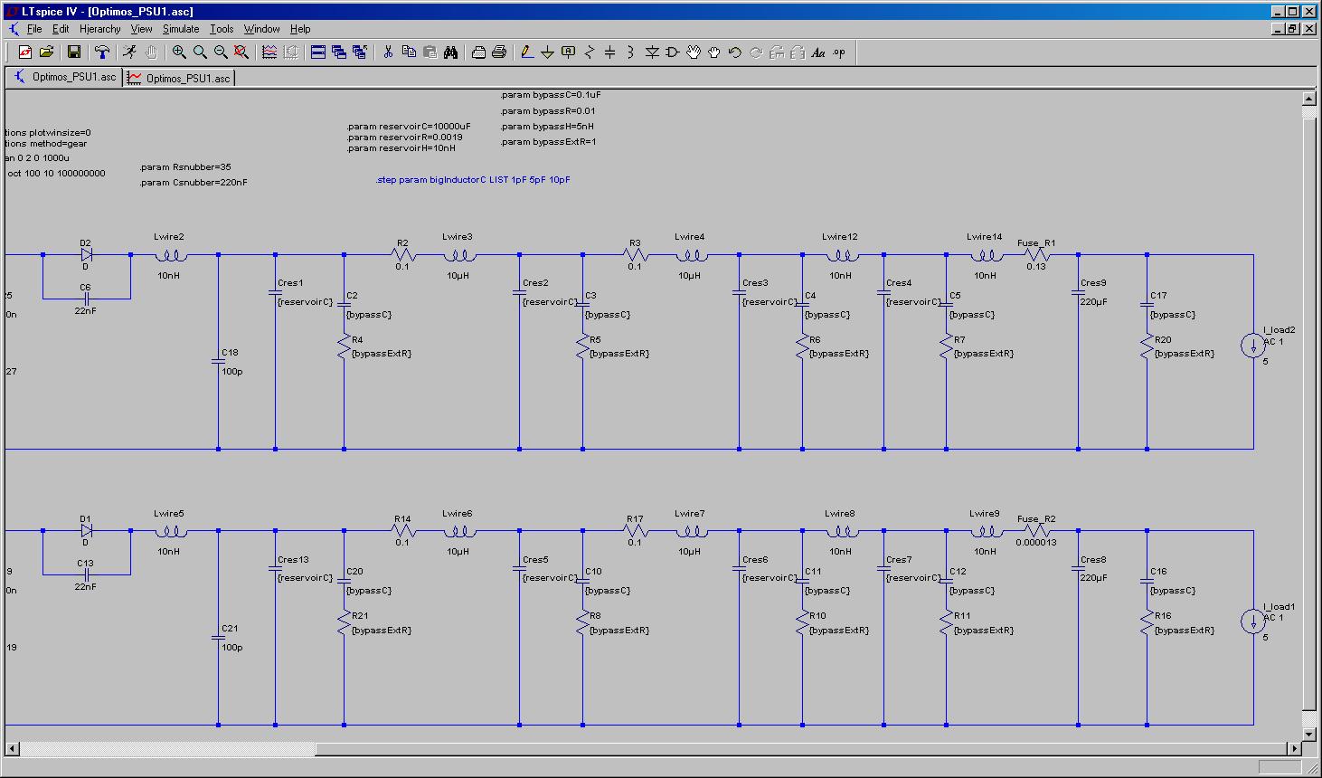

Suppose we have a power amplifier supply using CLRCLRC of 10000uF + 10uH + 0.1R + 10000uF + 10uH + 0.1R + 20000uF + (local) 220uF.
The graphs are as shown. The rising impedance above 10kHz is due to the wire inductance.
The only difference between the two circuits is that one assumes 130mR fuse resistance and the other one is basically 0R.
The green graph is the one with 130mR fuse resistance and the blue graph is without the fuse. See the very big differences.

Put the fuse way farther upstream. It should never be placed there, in a real system.
By the way, wires 3, 4, 6, and 7 have 10 uH instead of 10 nH.
Get a good milliOhmmeter (HP 4328A for example) and start measuring real world parts. 100 milliOhms for a source Z above 10 KHz will prove to be quite difficult to get even a few inches from the caps. Jneutron has posted some pictures of the kinds of hoops you must jump through to get low Z at high frequencies.
If your amplifier is sensitive to a power supply source Z of 100 milliOhms you might hear a major improvement in it if you figure out why and address it.
The 10uH is by design. It makes basically no difference in impedance seen at the power device pins because the low impedance is provided by the last stage two large reservoir capacitors, however, with the two small chokes it will result in substantially improved high frequency PSSR of the power supply.
See the PSSR graph attached.
