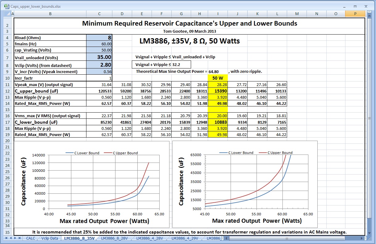

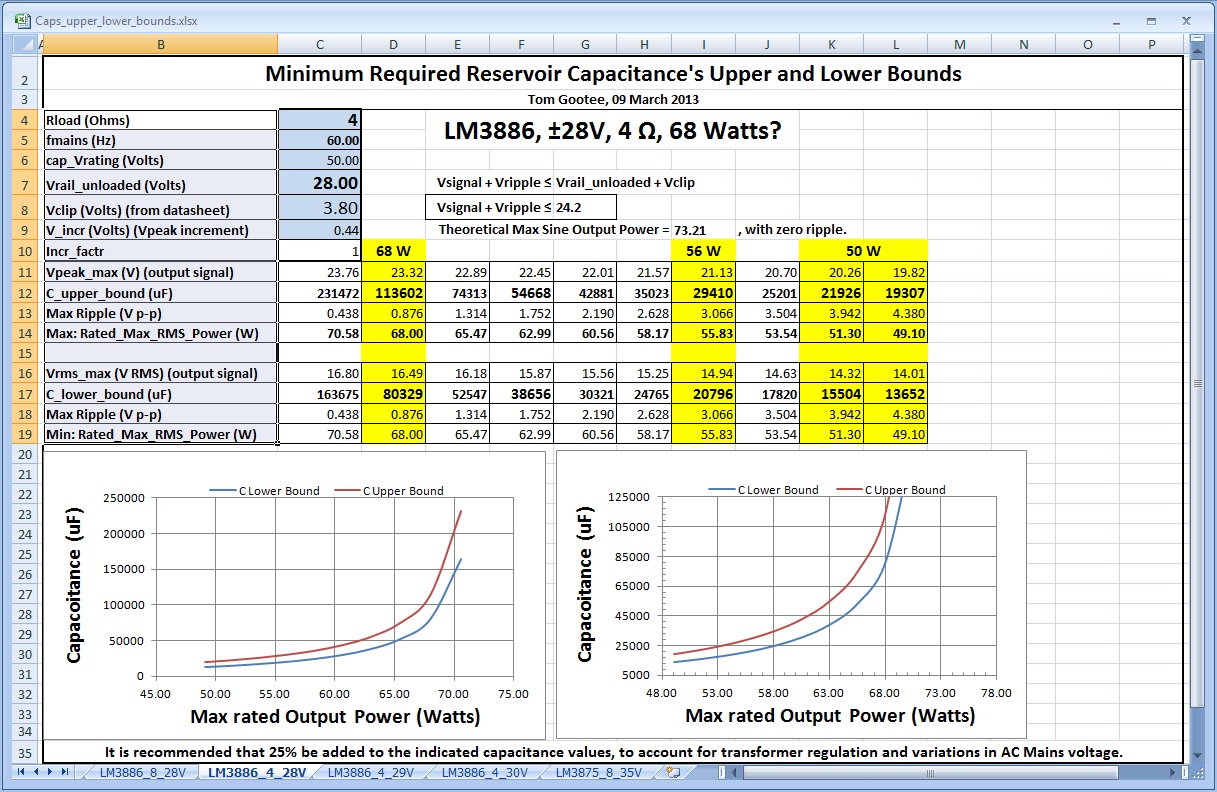

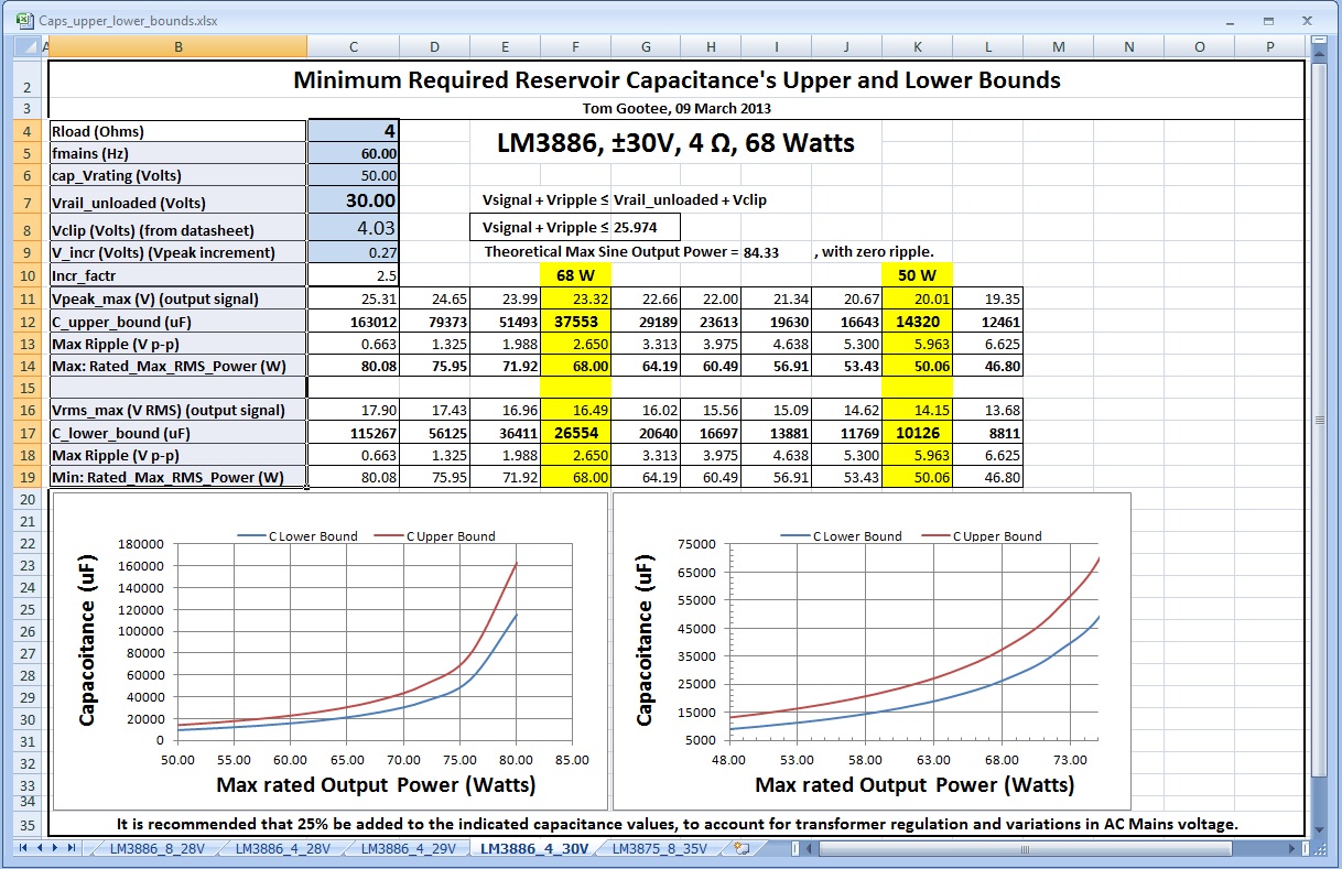

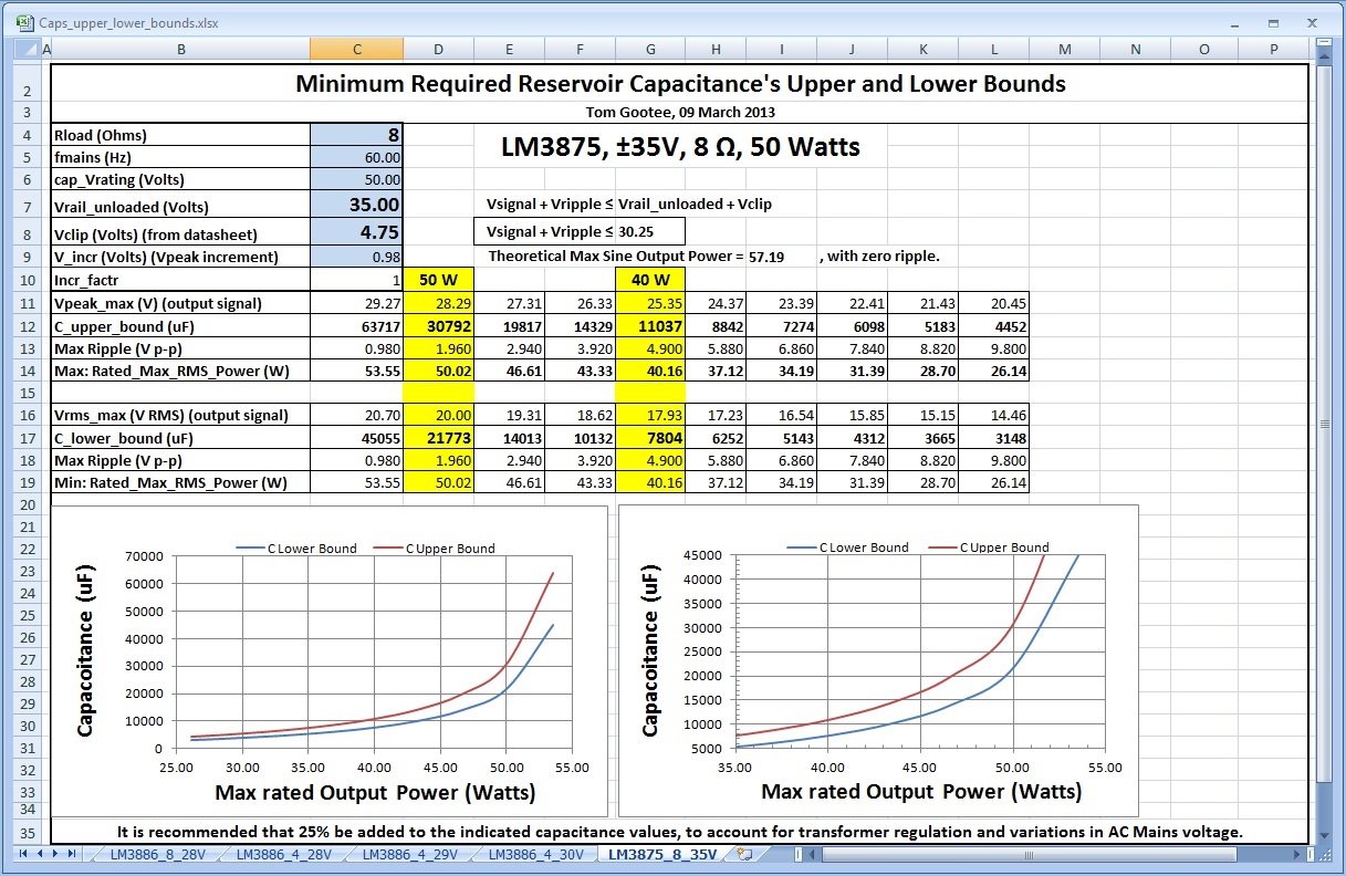

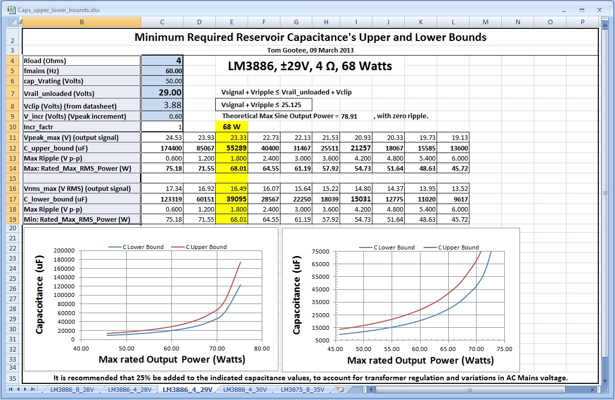

Reservoir Capacitance Upper/Lower Bounds Spreadsheet

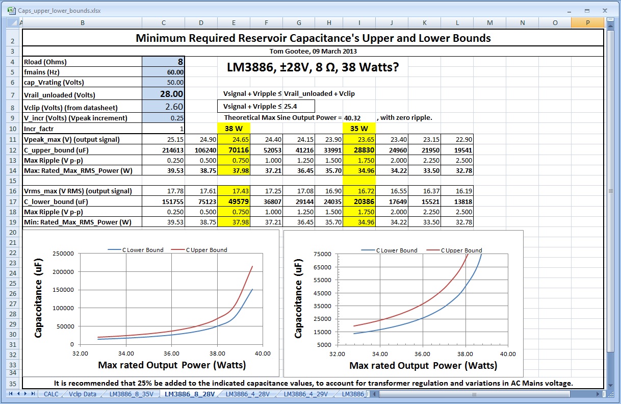

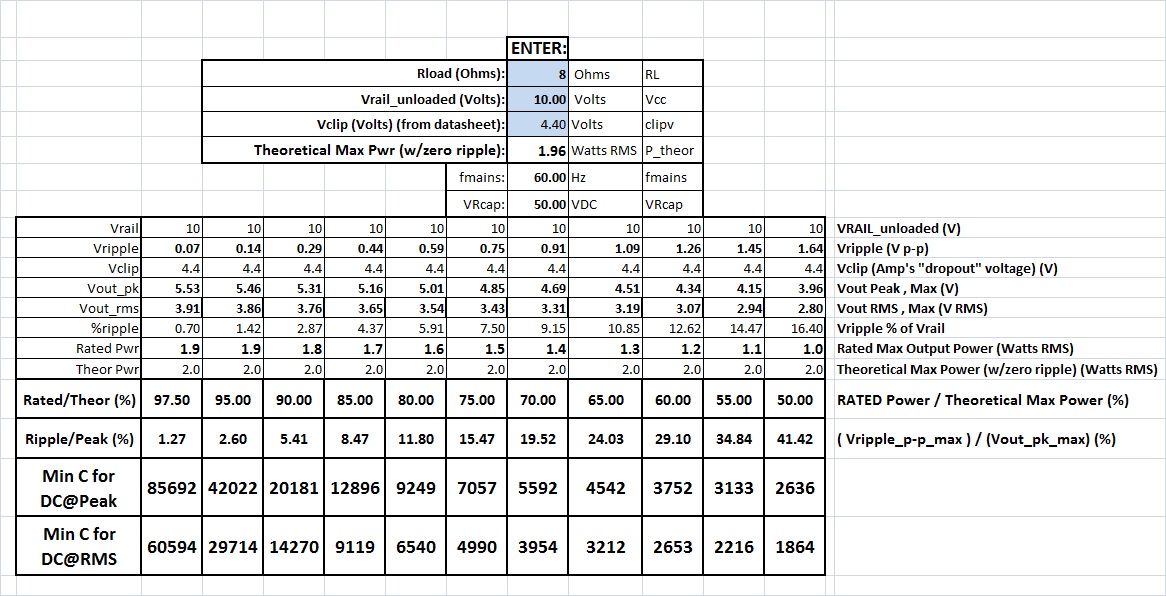

Attached is a spreadsheet that implements some equations for calculating the upper and lower bounds of the minimum required reservoir capacitance, for a power amplifier.
It only implement the equations that use an approximate value for the caps' ESRs, based on the capacitance and the voltage rating.
The spreadsheet uses equations (5a) and (6a), from the derivation at http://www.diyaudio.com/forums/chip-amps/230787-lm3875-gainclone-too-much-treble-3.html#post3403946 .
Also attached are some screen images, for some chipamp cases that I looked at, with the spreadsheet.
(Excel's plotting is not very good, especially when the scaling is not being automated with Visual Basic. So users of the spreadsheet will probably have to know how to click on the axis labels of a plot, then right click and seldct "Format Axis", and change the minimum and maximum axis limits, if necessary.)
Spreadsheet users, please edit the vertical plot label and change "Capacoitance" to "Capacitance".
Tom

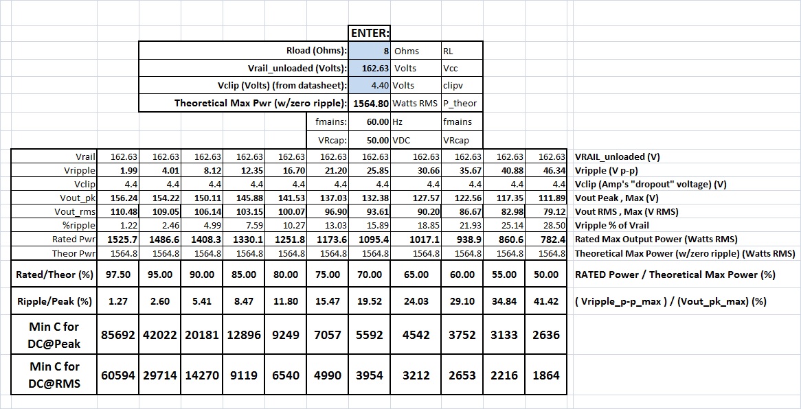

ALL,
Someone tell me if I've gone mad (AFTER reading this, please 🙂 ) This seems too good to be true. It seems like I have found the Holy Grail for reservoir capacitor calculations.

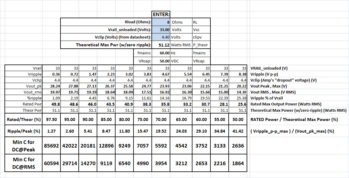

I stumbled upon "an invariance", while playing with the last spreadsheet I posted... (LOOK at the attached thumbnails! Notice the wide variation in the output power ratings (et al), and NO variations in the required capacitances (or certain ratios)!)
(By the way, the C values are 2X what they should be, in that spreadsheet. I will attach a new one, below.)
I happened to set up a series of calculations (of the minimum capacitance to prevent clipping) that were based on the max rated RMS sine output power DIVIDED BY the theoretical maximum RMS sine output power.
For the theoretical maximum output power, I just assumed that the ripple could be zero which meant that I used a peak output voltage of Vrail_unloaded - Vclip, instead of Vrail_unloaded - Vclip - Vripple, to calculate the "theoretical" max output voltage peak level and the RMS power.
Then I set up Excel to calculate the ripple and Vpeak values needed, to set up a row of cases, for which I would have it calculate the minimum capacitances. i.e. I set up columns for fixed-percentage cases of "rated max power divided by theoretical max power", e.g. 97.5%, 95%, 90%, 80%, ..., 50%, so I could see how fast the capacitance went up as the voltage space for the ripple was squeezed toward zero.
So I did all of that. The inputs were the usual things, like load R, Rail voltage, vclip, fmains, and the capacitor's voltage rating (since I was using the "ESR approximation" version of the equations, which, by the way, I got right when re-capping earlier work at http://www.diyaudio.com/forums/chip-amps/152471-finalizing-tda2050-lm3886-2.html#post3363511 but somehow got wrong while finally figuring out how to eliminate all but one variable, at http://www.diyaudio.com/forums/chip-amps/230787-lm3875-gainclone-too-much-treble-3.html#post3403946 ).
Anyway, I noticed that when I changed the rail voltage, none of the calculated capacitance values changed! NOTHING I CHANGED changed the capacitance values, except the load resistance. And that changed them only by the expected scale factor!
For any amplifier from 2 Watts to over 1500 Watts (and more, I'm sure), if you want, for example, the maximum p-p ripple voltage to be 7.59% of the peak output voltage, then the minimum capacitance required to prevent clipping, if your output is the worst-case DC at the peak level, is always the same (> 12896 uF). And for the same thing, except to prevent clipping for a DC output at the rated max RMS level instead of the peak level, then the capacitance required will always be the same, i.e. > 9119 uF (assuming, of course, that my calculations were correct).
(There WILL be a slight change, of course, if the capacitor ESR changes. For the examples, I left it the same, just to make the point. But obviously, for 163V rails you wouldn't use 50V caps. But putting in 200V caps didn't change it all that much. And that's not the point, anyway, but I figured I needed to pre-emptively explain that, for the nitpickers who might also miss the main point. Please don't post about that.)
So that got me really excited.
I finally plotted the row of capacitances versus the row of Vripple/Vpeak values. And THEN I let Excel do a curve fit. Sure enough, it found a perfect fit:
y = 109167 / x
I was using, for x, 100 * Vripple_p-p / Vout_pk (assuming rated max output). And y was the calculated minimum capacitance to prevent clipping (for DC output at Vout_pk, which is my chosen worst case).
That gives:
C_min(pk) = 1091.67 * Vout_pk / Vripple_p-p (my "upper bound" minimum)
for the "DC load at max rated peak" method.
For the "Dc load at max rated RMS" method, I got:
C_min(rms) = 771.92 * Vout_pk / Vripple_p-p (my "lower bound" minimum)
The spreadsheet will follow.
Tom

Spreadsheet for Calculating Reservoir Capacitance, et al
Attached is the spreadsheet mentioned in my previous post.
(P.S. I meant to quote 8.47% instead of 7.59%, in my last post.)
Now I guess I need to derive the expressions for the coefficients that the curve-fitter came up with. <grin>

What you've found is that C = QV; for ripple to vary with rail voltage it would have to be something other than a linear relation. 😉 That's why this link from the previous page makes no mention of the supply level (other than the tacit assumption that one's designing the rails to Vnominal = Vmin + Vripple so that special casing to handle Vripple > Vnominal or the amp shutting down below Vmin isn't needed).Someone tell me if I've gone mad (AFTER reading this, please 🙂 ) This seems too good to be true. It seems like I have found the Holy Grail for reservoir capacitor calculations.
If you do a more exensive analysis which accounts for additional factors there is a weak relation between ripple and supply, mainly with regards to the transformer's regulation interacting with the bridge's conduction angle. It's not usually worth worrying about as it's swamped by mains variability and easily mitigated by appropriate trafo choice.
Ah! Makes sense. And if I take i = C dv/dt, i.e. C = i / ( 2 f vripple) plus the second curve-fitted equation above, C = 772 Vout_pk / vripple, so i /2f = 772 Vpk, and Vpk/sqrt(2) = i Rload, I can probably get close to the correct number for Rload.
