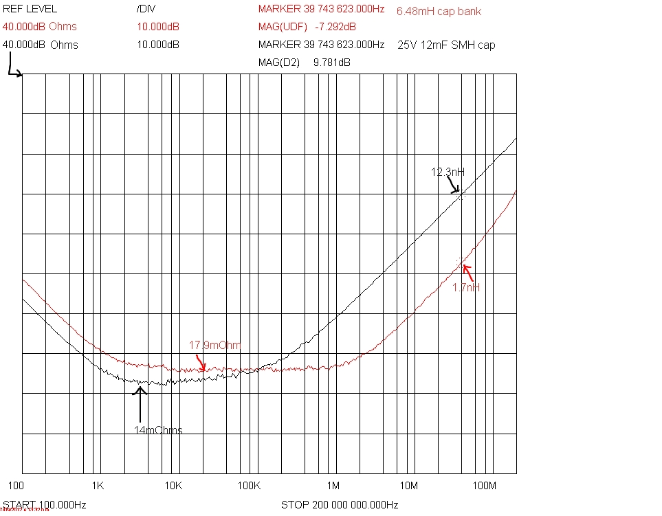

Still thinking about the caps needed for the 10x10 (or so) array.
Maybe terminology is getting mixed up or maybe I am under some misconception. The self-resonant frequency is usually a GOOD place to be. It's where the minimum impedance is. It's the frequency at which a cap can most-quickly supply the most current.
Basically, we want a very low impedance, everywhere, if possible. But if there's a band of lowest impedance, it seems like we would want that band to lie across the audio band, and at least across the bass portion of the audio band, if we couldn't have it all.
Attached is a plot of the impedance of Terry Given's 10x10 array of 1000 uF caps, on a 1.6mm-thick (instead of the desired 1mm, or less) PCB. The plot came from his HP 3577A analyzer (capable of 5 Hz to 200 MHz).
I would have thought that the cap array's impedance would be much lower than it is, at the lower frequencies. The 12.5 mF cap he compared it to looks lower, there. However, the 12.5mF cap doesn't include any connection wiring, whereas the cap array includes all of that already.
At any rate, the array's flat, lowest-impedance region appears to extend from somewhere between 2 and 5 kHz up to about 1 Mhz. (It does very well at the high frequencies.)
I think that, ideally, the lowest-impedance band should extend another two octaves lower, so that it includes down to somewhere in the 20-50 Hz region at its lowest-impedance level.
Would that mean using larger cap values or more total capacitance? Would it help to put caps on both sides of the pcb, to decrease the total PCB path length? (I realize that just getting 1/wC down to 0.02 at 20 Hz would require about 400000 uF. Is that what we would need?)
Then we see what Klaus got, here:
http://www.diyaudio.com/forums/powe...work-analyser-measurements-4.html#post3331935
Now I am scratching my head.
Suggestions?
Ah, brings back memories ... how many times have I stared at curves like this ...Basically, we want a very low impedance, everywhere, if possible. But if there's a band of lowest impedance, it seems like we would want that band to lie across the audio band, and at least across the bass portion of the audio band, if we couldn't have it all.
Easiest way of getting that nice, low impedance in the audio band is to use regulation, otherwise, bigger, meatier and rough and ready electro's will be needed. The latter can be as low quality as you like, what you want is capacity, capacity, capacity, the most you can get for your money. I would aim for better than 1 m.ohm over the whole audio band, and try to maintain that up to 100-200khz. This is where you use your best quality electro's, heavily paralleled, short paths to the point needed. Once past that frequency, heading towards the MHz it starts becoming a real struggle, absolutely everything has to be just right, otherwise you're just wasting your money. You worry about millimetres of conductor, fight to reduce every nH ... and it may not actually be worth it ...
Frank
