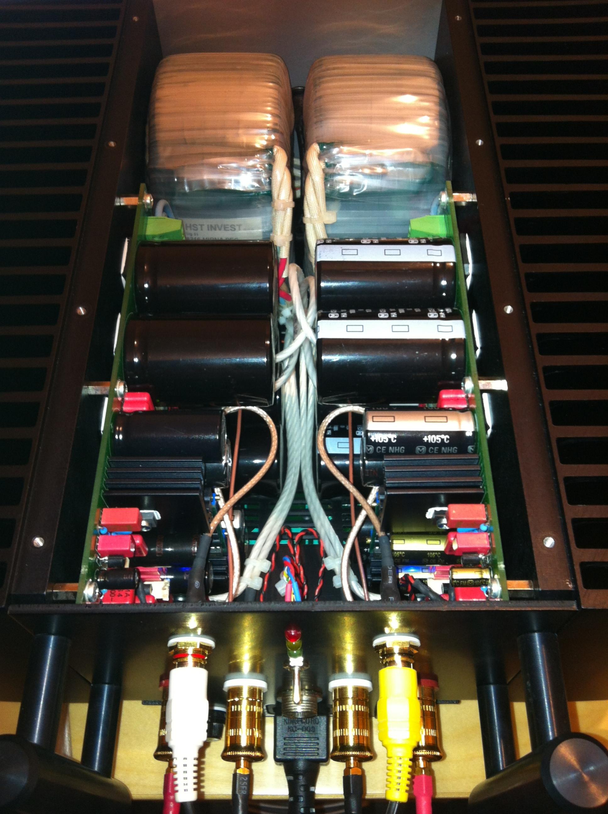

Just before you go, one last statement from me. You all guys concentrated on caps values as this is the most important issue, wrong. PSU comes together with all the details and if you want to get the most from it, sound wise, than each and every detail has to be correct. Of course we can exaggerate to insane values but that for me is not proper design at all.
Let me just remind you again to the most important steps regarding power amplifier linear PSU design:
- VA rating of mains transformer is calculated from RMS current needed to supply 4 ohm speaker, than multiply this current with AC voltage needed and you will get VA value. Shortly 4 times Wrms results in proper VA rating and this is the first and the most important step at amp PSU design!

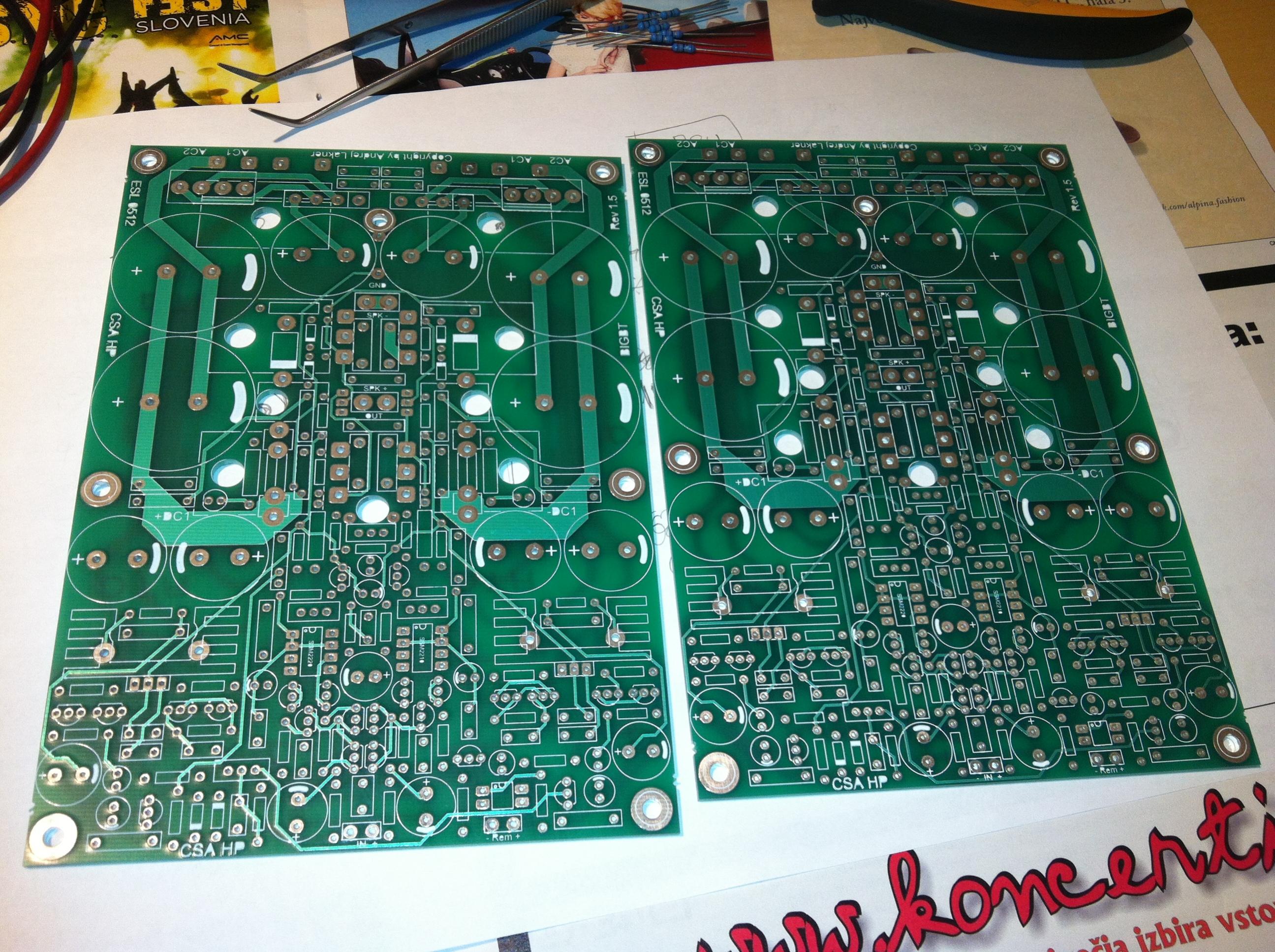

- one full wave rectifier on PCB for each rail, so four together for all the rails (two front-end, two output) in one power amp's channel
- on PCB two star grounds (one front-end PSU GND, other output stage PSU GND) connected together with 5-10 mm track, prevents interference between high/low currents in each GND
- 2200 uF/A per single rail is optimum (that 6 words are enough as we speak about caps !!!)
- quality of the electrolytic caps is a must (producer, 105 °C min)
- complete PSU (except mains transformer) located on PCB, resulting in shortest possible connections and the most quality ones - PCB copper 130 um thick
- extra decoupling with 0,1 to 1 uF at tracks splitting and track endings
- direct decoupling between + and - rails with 0,1 uF/250 V
These are practical rules if you want to get the most of sound quality from any amp. 😉
The first line contradicts with the second one.
(provided the factor 4 does not refer to a stereo power supply)
... VA per channel 😉

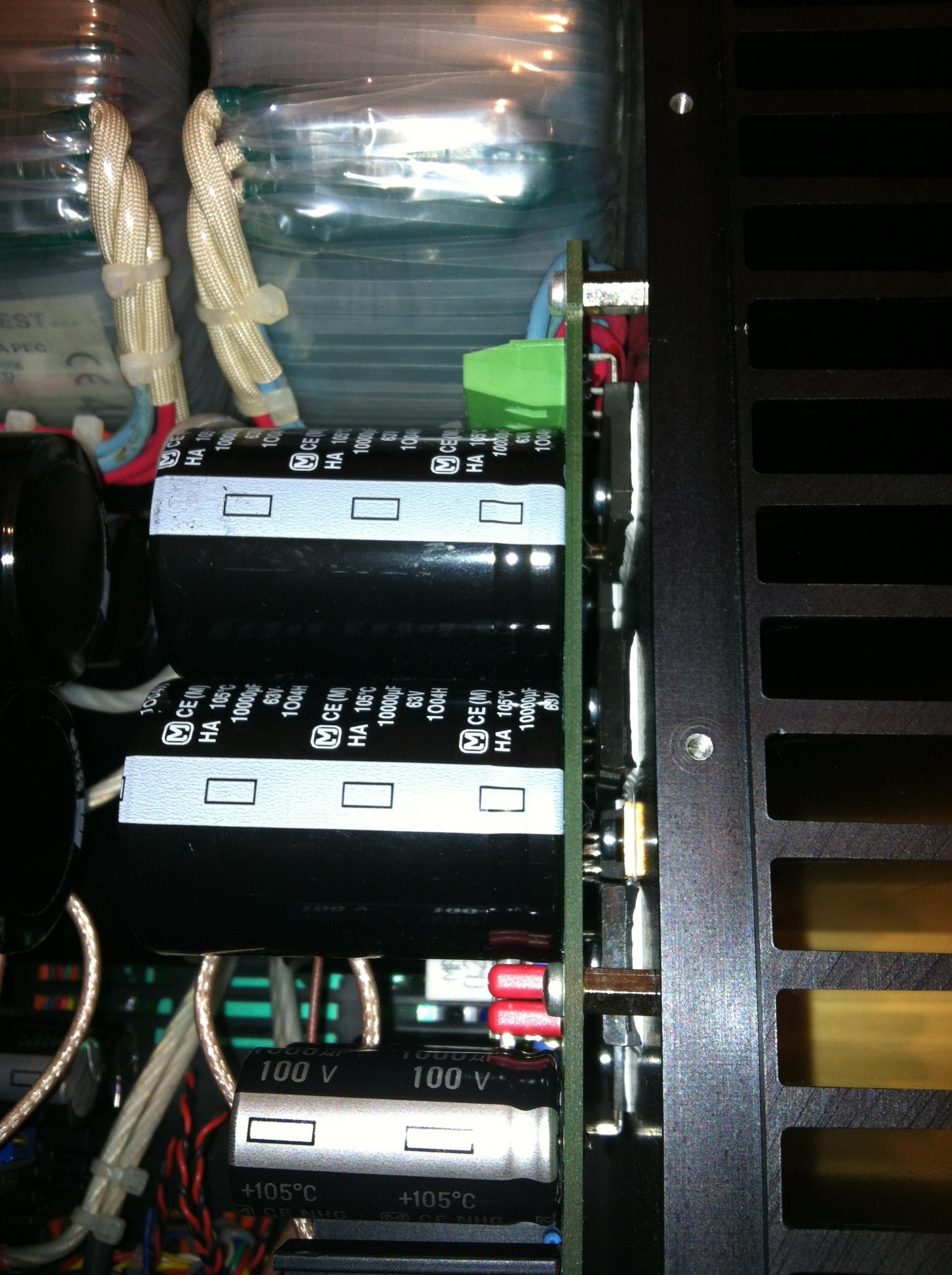

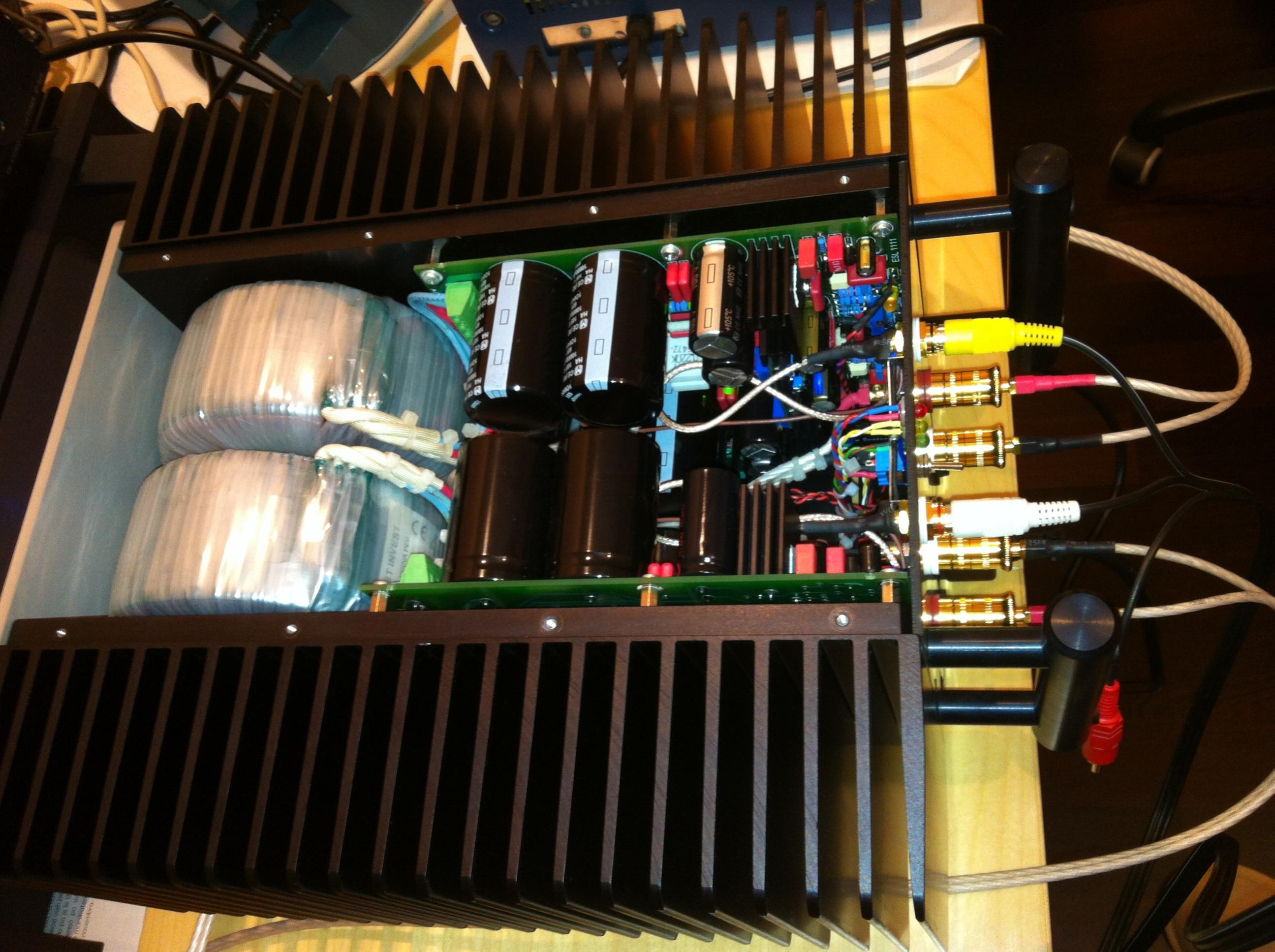

Current capability we need: big, high current, low Zsec transformers !!! 😎
We need caps just for smoothing, setting the ripple to a certain, acceptable level, not to cause 100/120 Hz hum.
The current comes from transformer, not from the caps. Transformer is the most important component of the PSU.
Look to third picture in post #185 and you can see the volume of transformers compared to everything else in a metal case.
The story goes like this:
- SSA/CSA has 62 VDC rail on output and can deliver unclipped amplitude cca. 50 Vp (100 Vpp)/4 ohm
- 50 Vp/4 ohm means 12,5 Ap rail current and converting this to effective current, that is 8,84 Aeff
- 62 VDC comes from secondary power winding of 45 VAC, considering 1,2 V drop on rectifier diodes
- so having 45 VAC muliplied by 8,84 Aeff we get 397,8 VA ie. 400 VA
- each secondary power winding has capability of this current level, because at the same moment only one power winding (among two of them) supplies current. In practice that means we have two 400 VA separate secondary windings on the same 400 VA core transformer
Hopefully I was clear in an explanation of VA rating, from where we get current capability needed to supply our speakers - mains transformer 😉

So 100W/8 dictates a 400VA ?
(love the dual heatsink mounted GBJ type bridge rectifiers )
Yes, 400 VA toroidal transformer per channel, as seen on upper pics. 😉

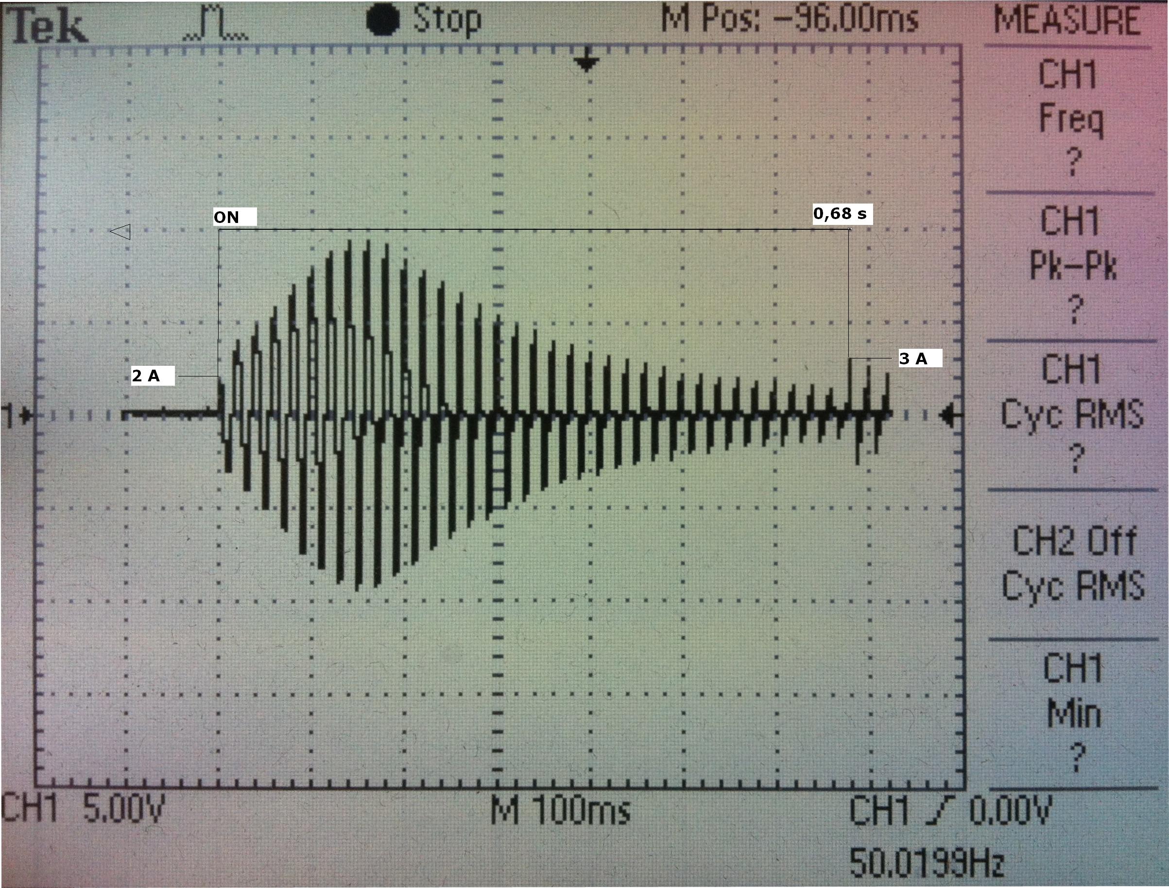

Turning on softly 800 VA and 90000 uF (both dual mono channels together) is served by soft start & utility circuit, located below the amp as showed on pic. Inrush AC mains current showed on graph. 😉
