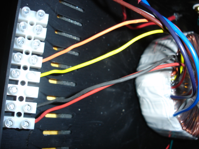

I insert each transformer wire into separate terminals of an insulated terminal strip. No accidental shorts.
Measure which of these are on a single winding. Most will only have two wire with continuity. Some may have three (a voltage tapping or centre tapped) or more (quite rare).
While doing this, measure the resistance of every winding. Multi-tapped can usually be worked out from the increasing resistance as you approach the last tapping.
Label your ends.
If you want you can re-arrange the wires into winding groups and move the primary to one end and the secondaries to the other end.

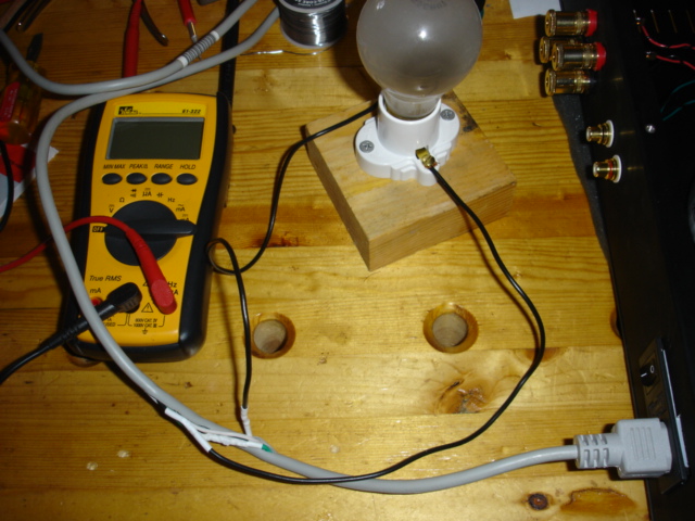

Insert your bulb tester into your mains socket outlet turn on the power. The bulb should not flash, it should not be dim it should appear completely OFF. But it is not OFF the bulb filament and it's connections are at mains Live voltage.
Switch off.
Now attach your mains cable Live and Neutral to the primary/ies with a plug top on the other end of that mains connection. You don't have a metal chassis at this stage so a third PE wire is not required.
Plug in your transformer to the bulb tester. Stand back and switch on.

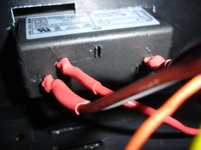

Okay, I powered up the amp with only the primaries connected to the power entry unit and the secondaries connected to a terminal strip and the test light did not turn on. I tested the circuit using a 60 watt bulb. Good so far. I checked voltages at the terminal strip and got 28.14 volts for both pairs of wires. The transformer is rated at 25V, why is it showing a higher voltage?
Anyway, what is the next step?
The 28.14 Volts is probably fine. You'll get a higher voltage unless the rated load is connected.

AndrewT how would I measure this using my MM?
Thanks.
Carefully!
Mistakes at AC line voltage can be deadly.
First with the unit/transformer unplugged from the wall. Remove the secondary circuit parts from the transformer. Find bare wire points in the input power circuit to place your MM probes. You may have to modify the insulation.
Plug in the unit/transformer, set your MM to AC volts (probably 200 Volts in the US), holding only the plastic part of the probes measure across those wire points.
Would I measure the input AC voltage from the back of the power entry module
I have the secondaries separated by a terminal strip
Testing the build with the bulb tester like this
Do I ground the black probe on the power entry module ground and use the red probe to test voltage on the (L) and (N) points?
those one or two exposed terminals on the sides of the bulb holder are at mains voltage.
If you drop a metallic tool on one of them expect sparks.
Even a careless elbow while concentrating on something else could kill.
But as they are they are (dangerous) test points.
One side is direct to mains supply the other side is feed to the equipment being tested. If the equipment being tested is OK and consuming a very low current then the difference in voltage across the test bulb will be <<10Vac and more likely <1Vac. But, remember that they are both at mains voltage one at 120/240Vac and the other at ~119/239Vac.
Protect/insulate those terminals.
