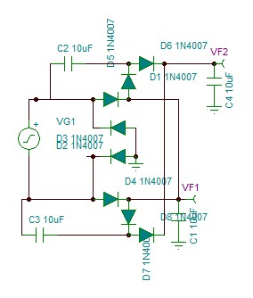

Would it be an issue to run a voltage doubler on a 170v power transformer secondary alongside a traditional bridge rectifier? I would like to be able to use something like a 12ax7 on the front end of an amplifier driving a 6gc5 for output. The preferred plate voltages are wildly different though. Using power resistors to drop 140v @ 90 mA for the 6GC5s (if I were to just get a 340v transformer) would be very wasteful. Since the 12ax7's would only need 1.2 mA per triode, it would seem that a doubler wouldn't have much issue supplying the current. Having it connected to the same secondary as the vanilla power supply though... Would that be an issue? I'm hoping that I can make use of this 170v transformer along with those 6GC5s but am just having trouble getting any triode to draw enough current with such low B+. I got a pair of 6dj8s but the best that I've been able to achieve is ~3 mA at 60v or so. Not exactly an ideal place to be. If it's just going to be unadvisable to use the doubler in that way ten I'm likely going to break down and change the topology of what I'm working on.

VF1 is your actual supply, VF2 is the double. The capacitor values depend upon the load.

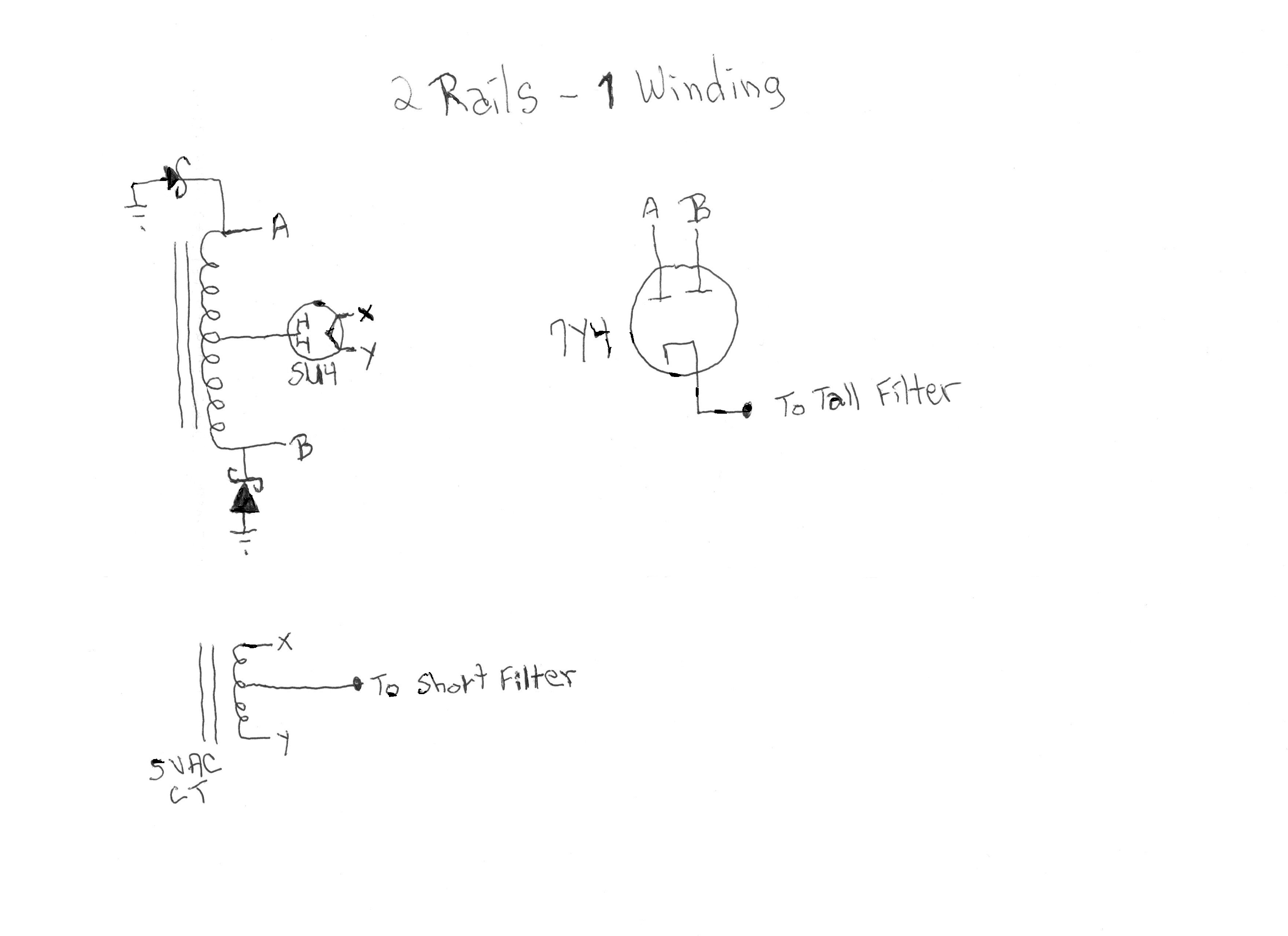

If you have yet to source a power transformer, get something with a 170-0-170 rectifier winding. 2 full wave rectified rails, 1 "tall" and 1 "short", require only 5 diodes. The "tall" rail is bridge rectified and the "short" rail is FWCT. The provided example shows vacuum rectifiers combined with Schottkys, but 100% SS works well too.

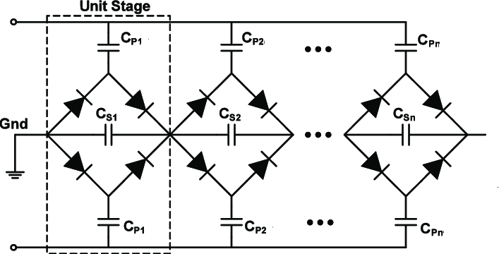

FWIW, the most sophisticated voltage multiplier I am aware of is the provided full wave series/parallel setup. Each stage is a 4 diode bridge. Polarized electrolytic caps. are OK in the series positions, but (IMO) caution requires AC rated film caps. in the parallel positions. The required voltage rating of the parallel position caps. increases, as "movement" away from the point of AC application occurs.
Bipolar PSUs, with possibly differing rail voltages, are possible using this technique. On the AC feed "side", all that's needed is a simple winding of sufficient V/A rating.

Pete Millett publicized 2 full wave rectified rails from 1 CT winding, some time ago. I'm providing an illustrative example that employs both SS and vacuum rectifiers, but 100% SS diodes works too. The "tall" rail is bridge rectified and the "short" rail is FWCT.
The example has a low current "tall" rail and a high current "short" rail, but all sorts of variations, including 1 rail choke I/P filtered and the other cap. I/P filtered, are feasible.

Do you know where that's from Eli? I just can't see any advantage over the bridge scheme wg_ski referred to.
EDIT: without knowing more, the only reason I can see for the 5U4 is that the 1/2V rail doesn't come up faster than the V rail.
I made those "hen scratches". I was illustrating the technique for vacuum rectification aficionados. What's needed is a set of 5 diodes. The SS diodes (low forward drop) between the ends of the rectifier winding and ground are involved in both rails and need to have an appropriate current handling capability.
Theoretically, a diode is not needed on the CT. Practically is another matter. Things can go wrong and the 5th diode provides a margin of error. Also, when PN diodes are used for the ground connections, a vacuum or Schottky 5th diode blocks PN diode switching noise from reaching the "short" rail filter.
The method uniformly distributes the net stresses across the center tapped rectifier winding.
The net rails need not have a roughly 1:2 ratio. For instance, choke I/P filtering the "tall" rail and cap. I/P filtering the "short" rail will make the net ratio quite a bit smaller than 1:2.
BTW, since the 5U4 is directly heated and the 7Y4 has a cathode sleeve, the "short" rail will still "rise" 1st. I was simply showing a low current "tall"/high current "short" configuration.
