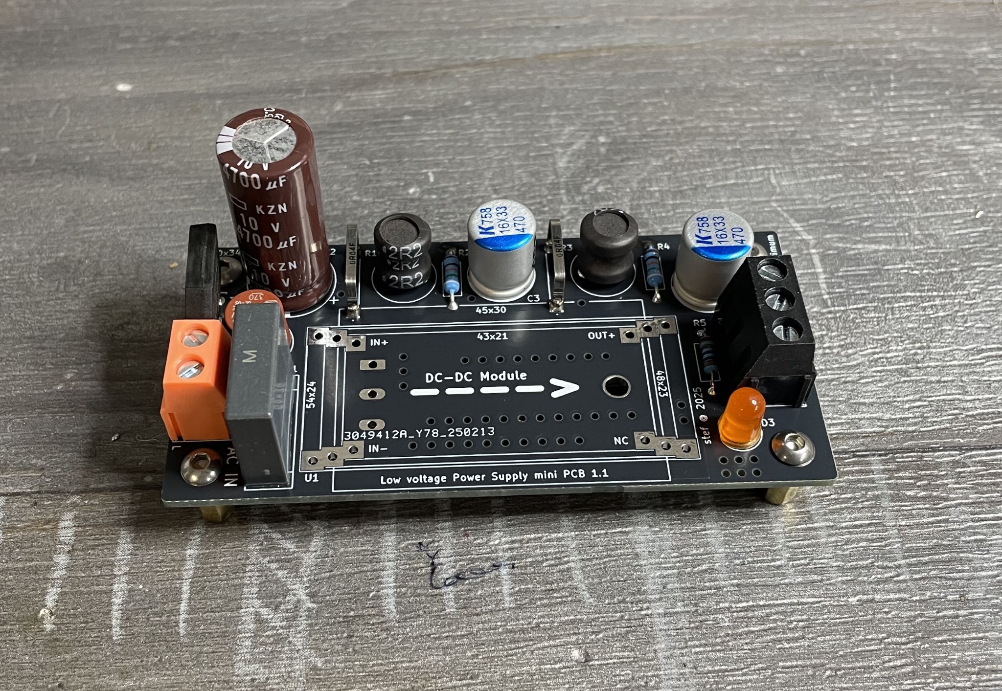

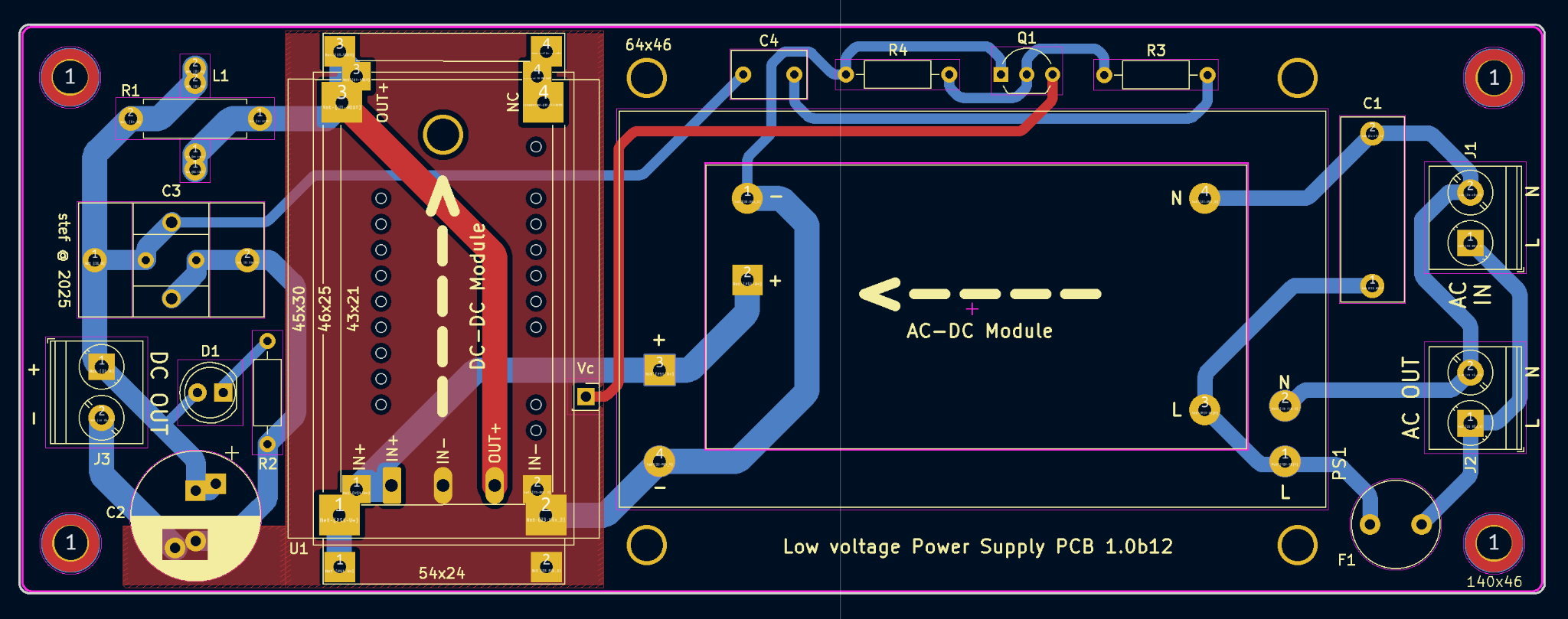

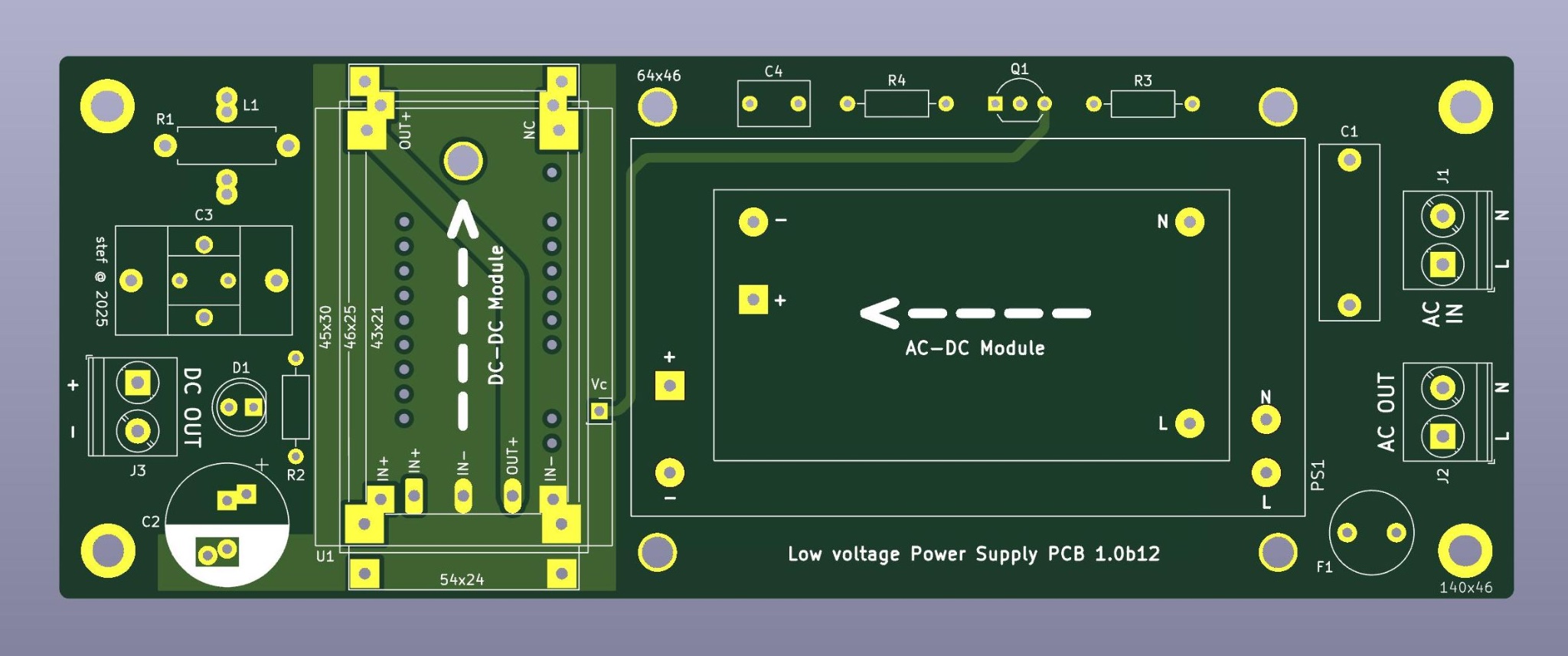

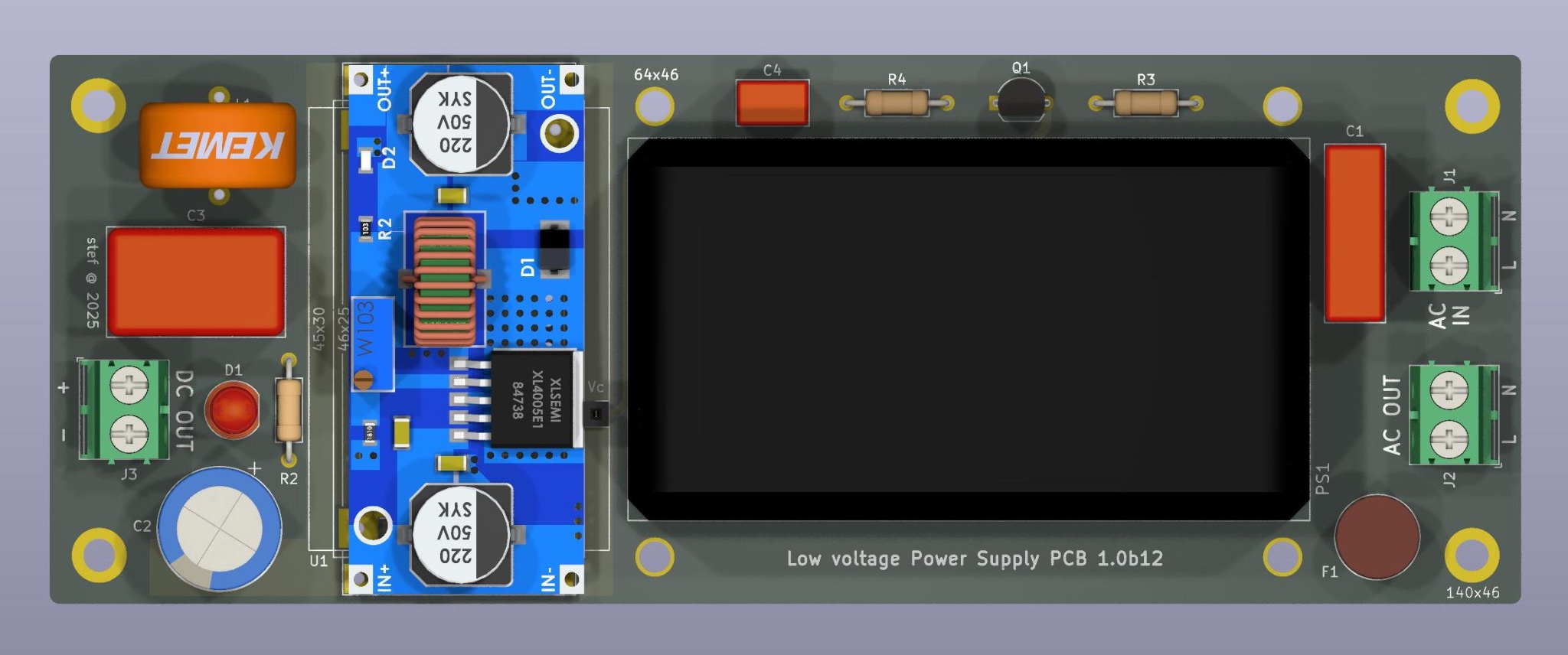

Hello,
I developed two general purpose PCBs to be used with popular DC-DC setup up or step down Chinese modules like the XL4015 or the XL6009.
I developed these PCBs to generate 6.3Vdc for heating the KT88 tube filaments for one of my Tube Amplifier but it is especially interesting because it supports many DC-DC module models allowing it to be used to generate various voltages.
The LVPS-PCB-MINI (90x44) works with a simple diode bridge or with an AC-DC power supply.
The LVPS-PCB-MINI supports four DC-DC module size.

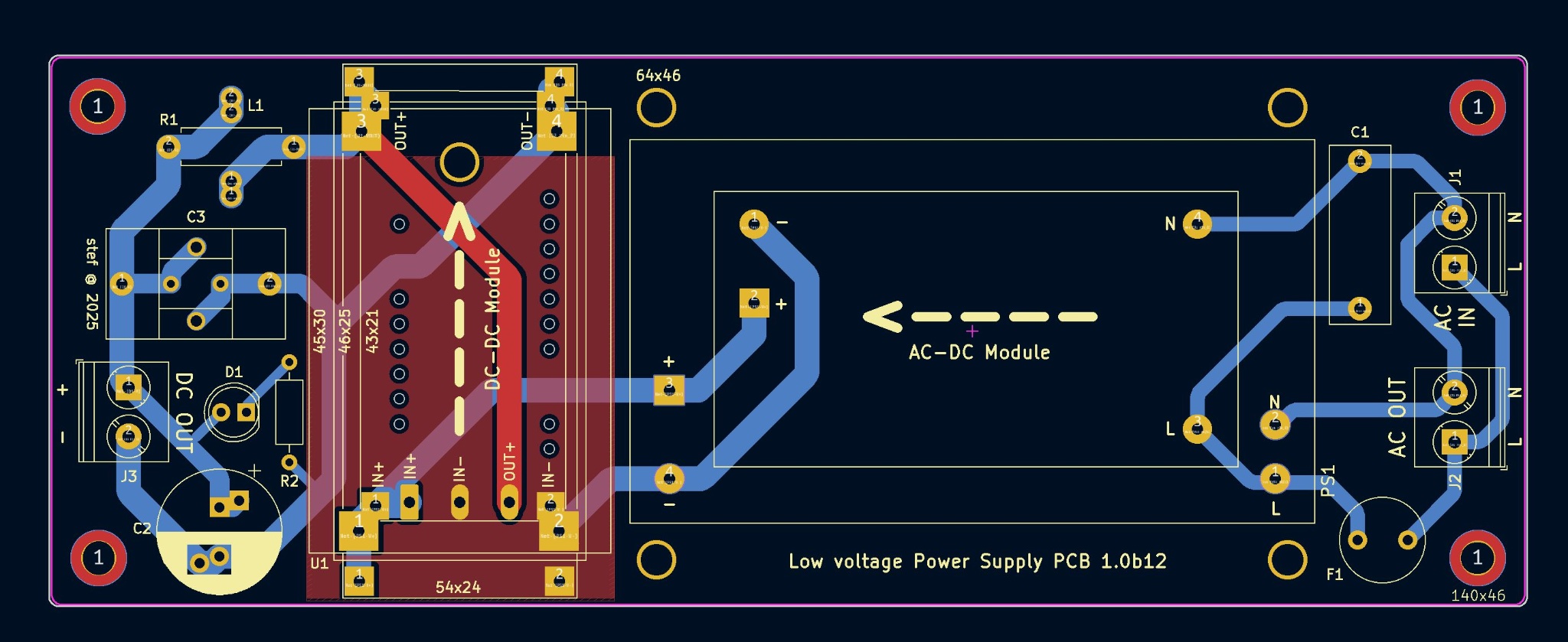

The second PCB (110x44mm) will works directly from the mains voltage via the use of various AC-DC modules from Meanwell, Recom or Hi-Link up to 40W.
The LVPS-PCB support these AC-DC modules:
  • Meanwell IRM-15
  • Meanwell IRM-30
  • Hi-Link HLK-15M
  • Hi-Link HLK-20M
  • Hi-Link HLK-40M
  • Recom RACM30
The two boards could be stacked in a mezzanine (110x44x75).
Gerber files are available on my Github repository.
Stef.

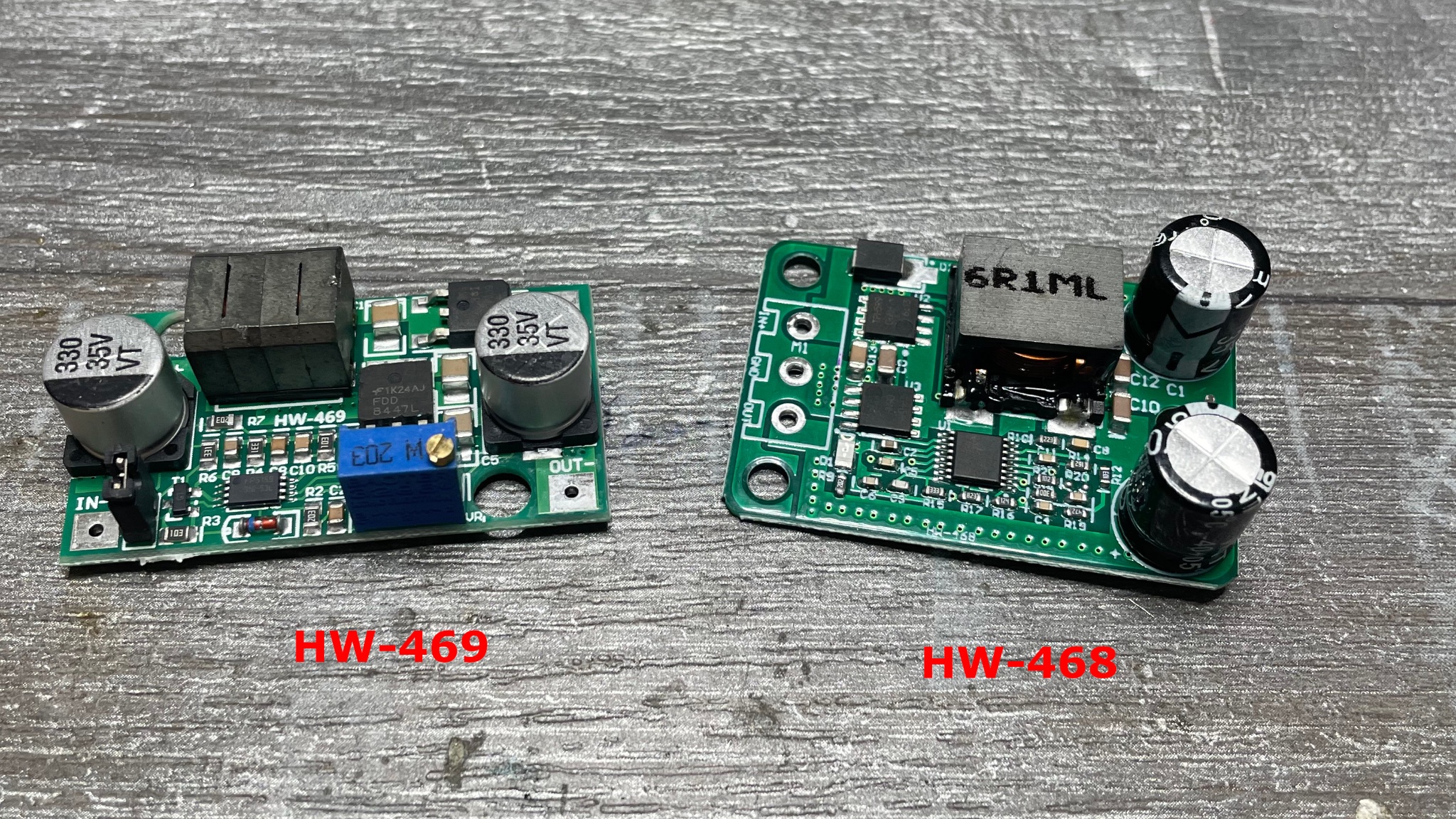

HW-468 (TPS40057) 5V step down: https://fr.aliexpress.com/item/1005006117154837.html

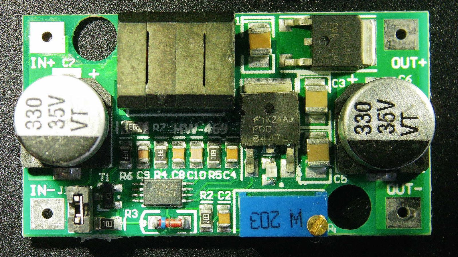

[NOT GOOD] HW-469 (FP5139) step down/up: https://fr.aliexpress.com/item/1005006351906660.html

21/02/2025: Updated LVPS-PCB-MINI to 1.1 version. Gerber files are available on my Github repository.
24/03/2025: Updated LVPS-PCB to 1.10.2 version. Gerber files are available on my Github repository..

Hi they exist already in low loss linear uLDO version.
HI,
This is another way of doing it.

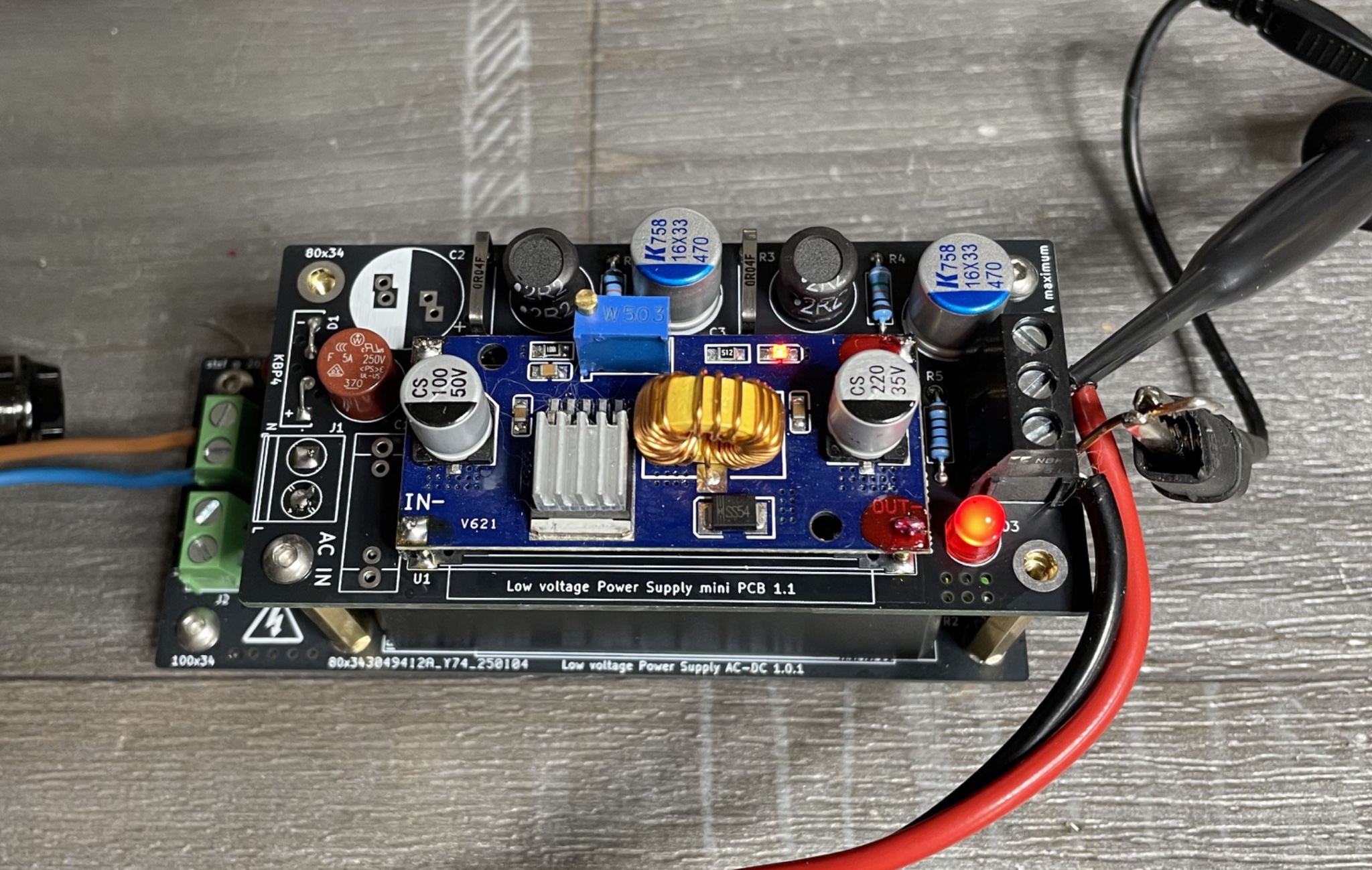

I tested the version with bridge in "flying" wiring until 2.4A at 6.3V and it seems to work well but I have not yet done the measurements and torture tests. The advantage of the AC-DC and DC -DC modules is that it does not heat up at all and that you can use both step up and step down modules.
I don't plan on making ready-made kits, but just making the files available for anyone who wants to test and use them.
Stef.

I also tested the bridge version with an step up XL6009 using a transformer with 5Vac windings to output 5Vdc at 1.3A. Very useful.

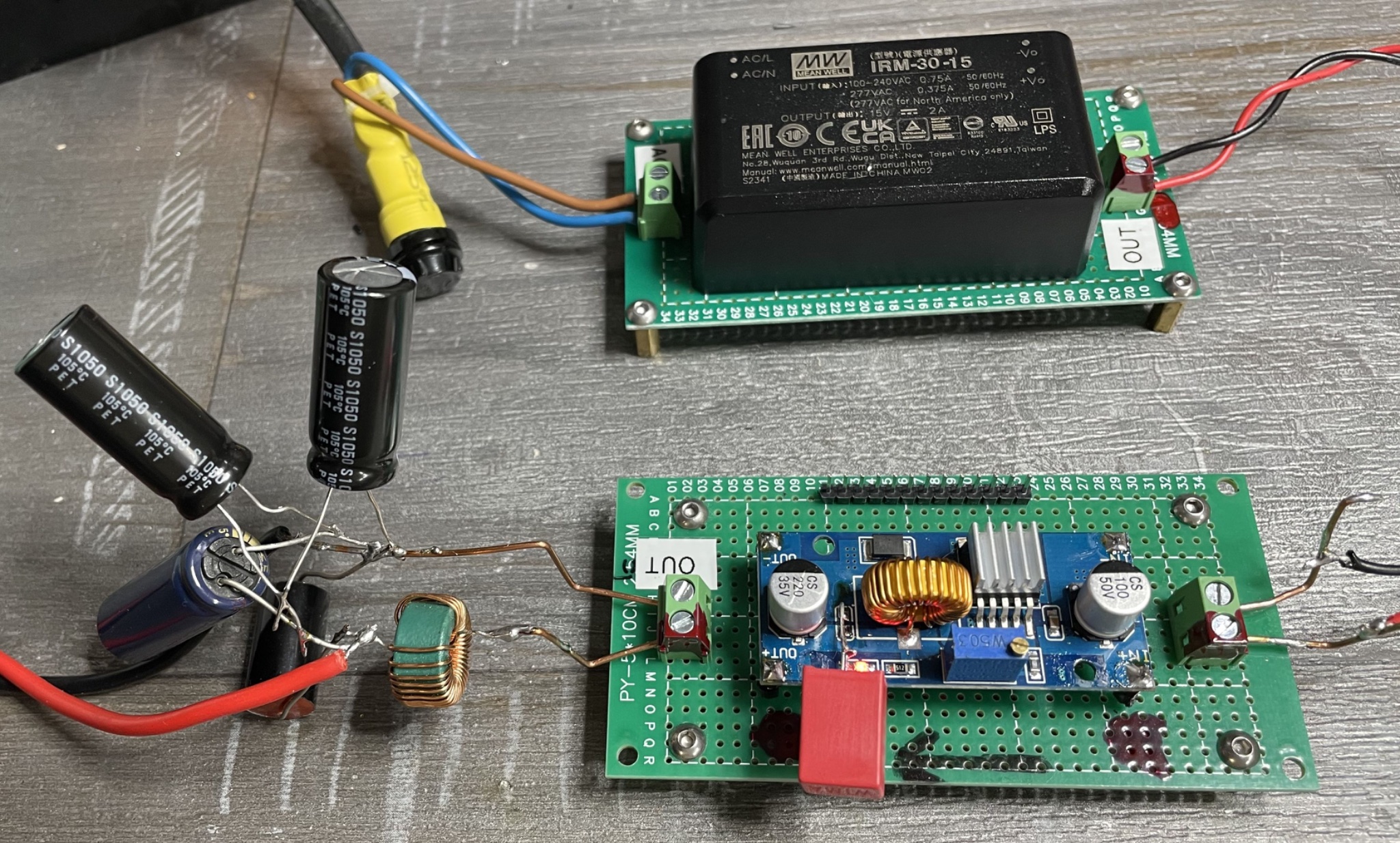

I did some tests with the XL4015. It seems to behave well except that it doesn't have softstart.
I made the ripple measurements of the basic circuit in "flying" wiring. We go from 82mV to 3mV depending on the configuration.
Module tested: XL4015
Input voltage: 15Vdc
Output voltage: 6.3Vdc
Target amperage: 1.5A (with 4R 100W load)
Consumption at 15v: 840mA (12W)
Consumption at 5V: 1.5A
Module alone.
Module with a 330uF at input
Module with a 330uF at input and a 1500uF at output
Module with a 330uF at input and a CRC composed of 220uF (on the module) + 10mH 0R1 inductor + 1500uF at output
The inrush current at start up drawing 1.5A with 1500uF output caps seems to be around 1.3A on the 15V input (less than one second). I don't have the climb curve.
Max output caps seems to be 2200uF. More capacitance degrades the specs and the inrush current draw increases again.
I left it on for 2 hours and I still have 6.3V output when I come back. It only moves on the third digit.
Stef.

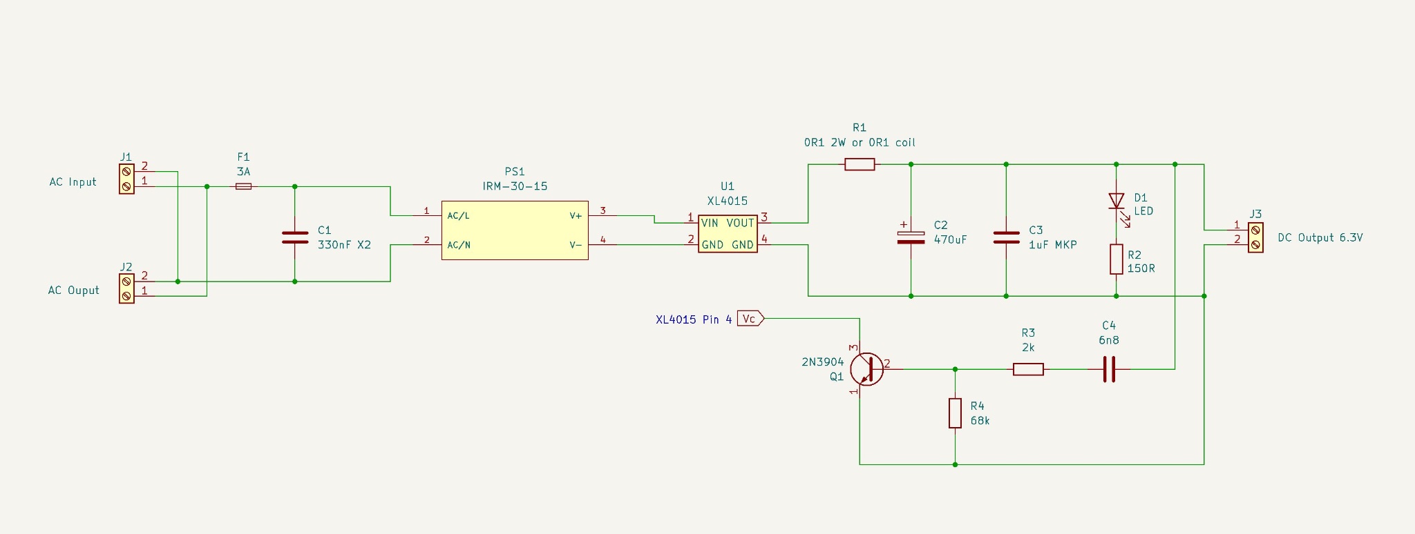

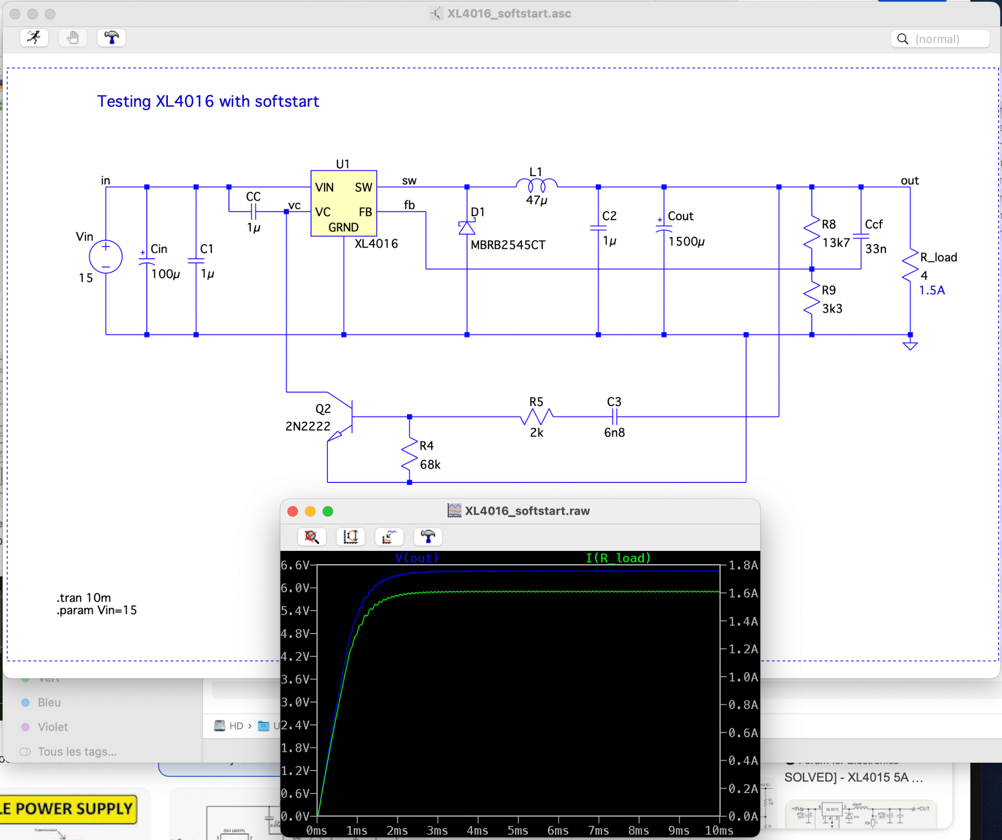

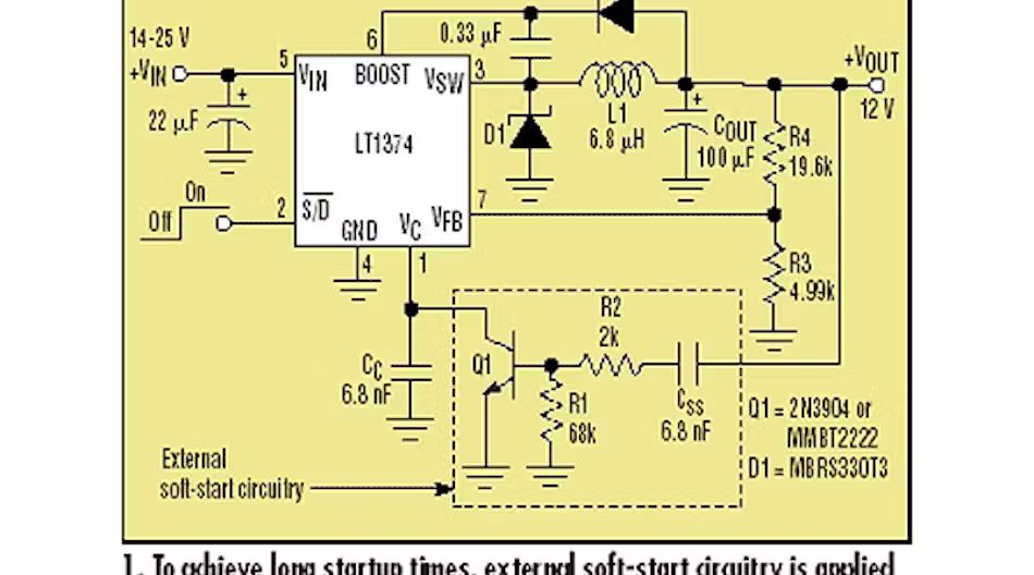

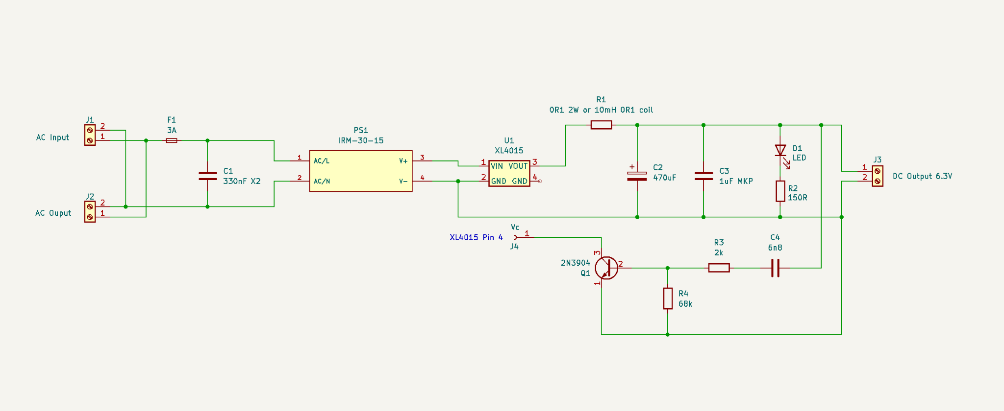

Hello,
In your opinion, will this circuit work as softstart for modules that do not have a built-in softstart?
The circuit connects to the Out+ and Out- and to the Vc pin (n°4) of the XL4015 chip.
I based myself on this yellow circuit.
This circuit will fit on the PCBs.
Stef.

This should be implemented/tested as it is an essential feature for a filament DC power supply. If it can not be implemented then the XL4015 modules are too cheap/not suitable for the intended purpose.
I think many would prefer to spend more so their tubes will live longer. Most transformers also have 6.3V windings so with high chance of not having a power on maximum current surge. Things were simple and pretty adequate. A DC PSU (with about always the same power on behavior to its load) must have protection against that to be able to compete with the original way of doing stuff.

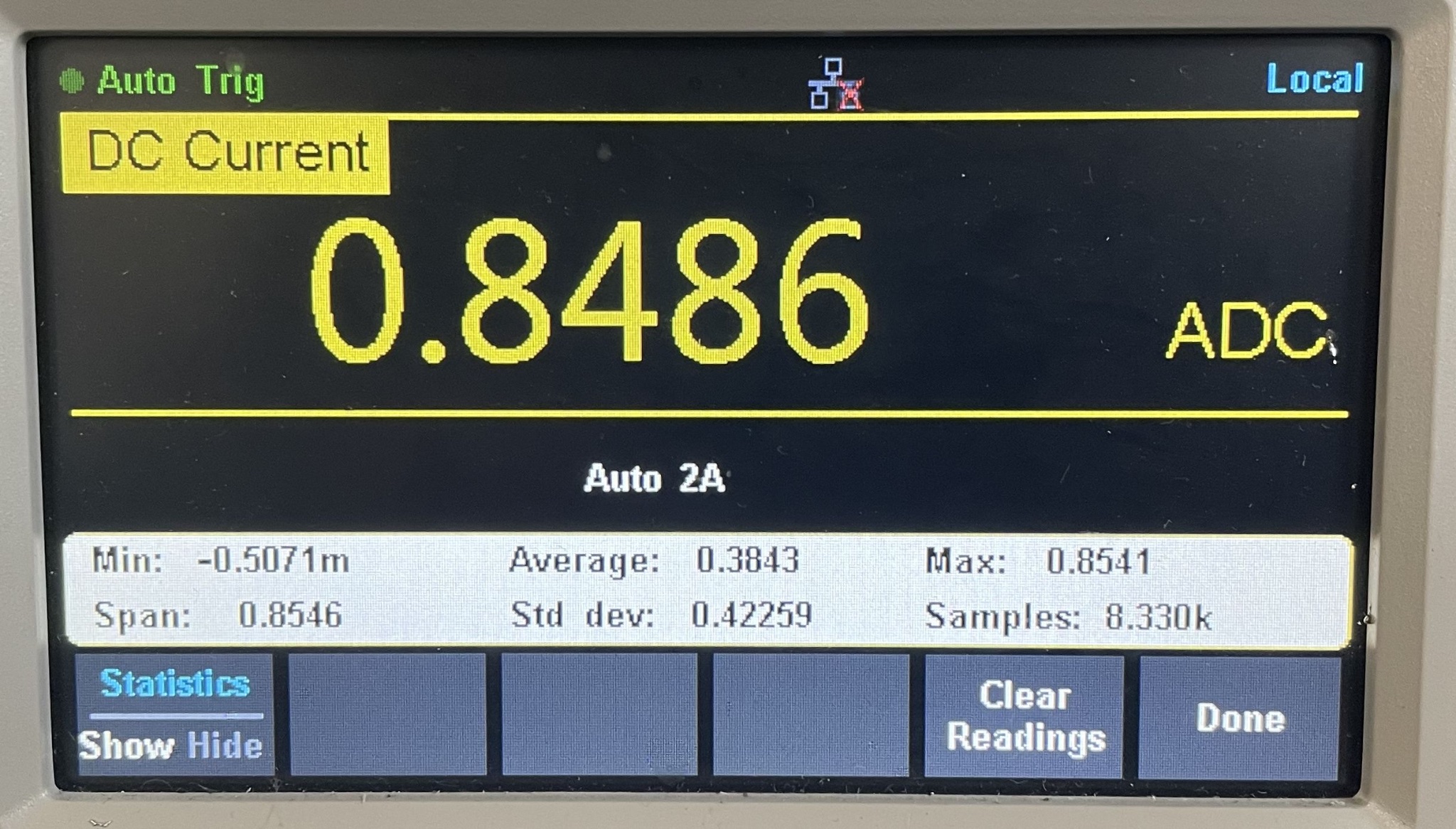

Well, I'm not sure that there is an inrush current at startup with the XL4015.
I connected my table multimeter in current mode and fast acquisition and I don't see the inrush peak.
I'm still with the same config. 15V input and 6.3V 1.5A output.
I must have a strange behavior with my laboratory power supply. If I set the CC protection to 1A, the XL4015 module does not start and the CC protection starts on the lab power supply. If I set the power supply protection to 1.3A, the XL4015 module starts as it should.
Weird.
Stef.

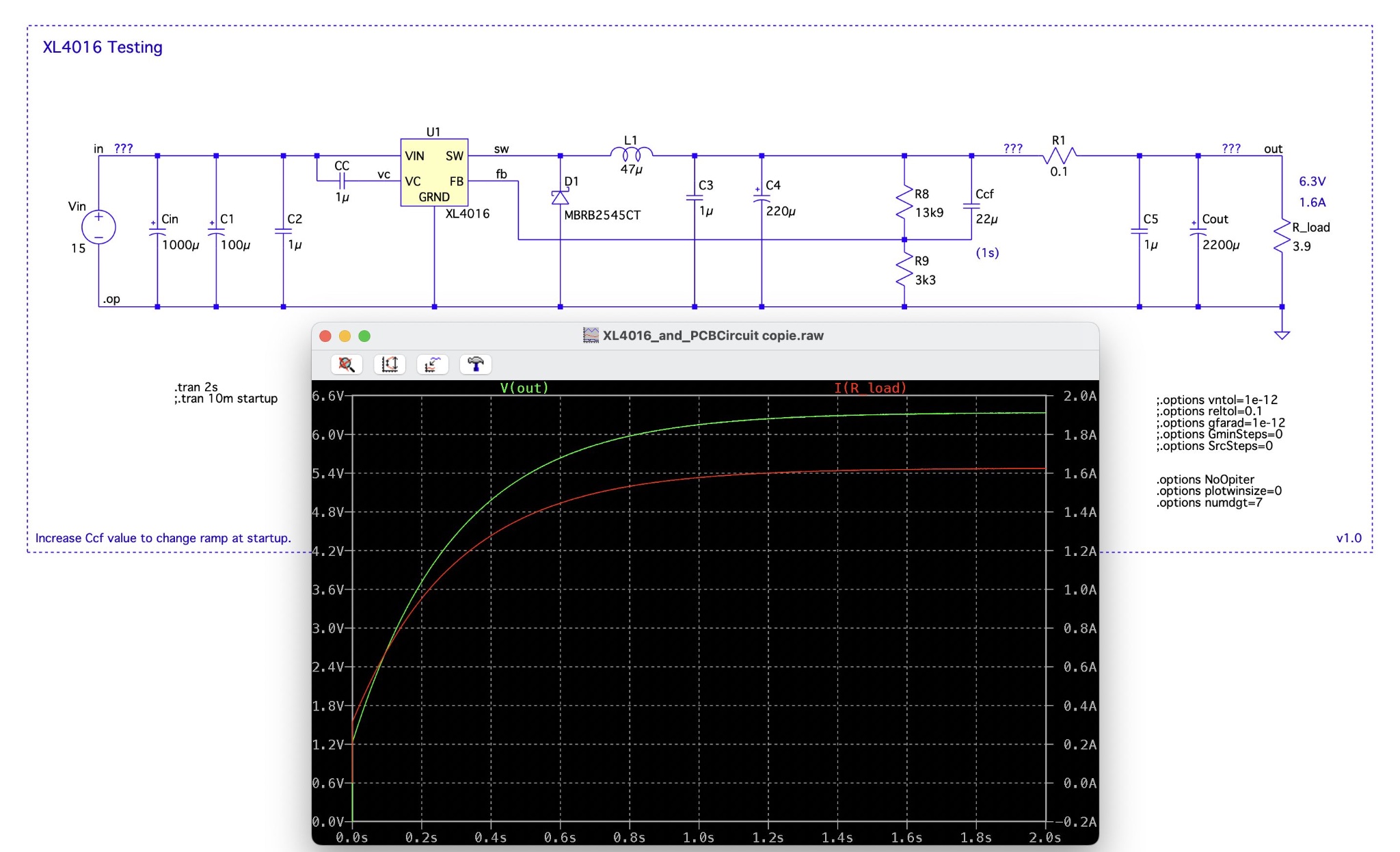

I found a library for the XL4016 (almost the same as the XL4015) for LTSpice and the softstart seems to work.
This is exactly what is meant. The loads behavior at power on requires slow ramp up of output voltage to filaments.
What you describe is probably the inrush current of that PSU that requires more current at cold start. A relatively normal phenomenon with switchers as they are often a capacitive load.

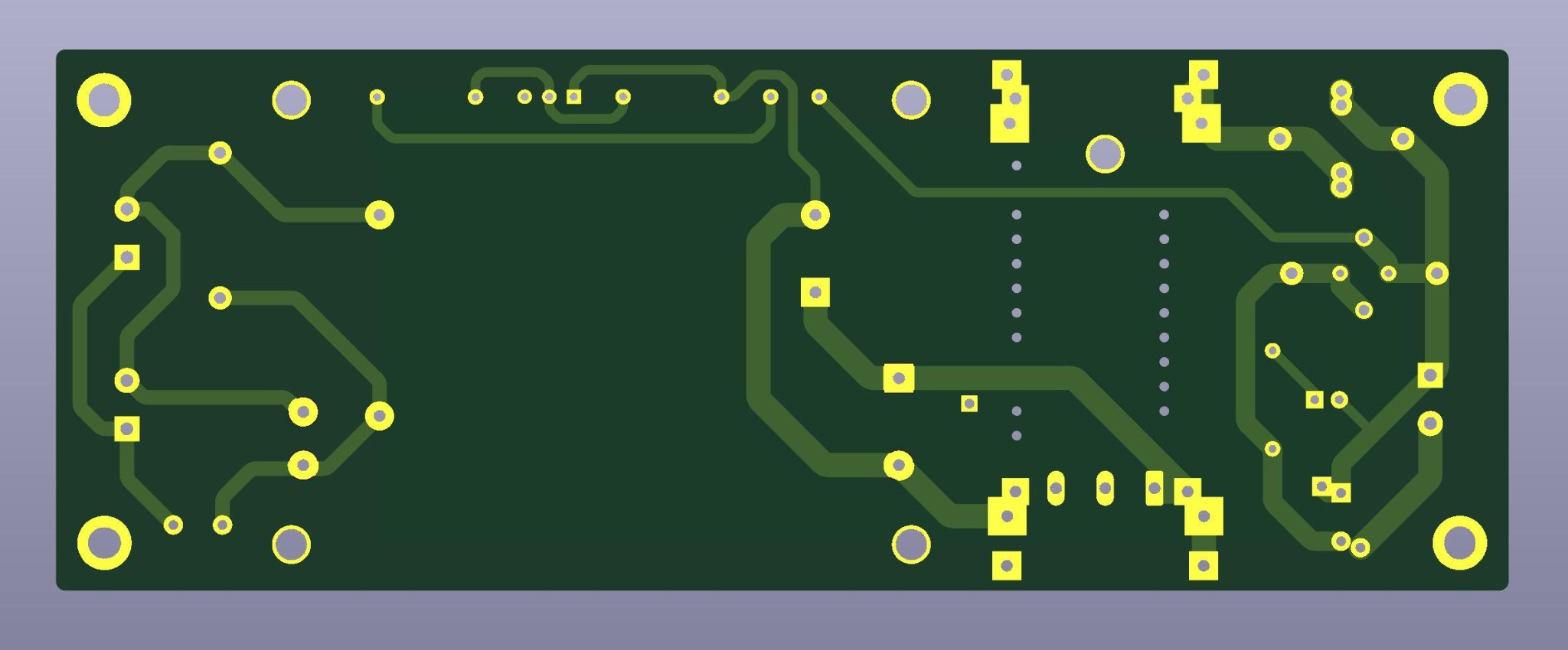

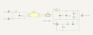

Here is the latest updated version.
I will try later to test the softstart circuit for the XL4015 live to see if this still triggers the labs psu CC.
Stef.

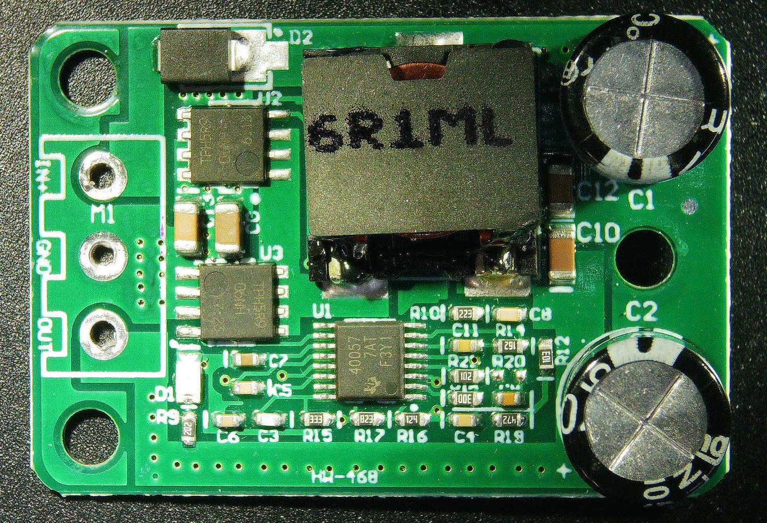

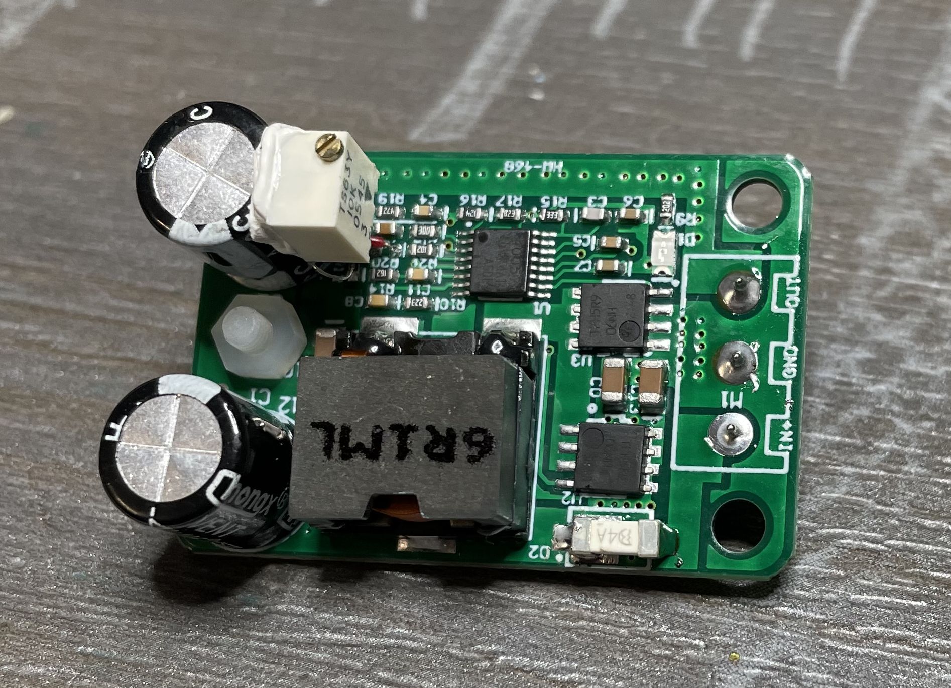

Hello,
For those who would be interested in the HW-468 5V module, it is very easy to switch it to adjustable voltage.
You just have to either put a 10K trimmer on the two red points or directly put a 402 resistor of the correct value. It is also possible to replace the Schottky diode D2 by a 4A CMS fuse. This improves performance.
The HW-469 module is not great. It does not work very well in step up. From a voltage of 5V at the input, you cannot make 5V or more. It goes into protection or does not output anything. Disqualified. So far I have not found a module that can compete with the excellent XL6009 or XL6019.
Stef.

HI!
I made more testing with the last batch of XL4015 module I received.
I've done tests at 6.3V 1.6A. The IRM-30-15 is a bit short. 1.3-1.4A seems more reasonable to avoid it getting too hot. From the cut, I switched to a 12Vac 4.5A toroid + bridge power supply.
When you start the module, it limits the current in two steps. You can see on the display, one step towards 4.5V and another at 6.3V. By default the ramp is 8ms (Ccf = 120nF) but it can be easily modified.
The module does not support more than 2200uF in the output capacitor (in addition to the one on the module). If you put more you lose efficiency, the ripple moves up and this draws more current from the power supply.
It needs at least 10V at the input for it to work properly.
The ripple is about 2-5mV depending on the capacitors behind and the CLC. The running frequency is 100KHz. 80mV bare without capacitors or CLC.
It does not heat up or almost even at 1.6A.
I also tested the HW-468 module. The ripple is better, between 1.5mV and 2mV. It has a softstart and many protection inside.
Stef.
Ps: I upload the last LTSpice files on Github.
Picture of the tests with 22uF in Ccf. This gives a ramp of 1200ms. I ordered myself some 22uF 805s to try out.
I also reworked the AC version PCB. I gained 10mm, 90x44mm now.
