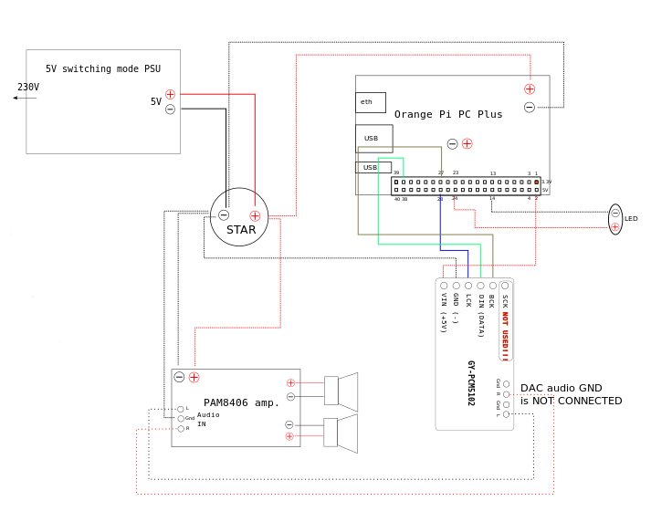

I am working on that but its difficult to earth the Pi also the dac is non powered, USB only.As I wrote some time ago in another forum ("Class D"):
"You should connect all ground lines together 🙂
You don't need to "earth" the Pi (unless it's in a metal case, in which case it's a good idea to "earth" it by connecting minus (ground) power to the case).
You just need to tie the power ground of the Pi and the power ground of the amp to the same point.
As for DAC, see my crude illustration of how I connected my components in my project.
Granted, my system is a bit different, since everyting runs on 5V.
I like the idea of your pcm5102 dac, seems a much better solution than my usb dac. I tried your star earth idea but no better. Will try again when I get a 12s dac. I will have to wait to get one from China as I have spent far too much already.
Creating a star ground doesn't work in this case, the rpi and amplifier will still use the same wires for power ground and signal ground.
