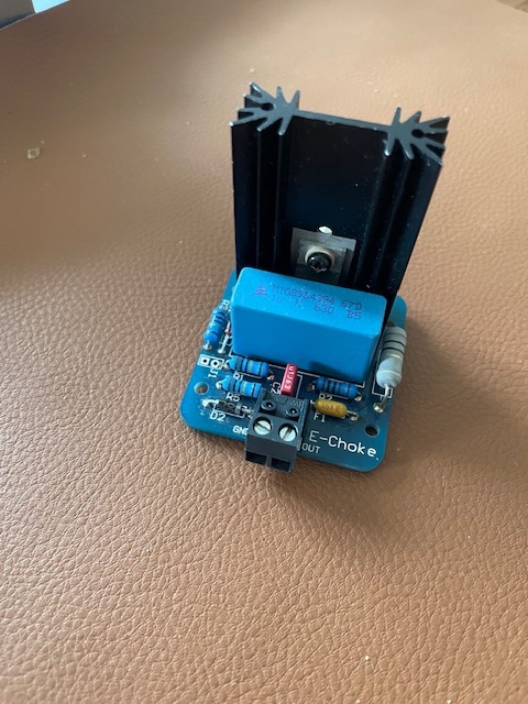

Late to the party, but interested in this circuit. I see several resistors in the schematic '1m'; I presume these are meant to be 1M, not 1milli?
Jan
Coincidentally I have the board(s) in front of me and there are 3 x 1 MOhm. Maybe milliOhms are a little unlikely as literally everything in tube audio is high ohmic. Unfortunately the trend in the anglosphere is to write units deliberately erroneous like Db, hZ, Va, vA, mhZ, Ma, ma, v, Uf, uf, mmf, Kohm etc.
Forgot where the boards came from but make sure your version has connector blocks capable of the DC voltages and standoffs to have enough clearance to the DC voltages. This one needs plastic standoffs. The designer included a 0.5A fuse which is good thinking.
