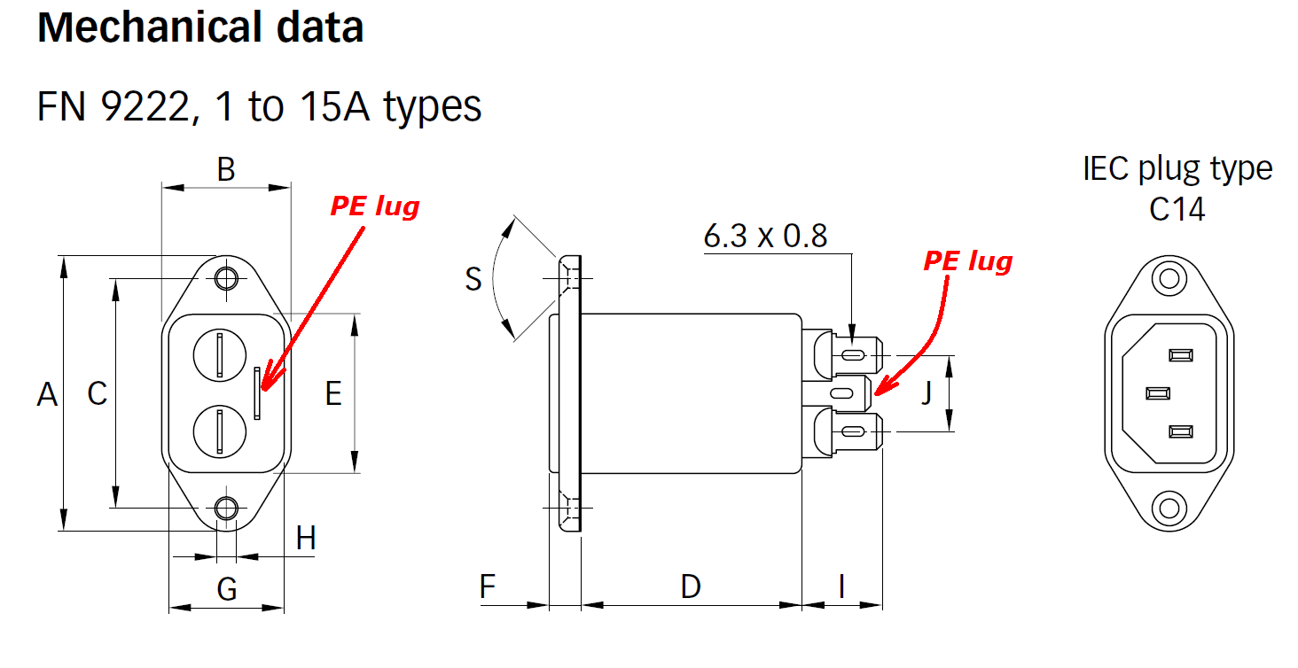

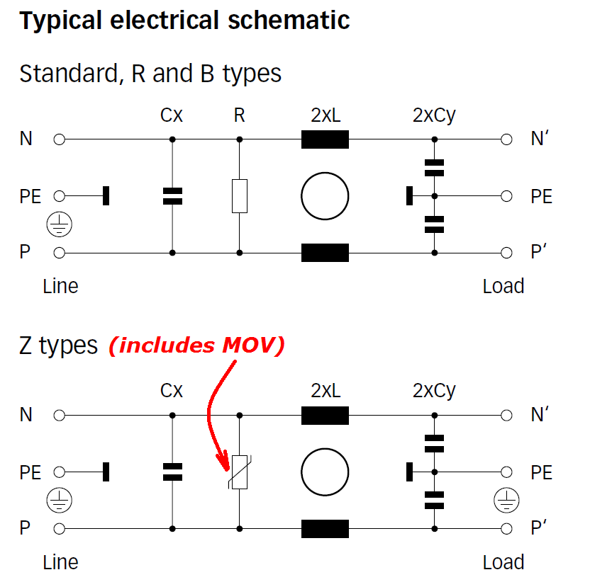

The FN9222Z {see attached image} contains... X2 cap ... probably exactly whats inside those fancy IEC sockets anyways.
- an X capacitor ("Cx")
- a Metal Oxide Varistor ("MOV")
- a common-mode choke ("2xL")
- two Y capacitors ("2xCy")
- a metal casing
