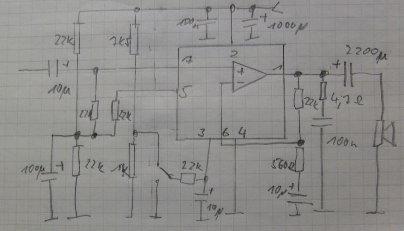

I was wondering if anyone has tried to make a split supply(+/-) from a single non-center tap output transformer. I bought a transformer from Parts Express (129-075), and I was hoping to do just that. Now I know the once I rectify the AC and use 2 equal value caps in series a cross the output, my voltage is cut and half. Sound prefect right , however when I load the circuit, I end up more voltage on side or the other? I'm looking to get +/- 22v for a pair of TDA2052. My source for the transformer is :32v(which is what I what to divide in half and then regulate), 16V-0-16v, 12v AC

You need a transformer with either a center tap, or dual secondary windings.
Otherwise your circuit ground is floating and will drift when a load is applied unequally to the rails of the supply, as you've found out. You can get away with it for very low-power applications, but not for a power amp.
It could be done. But it would probably be best to just use two suitable transformers, or a transformer with suitable dual secondaries.
If you really don't want to buy another transformer, you 'might' be able to use a power 'rail splitter', which would take your approximately 43.6v and split it into +/- 21.8v and create a new 'virtual ground' between the two new power rails. You could rectify and filter (and maybe regulate, if +/-20v or so is good-enough) your existing transformer's output and then use a circuit similar to the one shown in the LM675 datasheet at national.com. You would need to use a chipamp that could handle the current and voltage, etc etc, instead of the LM675.
sorry, I mixed it up with TDA 2050 😱
the attached circuit should work. But I haven't tried it personally.
