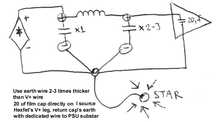

I'm just following Kristijans circuit for Aleph 5 power supply which has transformer, bridges, 2 x 47,000uF followed by 3.9mH followed by 2x 22,000uF
Are you saying the caps should be the other way round?
Why are air cores better than ferrite or iron?
Some Rdc in the coil takes good care of the surge voltage as the magnetic field collapses.
Keep the final cap 2x to 3x the capacitance of the one before the inductance. Working voltage in a PSU cap is way lower than what it can handle in a ms. We normally find much higher than V+ rated caps in a Zen's suppply anyway. The market is full of 50,63,80V good caps as needed for class AB PP amps and the like.
I recommend to use a 20uf polyprop cap directly on the source mosfet V+ connection with a dedicated return cable to star earth.
Use 1/3 the thickness of PSU wire for V+ and speaker terminals than the one for PSU earth.
Star earth the amp and speaker on the edge of a 10cm long wire tapped off a -PSU caps star subjunction.
Regards
N.S.

Here is my proposed wiring scheme.
Nikos

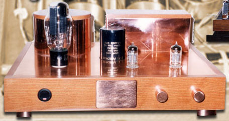

No problem with value changes. Any honestly sized core will provide the inductance. I have compared air coils, ferrite coils, iron dust coils, toroid coils. Technically on DC they fare identical when properly sized. Alas they sound different.
In my current preamp I use 3 toroid 20H chokes in stages. 70 Ohm Rdc each...I could easily pick up the sound change of a Holco over a sandcast resistor used as a damper feeding the first cap after the tube rectifier!
The darn things are a pain in the behind to put together based on final sound performance grounds....
And they are barely taxed... imagine 3A or 6A in a common PSU...
They do sound horrible if not being the properly picked ones.
Did you compare the coils soundwise? They even got warm.... they should be screaming aural signatures. 😉
