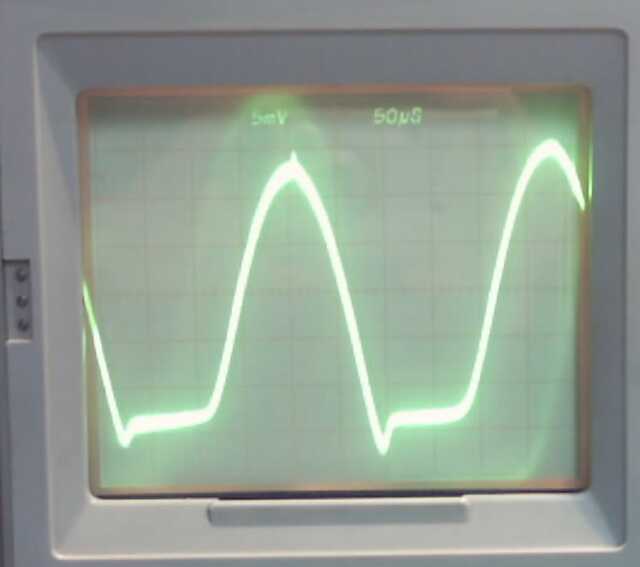

icceman, could you tell me what I see at the first pictures? Where have you put the probe?icceman said:Difference between normal and schottky bridge rectifier:
Normal rectifier
Schottky rectifier
BTW: Very nice PS!
The measurements were taken from the - & + of the bridge rectifier (without load) and the scope was set to AC coupled. I didn't record down the time base (I'm using the AUTO function of the scope) as I'm not really interested in measuring anything (just wanted to see the difference between standard and schottky rectifier).🙂
AC traces
Even the trace with the Schottkys is a long way from a clean sine wave. How about posting the traces (standard vs. Schottky "downstream" from a pair of fairly conventional filter caps? That's what the amp or opamp will see.
I suspect that even with Schottkys (Freds, etc) that the a good PSRR shouldn't be neglected.
By the way, what is the typical set up to measure PSRR? I understand the idea and what it intends to show but I'm don't know how one goes about measuring it (especially with my meagre means).

Icceman, where and how did you take these measurements, I would like to compare some diodes I got in the same way.
Thanx.

Icceman, sorry to sound stupid, but did you just connect your probe across 1 of the diodes or over the 2 AC inputs, or where otherwise?
Thanx again.

The measurements were taken from the - & + of the bridge rectifier module(without load) and the scope was set to AC coupled.JDeV said:
Thanx.
The 4 Schottky rectifiers are in a bridge arrangement. The probe is connected across the + & - of the bridge (not the AC inputs).JDeV said:Icceman, sorry to sound stupid, but did you just connect your probe across 1 of the diodes or over the 2 AC inputs, or where otherwise?
Thanx again.
I don't think half-wave rectifying a signal from a function generator is much of a test. The reverse recovery characteristic depends upon the forward current. In equipment where the conduction angle is small and the current draw is large, like a power amplifier, the diodes have a much more difficult task.

Thats absolute right, but it was all i´m able to put together in 5 minutes.
I´m on a better test setup right now.
real (big) transformer, rectifyer is bridge, not half. Please give your comment about should i use a capacitor or not, and how much load(i hope pure resistive)?
For test i have on hand a 400V25A normal bridge rectifier, a hand full of suber fast / soft recovery stealth diodes, and some 10 and 20A 100V schottkys.

I think you should try with a varying amount of capacitance. This will show the effect of conduction angle.
For the load, I would use a power FET mounted on a heatsink and a power resistor chosen for the desired current.
