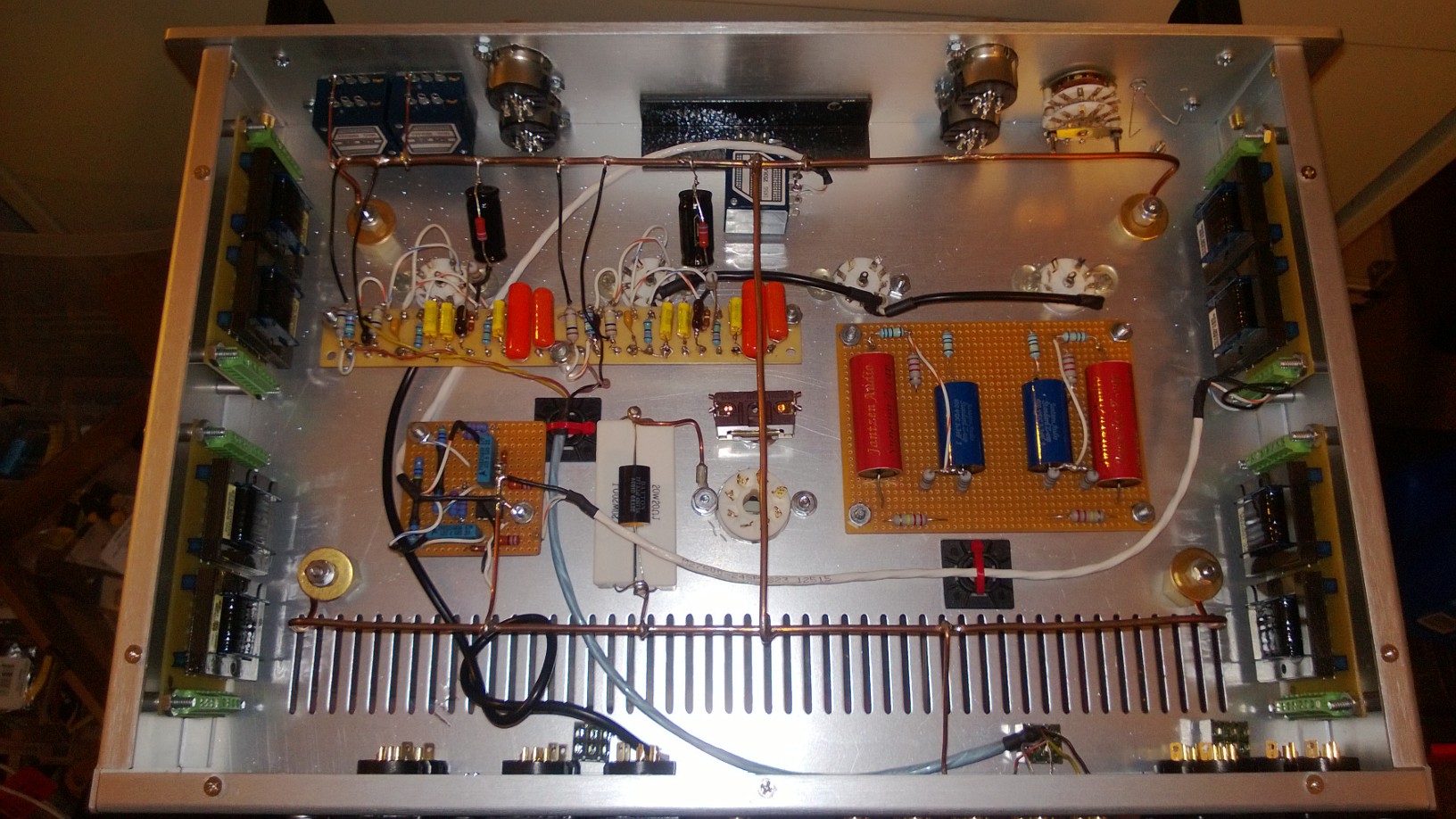

Here's the ground scenario
This can be changed. I'm trying to visualize how I'd physically ground the components. On the left two sockets, is the phono stage and the right two sockets are a line-stage.
All Inputs and Outputs are on the rear of the chassis.
The volume pot in the middle near the front is for an Opamp headphone circuit.
Volume's on the top left will be input, and output respectively.
If anyone's curious....on the sides of the preamp are Edcor balanced/unbalanced matching transformers.
Ignore the 8 pin socket in the middle- it's unused (originally the supply was going to be in this chassis).
The filament wiring is daisy-chained 18 shielded.

Currently the black wire (filaments) is just coiled up not terminated.
The blue wire is to the Phono stage Inputs.
The white wires run from headphone stage (it's basically a Cmos circuit), to a volume control on the input, and a transformer to convert signal to balanced.
That's just to give an indication of what the wires installed thus far are doing.
As far as the grounding, does anyone see a problem with using the copper wire as I'm using it? Could it possibly be as simple as connecting the ground wire from the power supply unit to the middle of this copper matrix?

Why the middle? Read what I said. Best to join grounds at the high signal end of the circuit.

I did read what you just said, based on that given the picture above, where specifically would you ground the volume controls, signal and cathodes?

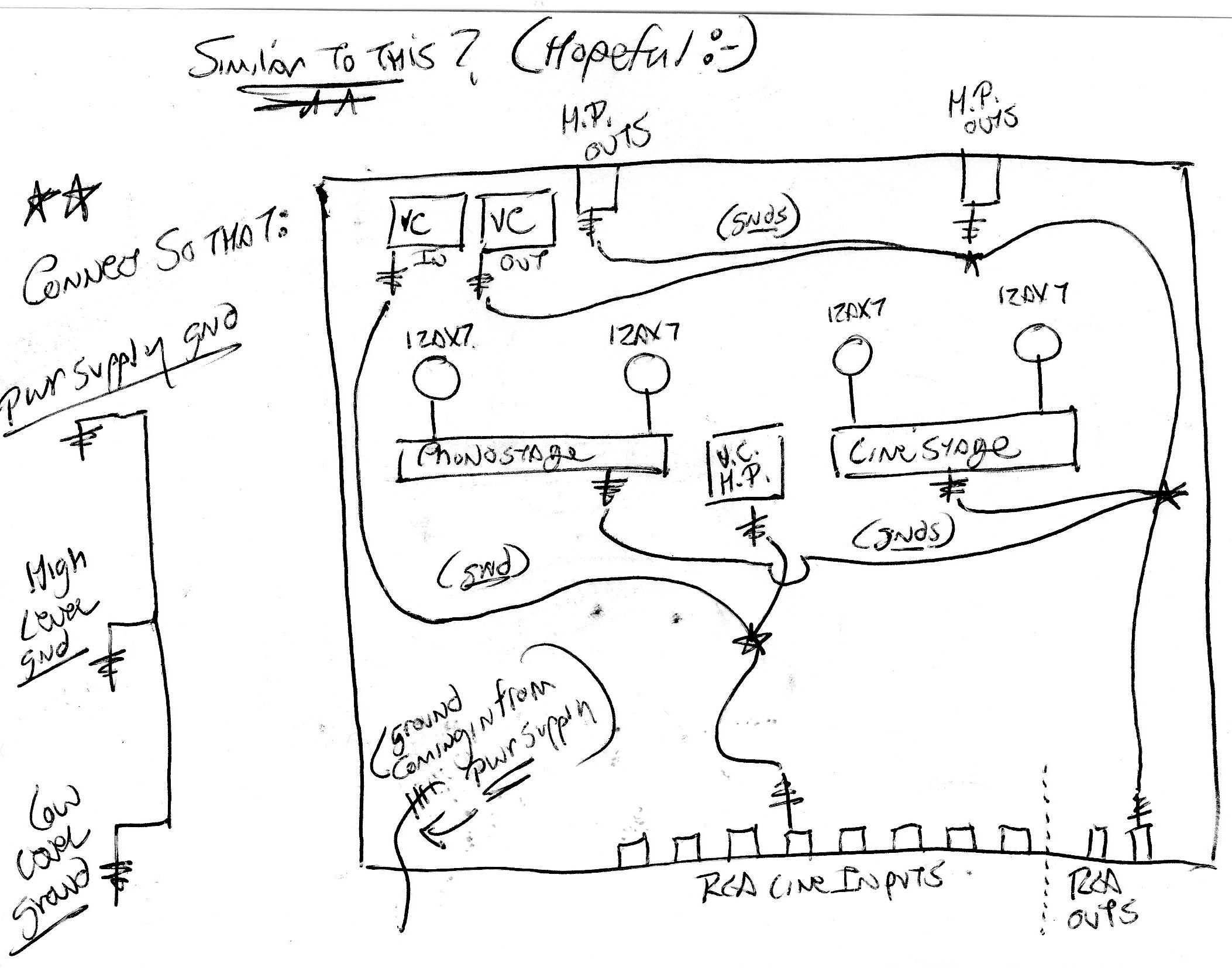

Dare I be so bold as to post a simply drawing and ask if this is on the right track?
Yes, that might work.
Because of my background I tend to build audio circuits as though they are RF circuits, so short connections and small loops.

OK, I am learning grounding myself so here is the stupid question.
Shouldn't that ground wire have only 1 connection to the case?
The connections in the picture aren't actually to the chassis, they are "stars" just shown for reference. In other words, all the low level signal ground go to one "star" point, the high level signal grounds go to another, then the power supply grounds go to a 3rd point, and all points are connected on a ground "bus" or bar. Then that bus get's grounded to the chassis through a "bridge" made up of a 10 ohm 10 watt resistor (in my case I used (2) 20 ohm 10 watters in parallel), and a 0.1 uf cap.

Also, I'm envisioning this right now, and was wondering, how about a copper electrical box bus??
So, run the bus bar down the center of the preamp- back end of it connects to power supply ground.
Then in the middle of it, all high level signal grounds go to a star point.
Then at the top of it, all low level signal grounds go to a star point.
Then it connects to the chassis through a bridge at.......the bottom.....or the top?
