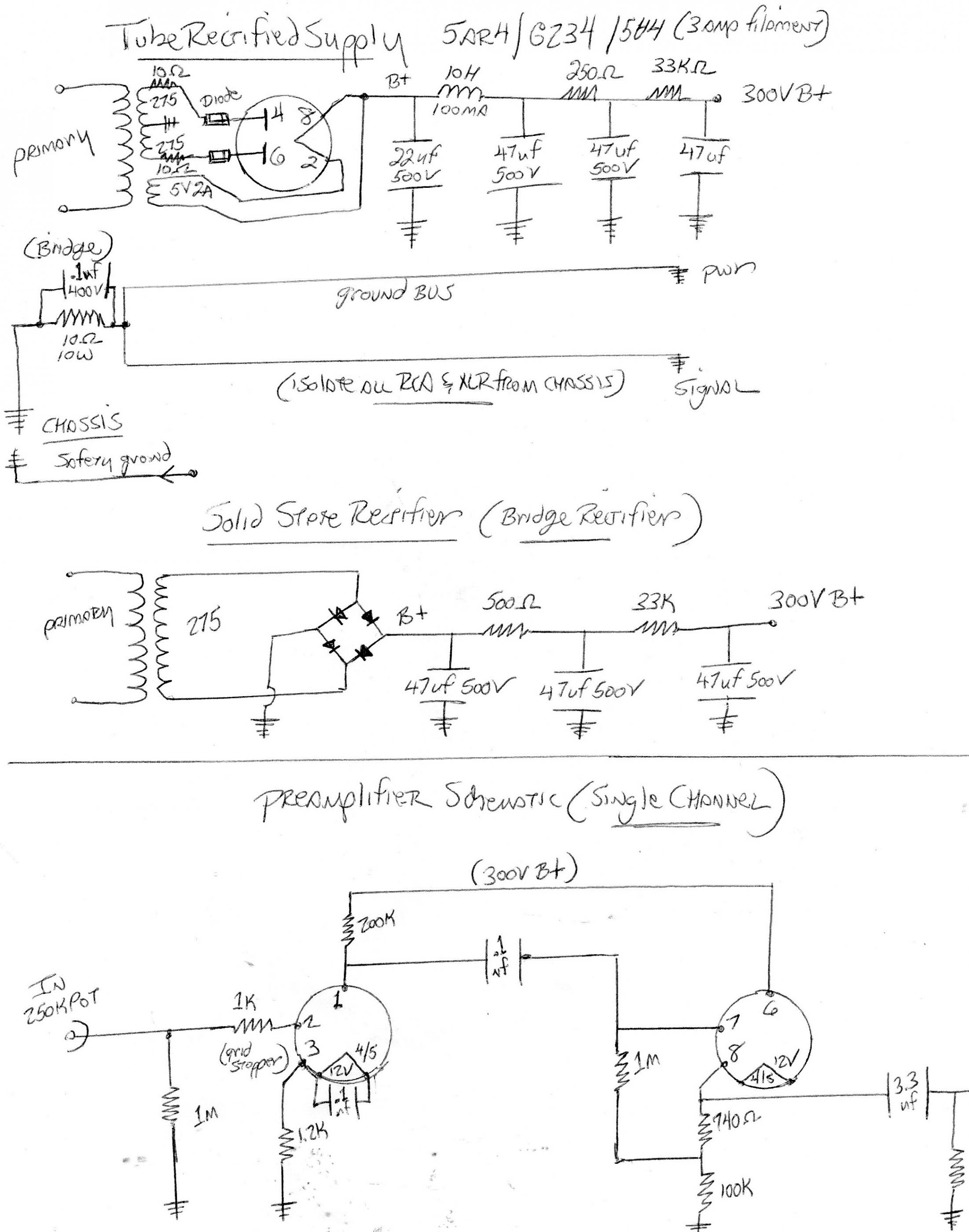

Thanks for the replies and sorry for the delay. I'm going to try the PSU in a seperate chassis, with an umbilical cable to the preamp, with conductors of 14/4.
The plan is to send 12 VDC down two wires of the cable, and the 300 volts down the other two.
The preamp has 4 separate channels, 2 are 12ax7 phono stage left and right, and the other 2 are 12ax7 line level preamp channels.
This is a continuation of a project I was building a few weeks back which I decided to scrap.
I am laying out this one from scratch, and really want to get the noise floor down as much as possible.
Please ignore the SS rectifier supply in the drawing I will not be using that, but rather will be using the Tube Rectified version above it.

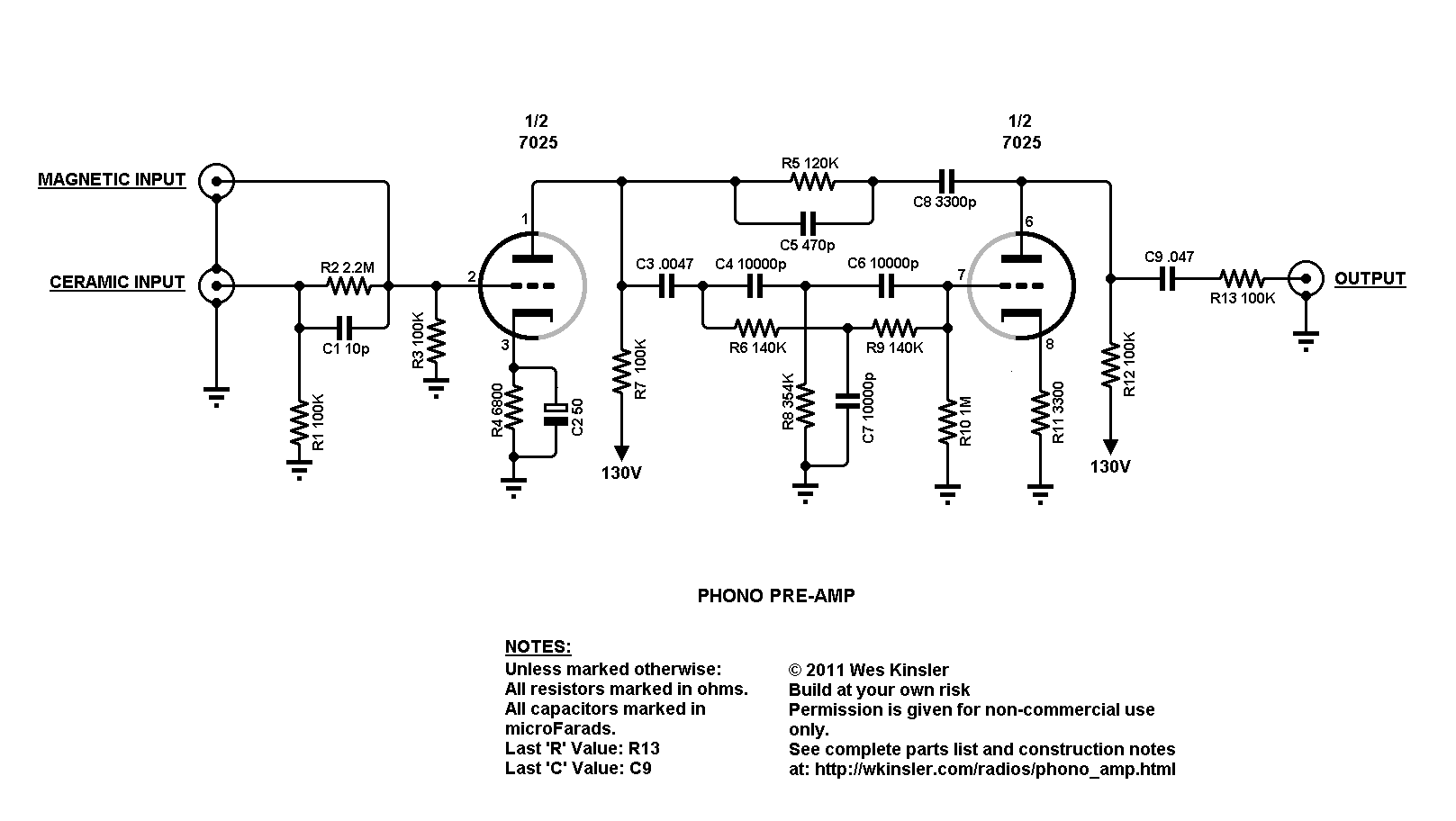

The second picture is an RIAA stage for the phono that I am implementing into the desgin.

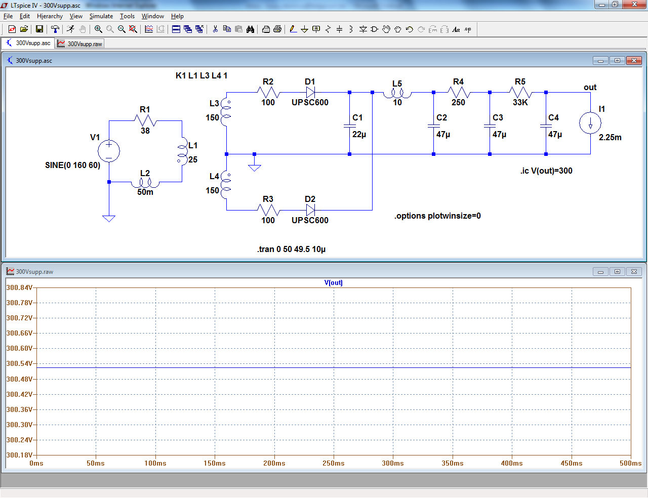

With such a filter, the noise will be vanishingly small: it is below the default resolution of LTspice.I am laying out this one from scratch, and really want to get the noise floor down as much as possible.
Since the p-p ripple on C3 is ~215µV and the final RC brings an additional 60dB, the result should be 215nV. Unlikely to cause problems. If you still get hum, that simply means there is something wrong in the wiring.
Note that the supply will be capable of providing only 2.3mA for a 300V output.
From a purely academic perspective, the circuit is improvable: if you make R4 and R5 approximately equal (15K + 18K for example), you will gain a few tens of dB quietness, should that matter...

The transformers HV secondary is rated at 570 C.T. 220 ma. Is the circuit itself, or the limit of the 100ma choke what's going to keep me from having more than net 2.3 ma?
I plan on providing 300 volt for a total of (4) 12ax7 tubes.
Is there anything I can do to improve upon this power supply circuit without getting overly complex?

You can reduce it to taste, but of course this will affect the ripple level, as will the output current.
Since you have quite a margin, this shouldn't be a problem
Apart from tweaking the resistor's values to get the best result for a given current, no.Is there anything I can do to improve upon this power supply circuit without getting overly complex?
You could always increase the size of the filter caps, or add another RC, but this looks unnecessary.

You may need to be careful with subsonic problems, as your PSU has quite a high subsonic output impedance due to the 33k resistor. In general, it is not a good idea to make a PSU for a much higher voltage then drop the surplus across a big resistor.
Your circuit diagram did not make clear the grounding arrangements, which will be the decider on hum (given so many smoothing sections).

DF, I will change those two resistors to 15k and 18 k respectively however I guess the grounding layout is what I'm mainly here to ask about today since the regulation, etc. isn't the actual issue causing hum.
My plan was to have the CT, and smoothing caps star grounded with a bridge between them and the external power supply chassis, then run that star ground down a length of 14 gauge wire to the preamp chassis ground.
The ground in that box is simple a piece of 10 gauge romex ground wire, that is isolated from the chassis of the preamp box, then bridged to the chassis with a 15 ohm, .1uf cap in parallel with each other.
So my "thought" was to connect all cathode grounds, volume control grounds, and signal grounds to the 10 gauge wire in the preamp, then have them ground to the 14 gauge wire in the umbilical cable that runs back to the power supply.

A 12AX7 triode typically uses a mA or two. Four 12AX7 might use 10-20mA? Why use a 220mA transformer for 20mA?
Never use star grounding in a PSU. It almost guarantees hum. Use a bus. Transformer CT at one end - the noisy end. Capacitor negatives along the bus, in order. The quiet end of the PSU ground bus then connects to the signal ground, and so becomes the negative supply.

When thinking about grounding, always follow the current loops. Treat each ground connection as a resistor, so it will develop a potential difference from any current flowing through it.
So if there was a ground bus in front of me (indicated by a ----- line), would it look like this?
Power supply C.T.----1st cap gnd-----2nd cap gnd-----30th cap gnd--------------------------------------------------------------------------------------------------------------------------------1st cathod gnd-----2nd cathode gnd-----volume control gnd-----signal ground?
