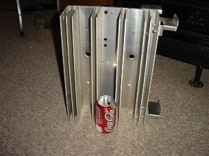

The sink is cannabalized from a 36vdc forklift battery charger.It also just happens to be the correct physical size for the sub box I have selected. One big plate-amp utilizing elliots 10 output P-68 , 8-band sub-woof equaliser P-84,P-38 signal detection circuit and several other supporting projects P-05,P-48 & P-23. The Woofer will be partsexpresse's 15" Titanic driver and its corresponding cabinet. As for the heatsink missing fins , Hmmm , I would,nt be surprise if a certain canadian moderator stole them. He does that @#$% all the time .Ya gotta watch him. LOL ...Well here in the states its Thanksgiving Holiday and I have to go cook a butterball and tune in a real football game in HDTV..
Cheers Dave
Cheers Dave
