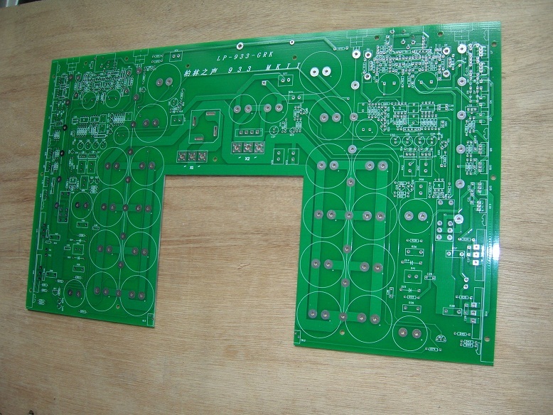

This is quality of YBL or Krell......for $35?? I don't want to build an amp, I want a really high quality amp!!! I already have a power amp that is over $1400 and I am looking for a better one.
That L12 will get you typical best buy stereo receiver audio quality.

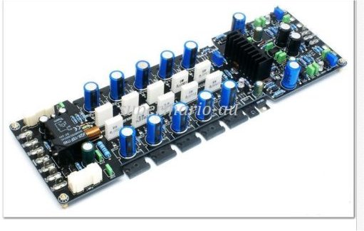

Some of the LME49810 ebay kits (below) or the "honey badger" (diya's kit),
will match or exceed many a 2K$ "audiophile" :D amp for hundreds (not thousands)
of dollars.
Don't let a cheap price fool you.
PS - the problem with the Ebay kits .... the designs/PCB's are often good , but the parts are
"dodgy" ! (junk - thats how they can sell so cheap).
