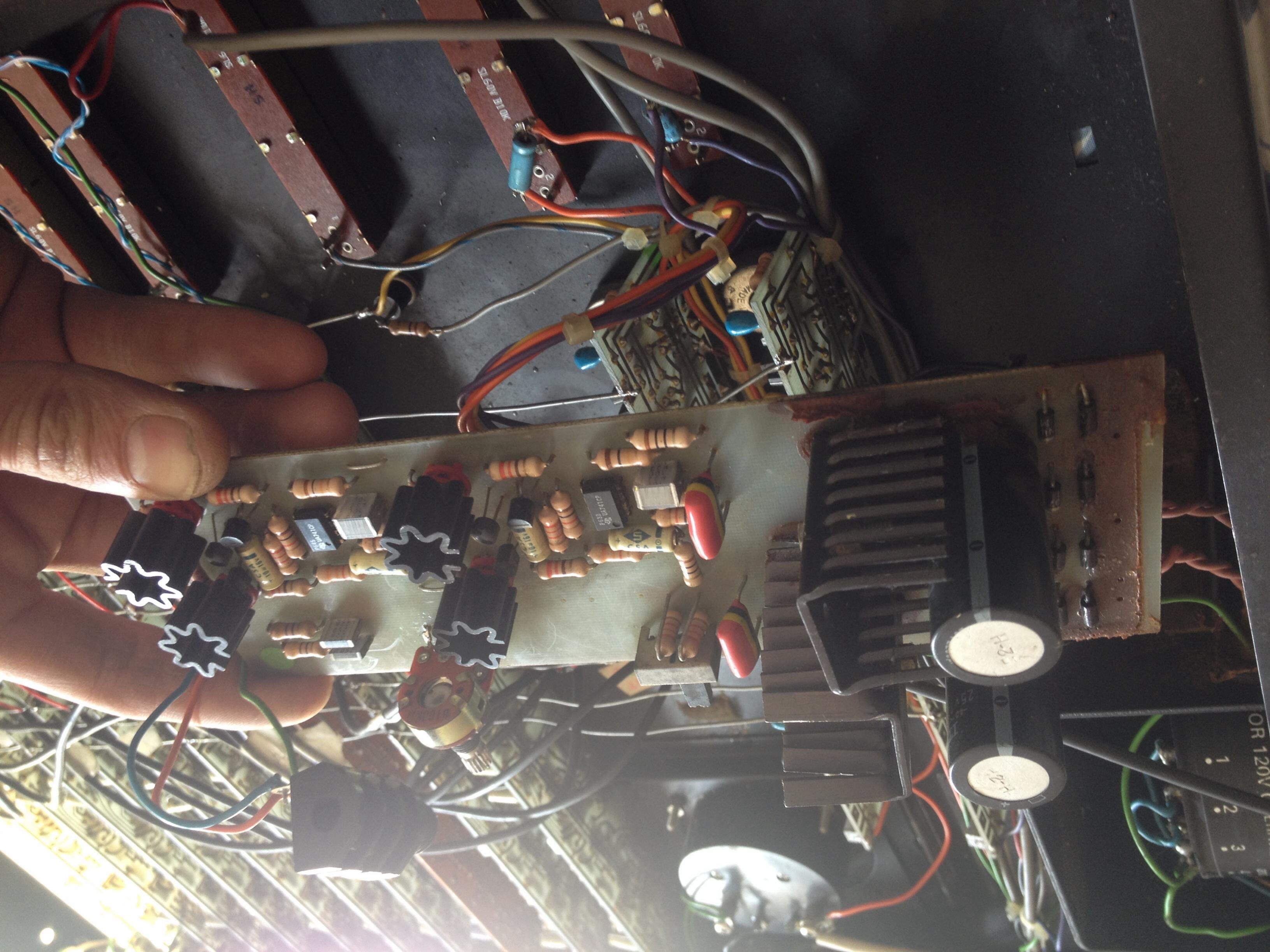

I have a 12 channel mixer I am upgrading and would like to know if the power supply it has can be optimized. The psu is on the same board as the headphone amp, and I am trying to figure out what belongs to what.
Can anyone, with a photography, tell what kind of power supply this is?
If the voltage from the wall outlet is 230, and the ac transformer in the mixer is wired for 240, could that affect the mixers behavior? Its feeding the powersupply 15vac which then outputs +-12vdc to the circuit. Other british mixers from the same era I have read about seem to operate at a higher dc voltage, and thats why I am wondering if its something worth addressing.
Attached is a photo.
As always, thanks
The 12v rails give you the max headroom (max output signal). Increasing the voltage will increase this, but you would have to make sure the higher V doesn't destroy any components.
What kind of mixer? Does it have +4dbm outputs or only -10dbm. If +4 you won't have much headroom (~10db).
I took out the original power supply and it has 8 rect. diodes, 2 larger filter capacitors, two 12 volt regulators, and 2 very pretty chewing gum looking capacitors (red, yellow, black, red. Would anyone know what these last ones do, if in paralel to the regulators? Can they be replaced by something worth investigating?
Have a feeling the mixer is -10 dbv, but will check when I reinstall the psu.
