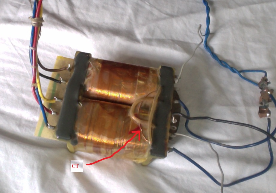

not sure, but the marked wire going from one coild to the other might be your CT point
the two small thinner white wires are for smaller curcuits
current on the thick wires should do fine for a small chip amp

The transformer secondaries was directly connected to the pcbs. Nothing i can follow.

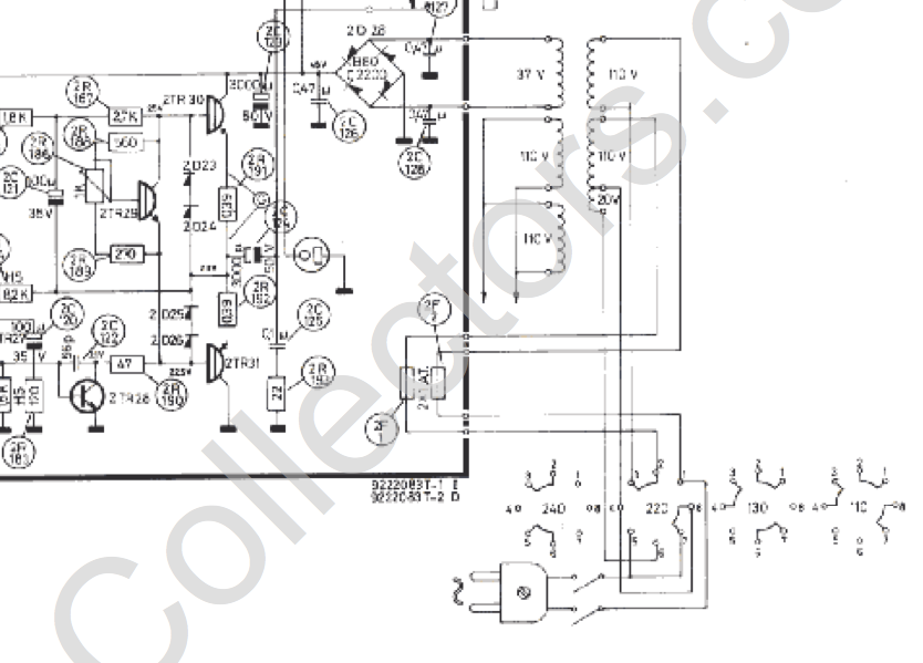

Dear troelsg: some of this discussion has wandered one way or another because we still lack some pieces of evidence.
You show 2 pictures: 1 of a transformer, with coloured wires and no voltage information; another of a black and white schematic, with voltages indicated but no mention of colours.
We may *assume* which is which, but may be wrong, and it's dangerous because we are talking line voltage.
To boot, the line side is multi-tapped so it is International, and, much worse, the transformer shown and the schematic do *not* match .
Let's start with the line side:
the transformer shows 5 wires on the left, top to bottom: brown/black/yellow/red/blue
the schematic shows on the right side 2 secondaries, one of them tapped, or 5 wires in total.
Please edit the schematic drawing and label each wire with the corresponding colour.
And show how you are connecting it to the power line.
Ths schematic shows a multi voltage selector which I guess you are *not* using, please show how yu are connecting that transformer.
Now to the secondaries (right on the picture, left on the schematic):
here we are in trouble because they do not match !!!
The schematic shows one main secondary (2 wires, no center tap) which feeds a main, approx. 50 volts *single* supply (using a 4 diode bridge ¿ HBO C2200 ? and a main capacitor ¿ 3000uF 60V ? ), the schematic is quite unreadable but it clearly shows a single supply power amplifier with an output capacitor, that's why I suggested that configuration for your amplifier.
It also shows 2 110V secondaries, wired in parallel, and exiting through 2 wires, so in total we should have 4 secondary wires ... but the picture shows * 5 * ¿¿??
The picture also shows an apparent center tap (¿black?), you claim to having read 37 V from the thin grey wires, lots of differences.
There also seem to be some unused terminals on the secondary side.
I don't know whether they are connected to something (the mysterious 110V windings?) or not , they were simply there on the terminal strip.
So *please* post a hand drawing like I said, showing clearly what is connected to what, with colours and voltages.
Otherwise it may be dangerous.

What picowall asks is to follow the tracks *at the PCB itself* to see where those wires go.
The ones which go to the main bridge rectifier which then feeds the main filter cap, are the "power" wires you should use.
I guess they are the thick blue ones on the right, but guessing without measuring does not carry you very far in Electronics.

No, but what can i do about that, other than assuming?
start by assuming, but then confirm by measuring.
PD: it looks like you have a center tap at the transformer secondary (black wire?), which is *not* shown in the schematic; if so, cool .
I *guess* the transformer and the schematic do not match, maybe they correspond to different versions of that amplifier, which might have remained in production for many years.

Sorry for the misunderstanding. All of the primary wiring is already determent. I asked this question in another tread and concluded the following:
"I tried the following settings. All output meassured on the black-blue.
240: Black-Blue connected/Current on Yellow-Red: Ratio: 13.222
220: Black-Blue connected/Current on Brown-Red: Ratio: 11.55
110: Current on Blue-Red. Ratio: 5.89
130: Current on Black-Yellow. Ratio: 6.91
Could this be the connections for the four inputs. I think it makes sense. It would create an output at:
110: 18.67V
130: 18.81V
220: 18.86V
240: 18.15V"
So i found the correct connections. My concern, when making this thread was the following:
Which of the two outputs should i use for a stereo amp configuration. The CT (Blue-Black-Blue) or the single secondary (Grey-Grey).
My other concern was how to determine the VA value.
I found the diagram online, and most likely it is from another model type. Nothing i can do about that, than ignoring it as useless.
I am very new to this, so i might be a little slow. I know the voltage outputs of the grey-grey (37) and blue-black (18.5). I have an estimated VA value at around 120. What is it that is should know more about??
The unused terminals on the right was never connected for anything, and i cant figure anything out by measuring.
The grey-grey and blue-blue was both attached as pairs at the pcb. The black was attached somewhere else. I will try to get the correct diagram from B&O.

Thanks again, and this is the data i have. All wires are orignal
Meassurements.
Secondary side:
Grey-Grey: 2.0 (200) ohm
Black-Blue: 00.3
The resistance between the red and black tip: 0.00-0.01
Pretty spot on, i must give you that 🙂
Thanks again
Good !!
Now you *know* that you have a good transformer, about 100/120VA 19+19VAC secondaries, perfect for 2 x LM3886 chipamps.
Tape insulate and tie all unused wires, so they don't accidentally cause problems and you're done.
