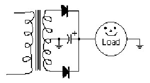

Hi all, Can I use a 10-0-10v ,1000va torroid in conjunction with caps etc to power a class D car amp?
Where will you get your primary voltage from?
The class of amp is a seconadry to what the amps input voltage is, if it's a car audio amp 12~15v then yes, you'll get about 14+ volts D.C. from one leg of the supply in bipolar mode. I sugest you use the transfo in half duty mode it'll give you more or less the same out as a single leg, but load both seconadry instead of one.
