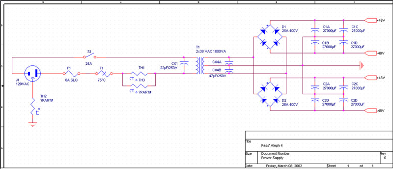

Gabriel,
Its about 1.00 am in the morning so like keep the result short.
Using the approach as per our previous posts (ie like your diagram it works! No hum or buzz.
If fact I had to turn off the fridge in the kitchen to hear the noise from the speakers... only a very faint hiss and very minor hum with my ear about 4 inches from the woofer ( all eighteen inches of it @ 96 db).
I will be delighted to hear (and see) how your Aleph 4 project turns out.

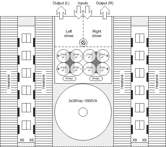

Excellent! 😀 Thanks for supporting my project. Now I can start to build The Thing with peace of mind.
Next step is to find heatsinks with a very high density of fins. Based on my casing limitations, each of the four heatsinks (2 per channel) must be 15"x5"x1.5". Do you think such a heatsink can cool 125W of heat down to an acceptable temperature? What could be a comparison with your Aleph 4? [Note that the heatsinks on the sides will be mounted on a 15"x5"0.5" aluminum flat bar]
I'm affraid I'll have to have those custom made.
best regards,
Gabriel

Nothing is overkill when it comes to the Aleph and heatsinks.
I asked him about this, and he said that they would run a little hot to be commercial units. If you look at the page on passdiy.com, he states the temperature.
I bought some heatsinks for mine, and I was considering the same setup. I got 8 heatsinks that are 8"x9"x2.6" I am planning on the same arrangement.
Brian
