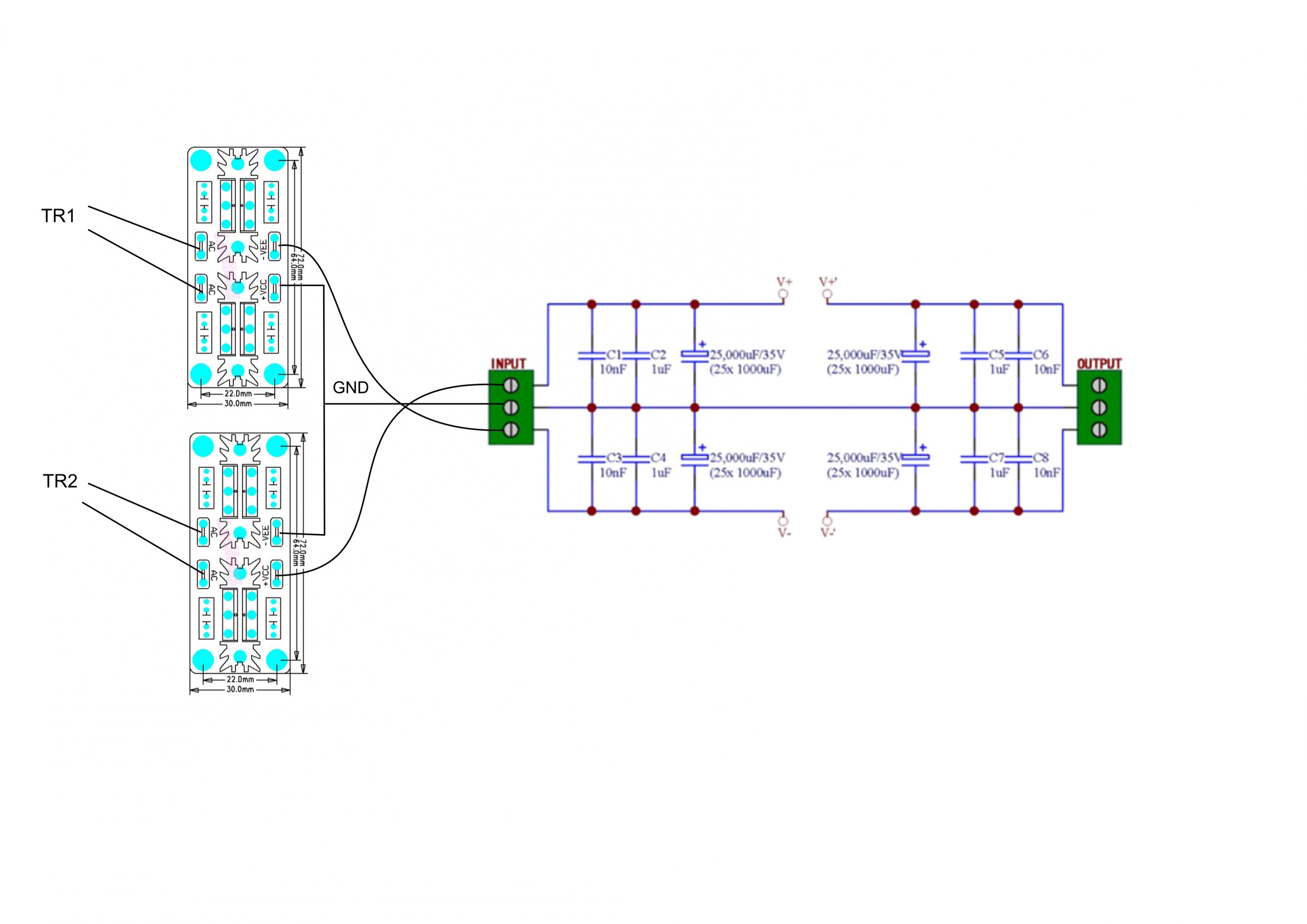

I'm putting together a power supply for an A class aplifier. The power supply will have 600-700 W delivering two rails 45 V.
Not sure what diodes will use yet i have a choice 30CPQIOO 30CPQ150 60CPQ150 or MUR3020PT MUR3040PT MUR3060PT. I think i will go with shottky's
Here is a first draft, please chare some thoughts
I recommend you remove all the non electrolytics from the PSU.
Locate the local supply rail decoupling where the current demand changes, i.e. in the amplifier.
Locate the transformer snubber on the transformer output taps.

The biggest problem with schottkys and ultrafast rectifiers is their relatively poor non repetitive peak current capability. Even if the rectifier itself is infinitely robust, the bonding wires inside a TO247 will simply fuse somewhere not too far north of 100 amps with a single half sine pulse at 60 hz. Average capability is 75A and that's it. Charge up too many uf and you're done. Compare that to the 300 to 600 amp rating of your typical 25A standard recovery bridge. If you really want to use schottkys it may pay to find some old DO-5's because they will take the beating of cap charging duty. I doubt there are any still in production, though.
Andrew why should I remove all the "dry" capacitors? I use them to remove noise. 105's for low frequency and 102's for high frequency noise.
The ce on question is what should I do when I locate the snubber and rail?
