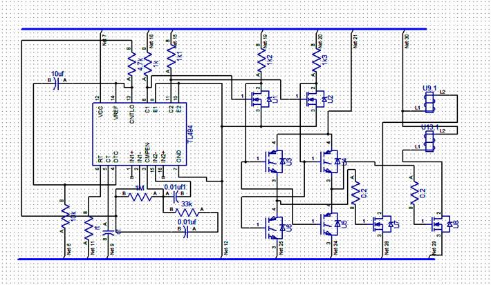

Thanks for your help Eva
I’m currently at work so schematics will be posted later on.
Here is a brief description of the circuit
I’m using a TL 494
The output of the chip is inverted by two mosfet and then fed into an H bridge which drives the 4 + 4 mosfet. i also used mosfet for the H bridge. The waveform at the gate of f the 4+4 mosfet is reasonably clean. The output of the H Bridge is capable of driving low impedance load. So it charges and discharges the gate fairly fast.
Thanks for the tip on spikes.
I’m using a TL 494

This schematic is not complete. Note that pin 1 and pin 16 are not connected. I’ll post the completed version as soon as I can.
I’ve measured the spike at the drain of the mosfets as Eva suggested and they are equal on both sides. I also measured the gate wave form, I noticed that there are considerable spikes on the gate of one transistor when the other switches on.
I paralleled 4 mosfet on each side with individual gate resistors. Please for five my transformer symbol .
