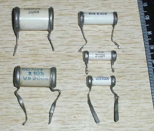

I have good expiriences with bypassing elcos with PIO's. At high freqs oil caps are quite good- I have some infos about ESL of russian oil caps- medium size have ESL 30-60nH, but some types have non-inductive construction (they were designed for filters and pulsing currents circuits) and they have ESL 6-11nH.

IMHO rather not. In my previous post my info were about following types KBG-MN(medium size) and KBG-I(non-inductive). Biggest avaible capacitance of KBG-I is 100n/250V and less for higher voltage.
Photo of KBG-I:
Those caps are indestructible 😀Uchi Deshi said:
Photo of KBG-I:
Ceramic casings with brazed metal ends, hermetically sealed. Truly military-stuff.
