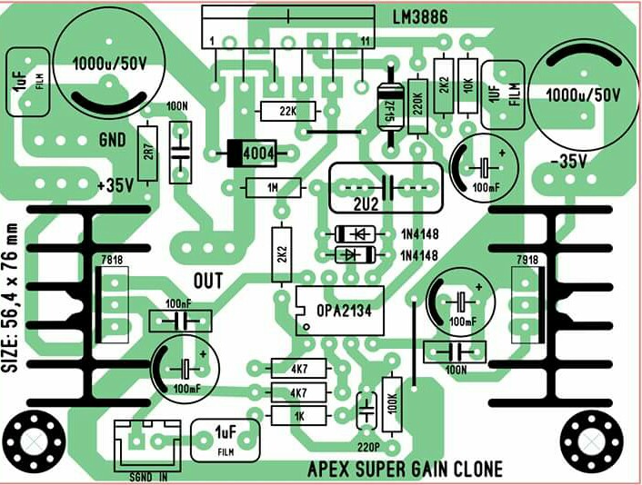

one thing i forgot to say, as you know tomcr recommends 1000uf elec, 22uf poly & 1uf x7r for lm3886.
i am noob, so my knowledge is very limited; but i think op-amp gbwp plays an important role.
Probably overkill, but it does not break the minimal rules: no paralleling of capacitors having a ratio larger than 1:100.
They do not guarantee the absence of nasty resonances, but at least they do not guarantee their presence.

So you are saying i should go for 1:100 rule? Simple but effective way! if so, then that's what i wanted to hear 😉 😀
Do not misinterpret what I said: in general, over-decoupling with >100 ratio brings more problems than benefits, but ideally you should remain well below, 10 to 50 for example.
