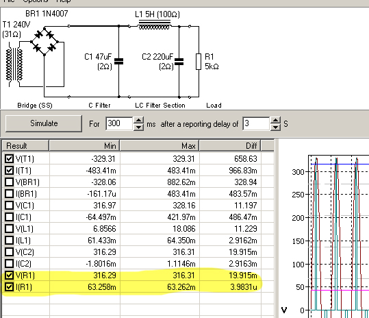

I have downloaded PSUD2 and experimenting with component values of CLC power supply for RH84 SE amplifier. Am looking for ideal values to aim for. Being noob I dont know how much ripple amplitude will be OK or such things. My Secondary supply is 0-250V separate for each channel. I have tried various Capacitance value after secondary; various choke values and am getting 2mV to 10mV (Third column in the PSUD2 software).
Best would be if you can give straightforward component values for two capacitors and choke (current and ohms ratings) as I dont want to go overboard but still have more than enough margin to be safe for my first build.

here is some rough fiddling with PSUD. See attached pic. and yellow highlighted data. Would this be ok ? There ought to be some ball park figures for powersupply Capacitor and choke values. going overboard can be counterproductive ? atleast tell if both C1 C2 should be same ? or lower value at transformer side ? Choke value would also probably some specific value (for this RH84 amp only) Going for higher value would have deminishing return. isn't it? give some clues and guidelines.
Original RH84 had only 47uf-10H-200uf. 200uf aftter transformer will have detrimental effect on choke ? Choke had 100mA capacity for both channel. So can I get away with 50mA per channel for my dual separate amp ?

....give straightforward component values for two capacitors and choke (current and ohms ratings) as I dont want to go overboard but still have more than enough......
Why are you asking here? Read every schematic you can get your eyes on. ESPECIALLY commercial products which had to satisfy many people or the designer would be out of work.
While supplies for "same as you want" (say two 6V6 in stereo) are good, you can allow for mono (half) or 6L6 (double) etc.

my last build / EZ-81 - 100uF - 10H - 100uf
.... point; if someone works out the values for you(quite a bit of work) you'll have learned nothing.....
I approve of learning. But I can also approve of taking known-good values without much further thought. Most 'new' designs are VERY similar to designs which came before.
The question of ripple in an SE amp is non-trivial. But frequently you do better with clever leverage than brute force lumps. Multiple C sections. Separate screen filter.
I converted an old console stereo to RH84, and used 47uF --> choke --> 200uF similar to what the OP is simulating. That worked fine (choke value unknown). I would suggest go with that, you could leave room to add another cap later if you're worried about it.
