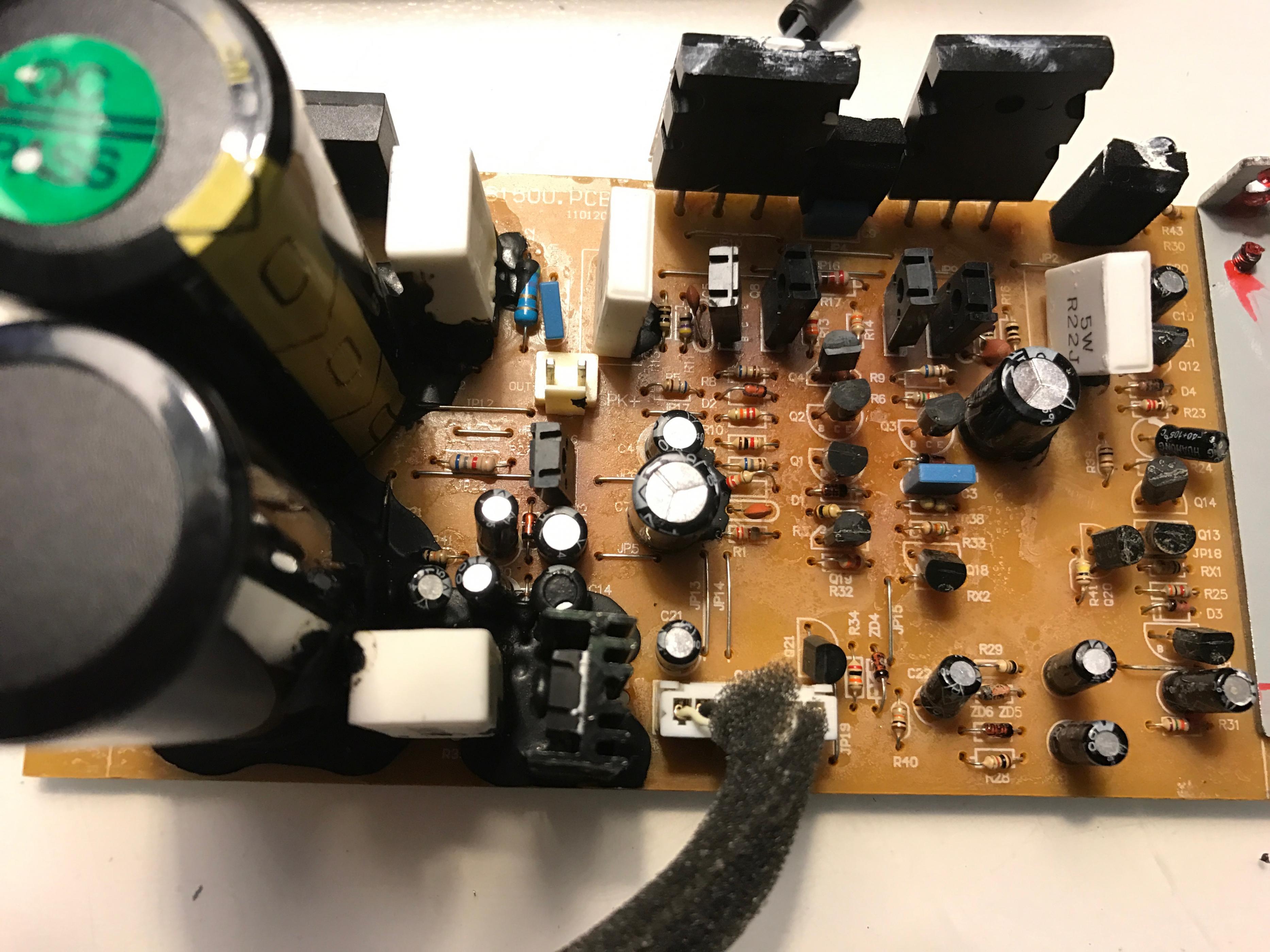

I have gone back to the factory wiring including the XCAP, and checked the secondary voltages -
either yellow to center tap - 41volts
Then I plugged the secondaries back into the power board and got back to 55.5 volts across each power capacitor.

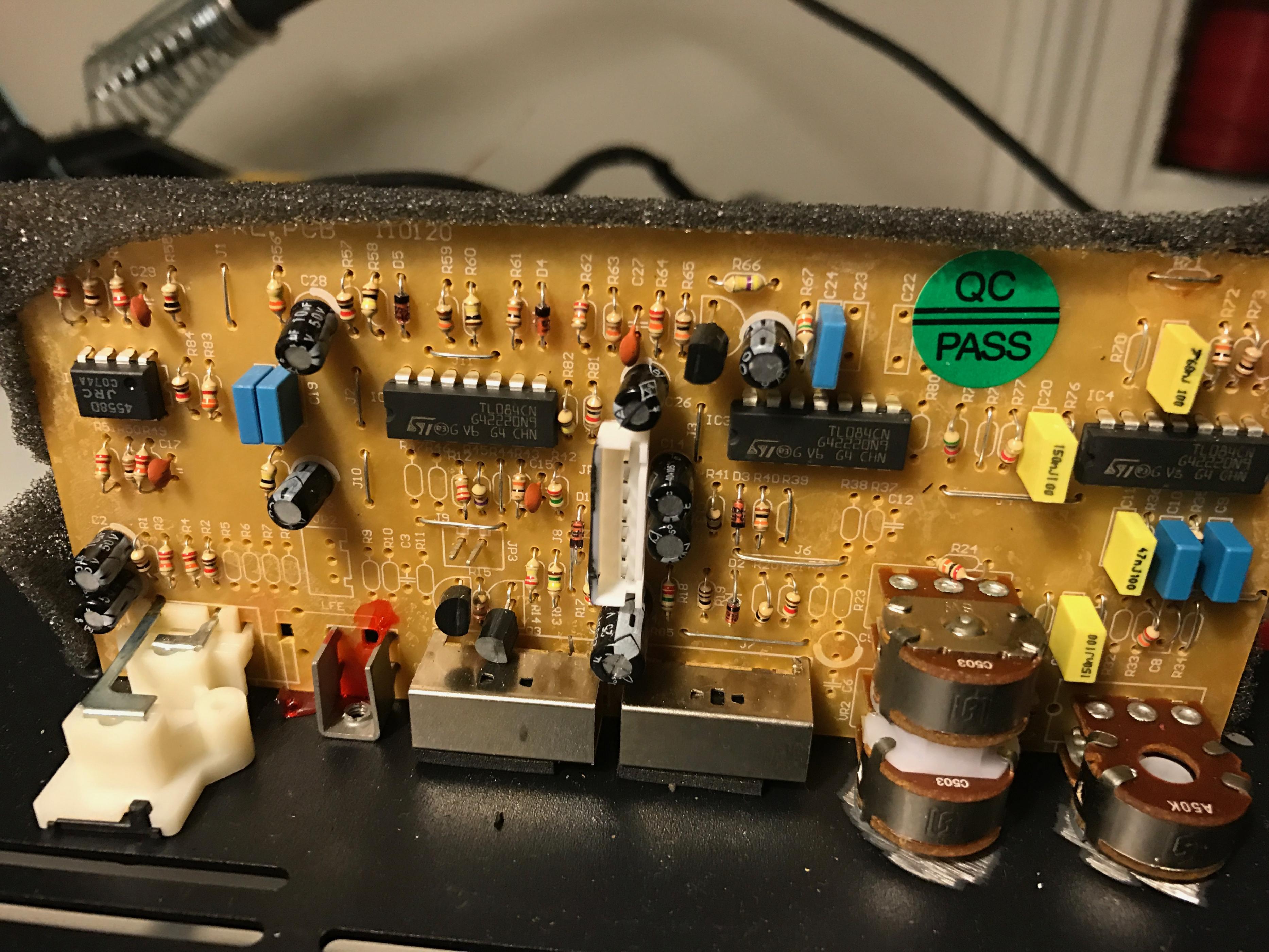

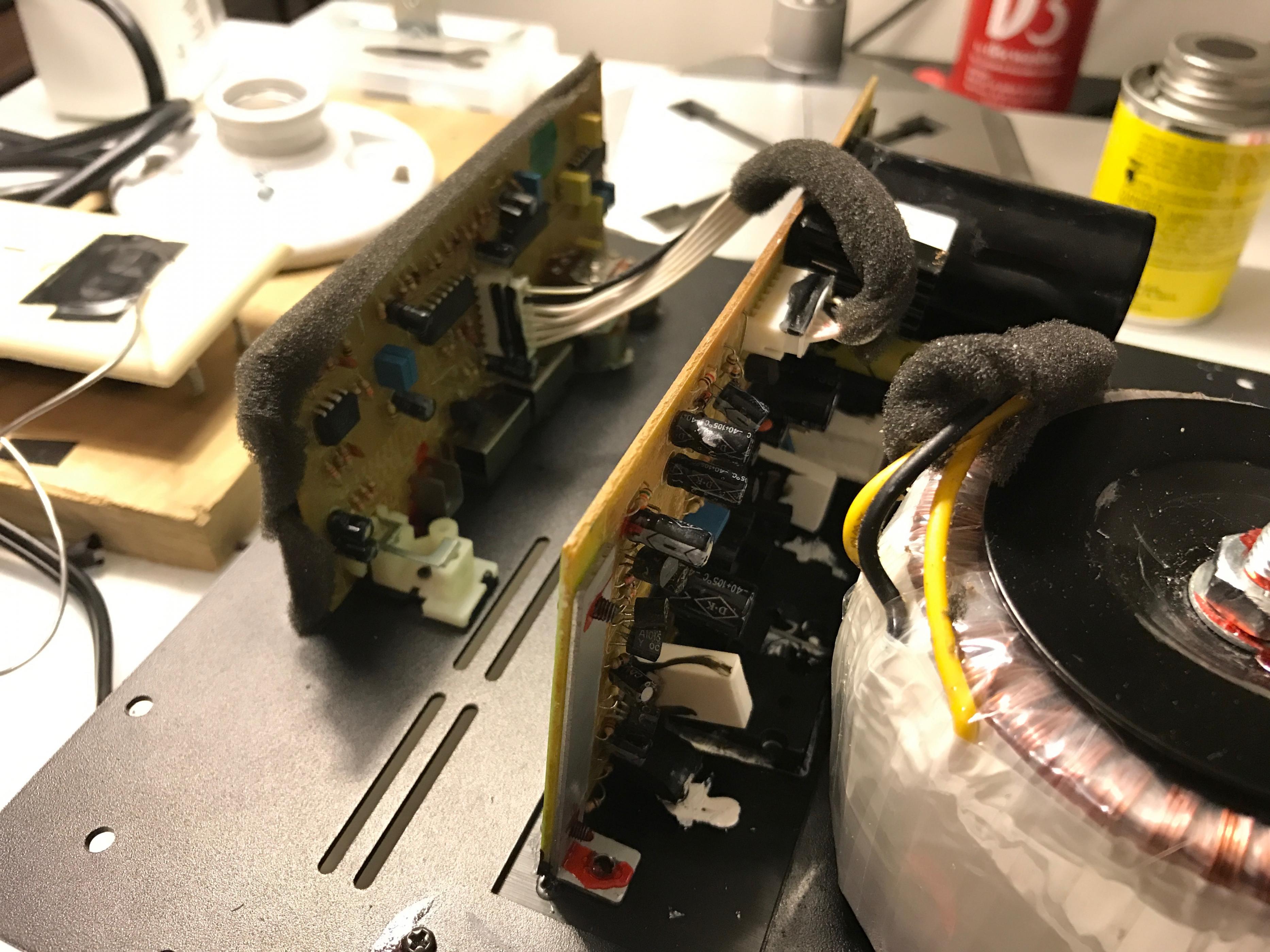

I have included a pics of the power board, preamp board and how they interconnect.
From the User Manual for this subwoofer:
https://www.martinlogan.com/pdf/manuals/manual_mlt2.pdf
"The subwoofer will turn on when it receives an input signal and the LED will turn Green. If no signal is sensed for a period of time, the subwoofer will automatically switch to Standby and the LED will turn Red."
The symtpom is that this LED does not turn on at all, regardless of the presence/absence of an input signal. That's why I began debugging with the xformer and the power caps.
As you can see, the power board has many components on it and I don't have a schematic. I'm really unsure what may be the next steps in debug, especially without a schematic.
As always, thanks for your comments in advance.
