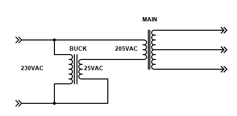

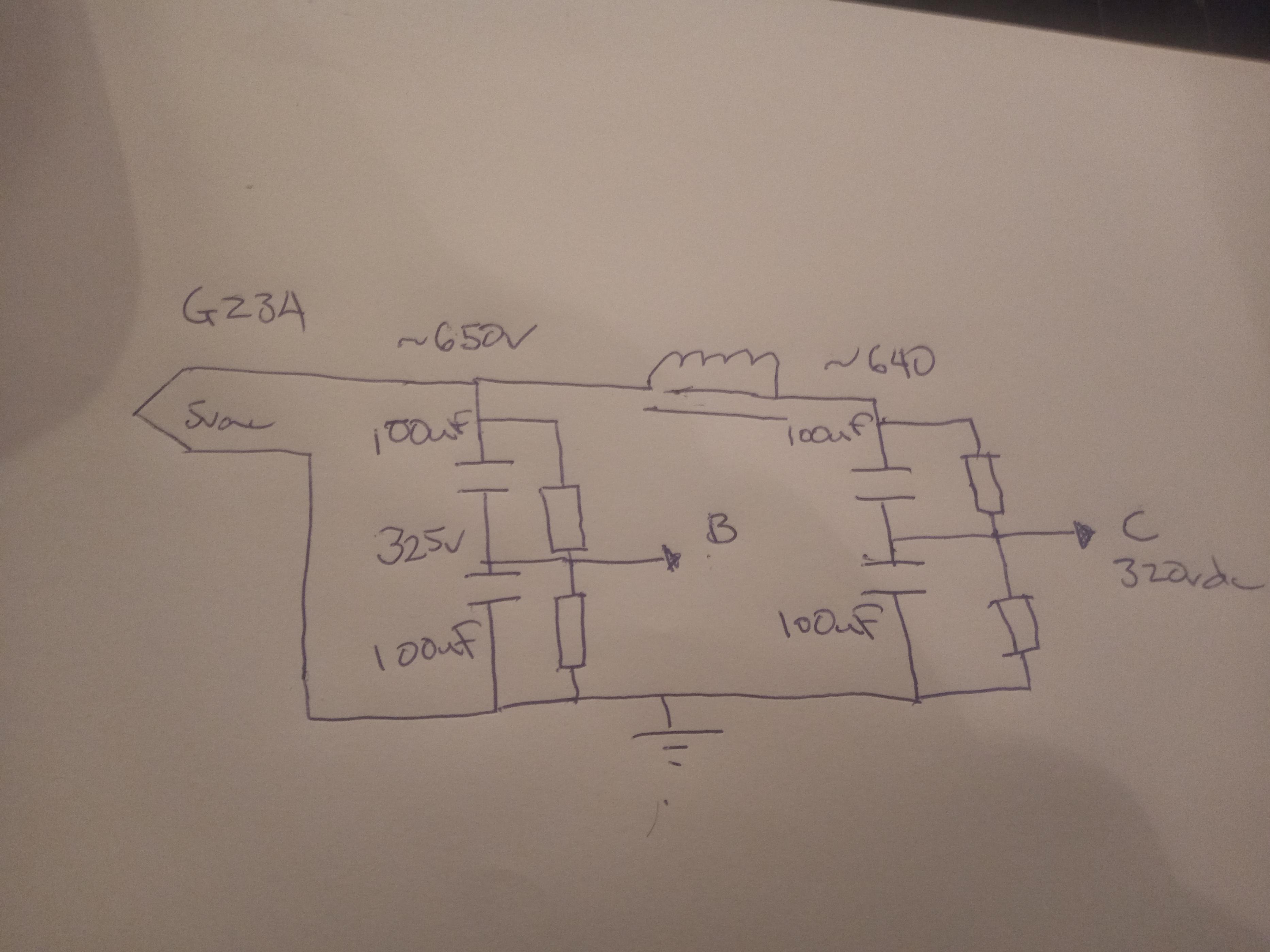

Hello guys, my first attempt at guitar amps. I'm repurposing an old Hammond power tx from previous valve projects. The issue is, it is a 500-0-500vac tx (200ma), so awkward for anything guitar amp but it's what is in the parts bin so it's what's going to be used.
Looking at it, I can get the voltage down to around 330v-350vdc resistively and generate a bit of heat. Drop it down with a choke input, but the chokes I have for that are massive and heavy... I was going to go for resistance then realised I was going to have to stack two caps for the reservoir. This is when I thought about, why not just take the B+ from the junction of the two caps (parallel resistors to each cap to balance and also as drain) to get me in to ~330vdc.
Then, as I've been reading about 'power scaling', another brain fart, could I not just stack 4 caps at the input and use a switch to tap the dividers for different voltages rather than use a MOSFET (and the bother of heatsinks for the chassis) to scale the output power?

Won't work, use a bucking transformer instead. This example reduces the secondary voltage by by 10%.
The current capability remains the same.
Choke input filter is an alternative for reducing the voltage also, if it is adequately rated.

Do what Hammond did. Very heavy choke and oil capacitors. (I hope you saved them; they are costly to buy.)
As Rayma says, you can't pull DC from a capacitor "divider". Bucking is good for 10% maybe 20% but 50% is getting silly (your bucker is half the size of your main). 700V, 630V, 560V maybe; still way more than any sane guitar amp.

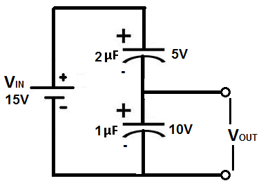

Quote:
Capacitive DC Voltage Divider Circuit
Voltage is divided up in a capacitive DC voltage divider according to the formula, V=Q/C. Therefore, voltage is inversely proportional to the capacitance value of the capacitor. So, the capacitor with the smaller capacitance will have the greater voltage, and, conversely, the capacitor with the greater capacitance will have the smaller voltage.
Below is an example:
The supply DC voltage in the above circuit is 15V. This means that this 15 volts will be divided across both capacitors so that the voltage dropped across them both will equal to the 15-volt supply source. Assuming both capacitors hold the same charge, Q, the voltage can be calculated just from the capacitance values of both components. Being that the the 2μF capacitor is twice the value of the 1μF capacitor, it will have one-half the voltage. Therefore, the 1μF capacitor will drop 10 volts across it, while the 2μF capacitor will drop 5 volts across it.
End quote.
What am I missing? Why can't I pull DC? I'm not an engineer so it might be very obvious.
The series caps as reservoir will amount to 50uf that the GZ34 will see and will be within what the rectifier can handle. I thought maybe I could tap it both sides of a choke for plate and screen. Seemed too good to be true so I'm just asking for my own understanding. Thanks

> Quote: Capacitive DC Voltage Divider Circuit
Please say where you get such teachings. In this case I found it on one of the explanatory sites that everybody knows, which does not mean they are right.
Possibly this one. Capacitive Voltage Divider
"DC" is a long-term condition. Long-term, the average current in a capacitor sums to *zero*. This is why we use capacitors to block DC from speakers. This is why a cap across a power supply does not heat-up and die.
Their proposed solution is valid for the instant that the battery is connected.
Yes, 15V DC applied to 2u and 1u in series will split 5V and 10V. At first. Any load will bleed it to zero. Using 1Meg as a sim "meter" it will bleed in a second. The several-K equivalent load of a power amp will bleed faster than you can blink.
There are, as always, more complicated ways to connect more parts and find a different result. Four electronic switches working at fast rate could change the 1u to 700V and dump that to the 2u for 350v. (Some choke would be needed to avoid infinite current spikes.)
You can pull dc current with the two paralleled resistors in place (or even with only the upper resistor in place) but the dc-current only flows through the resistors. Nothing except for the ripple current, which is an ac voltage superimposed on the dc voltage, flows through the capacitors. So you wind up were you started: This arrangement produces pretty much the same amount of heat as a 'normal' dropper resistor would. It is as if you would put a capacitor parallel to the dropper resistor. And if the amplifier you want to build is not a pure class A amplifier, than the regulation with such large dropper resistors will be very poor (you will have a lot of 'sag').
You could use a choke input filter like others already suggested. That will reduce the voltage substantialy compared to using a capacitor input filter (estimation: with about 180 V). The regulation of this type of filter is pretty good. On page C of this datasheet for the GZ34 (= 5AR4) you can see what voltages you roughly can expect at different current draws:https://frank.pocnet.net/sheets/030/g/GZ34.pdf
