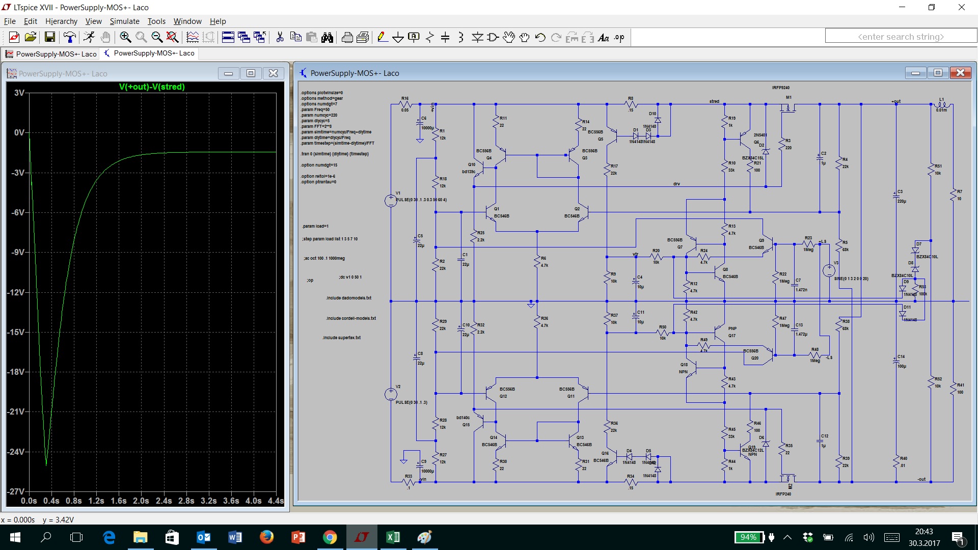

Smaller voltage drop on MOS regulator
Hi Damir,
I was playing with your MOSFET PS regulator and my simulation is showing that I can reach voltage drop between input and output very small - less than 2V. I made it via changing values of resistors at input divider i.e. R1=12k, R18=12k and R2=22k. Is there any practical risk to assemble it this way?
Thanks,
Ladislav

Hi Ladislav,
This is not good approach, you need some margin to regulate in case of high load. Yu have to take in account that input voltage is not pure DC, it has 100Hz superimposed coming from a rectifier with big caps, with higher amplitude as the load get heavier. That is why it is called regulator.
BR Damir
