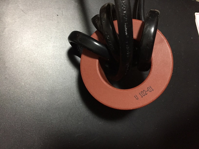

Hello,
I recommend VITROPERM 500F core.
It is effective for audible frequencies.
It is my favorite.
https://www.vacuumschmelze.com/Assets-Web/en NanocrystallineVITROPERM-EMC-Products-2016_01.pdf
It is my favorite.
