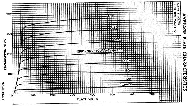

I'm a skeptic at heart..... If we change the operating voltage of the power section (lets say 6L6 tubes), won't this in turn change the saturation characteristics, and thus ultimately the tone? The plate characteristics at 300V, on the 6L6, are different from those at say.... 100V. From the purist perspective, this fact alone would imply different performance at lower voltage -> thus a different "tone" and distortion characteristic from full scale power - which is supposedly the holy grail of guitar distortion to begin with.
Another thought: are the negative tonal effects of a power attenuator less or more desirable than operating the output stage tubes a lower voltage and saturation characteristic than full power?

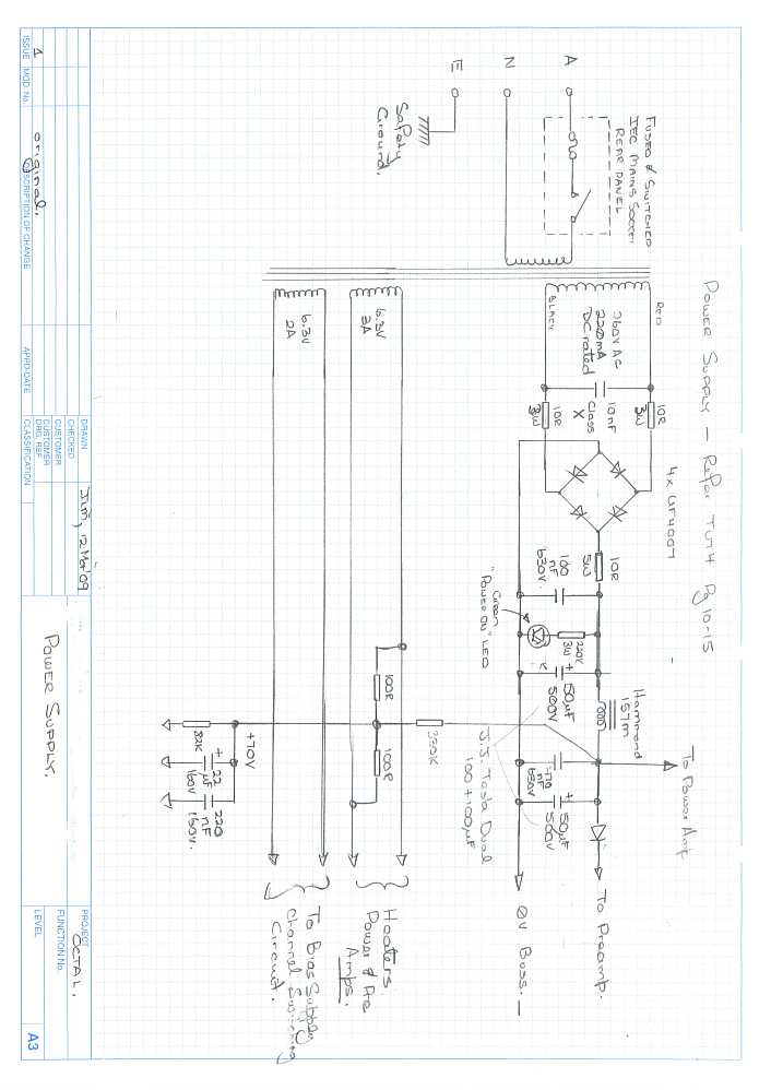

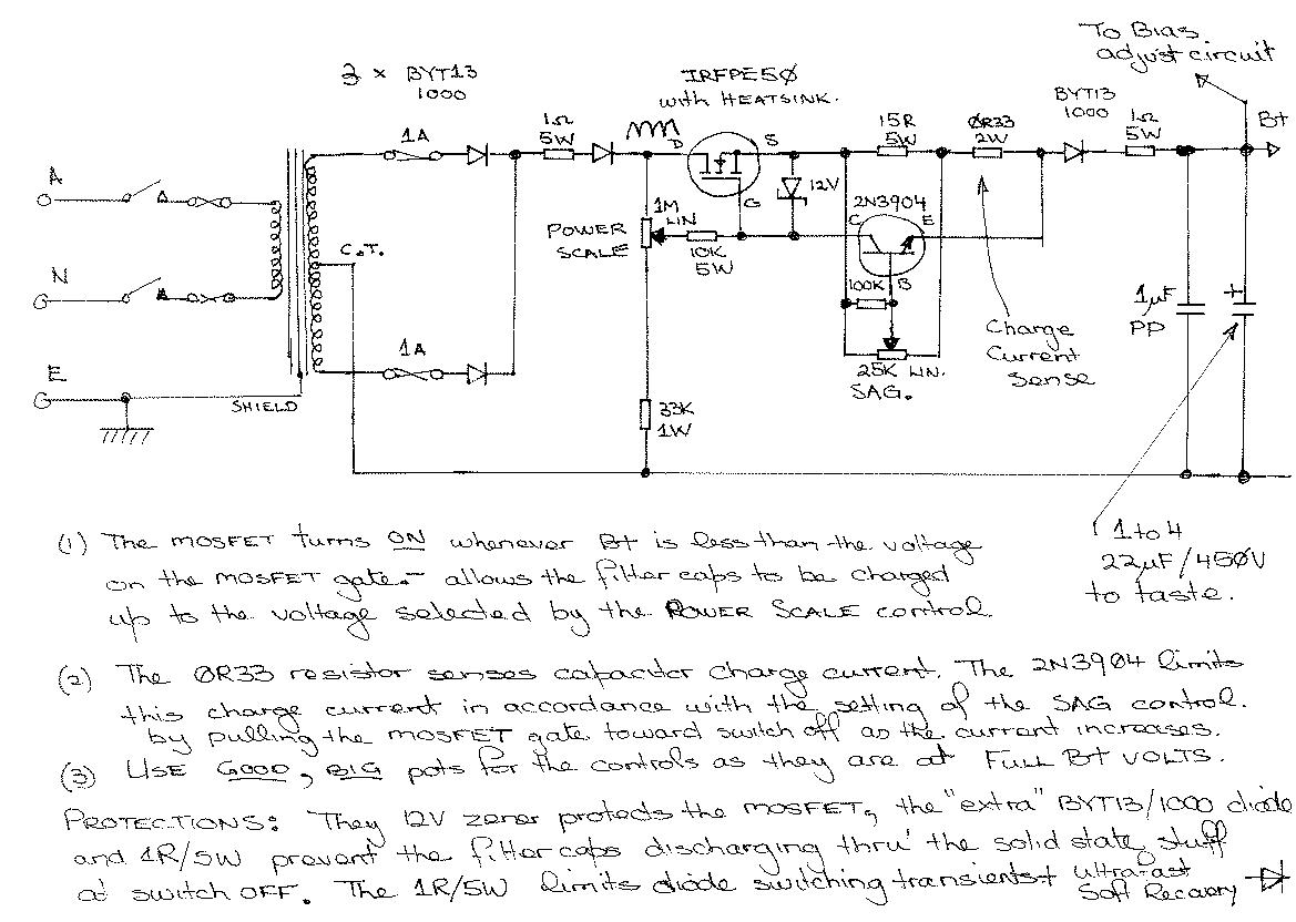

I built a "Standard" from TUT5 with Power Scaling. This is the "simple" method scaling not the more sophisticated DC method powerscaling which you realy only need if you want to switch powerscale levels when you switch channels. I don't see the need for that.

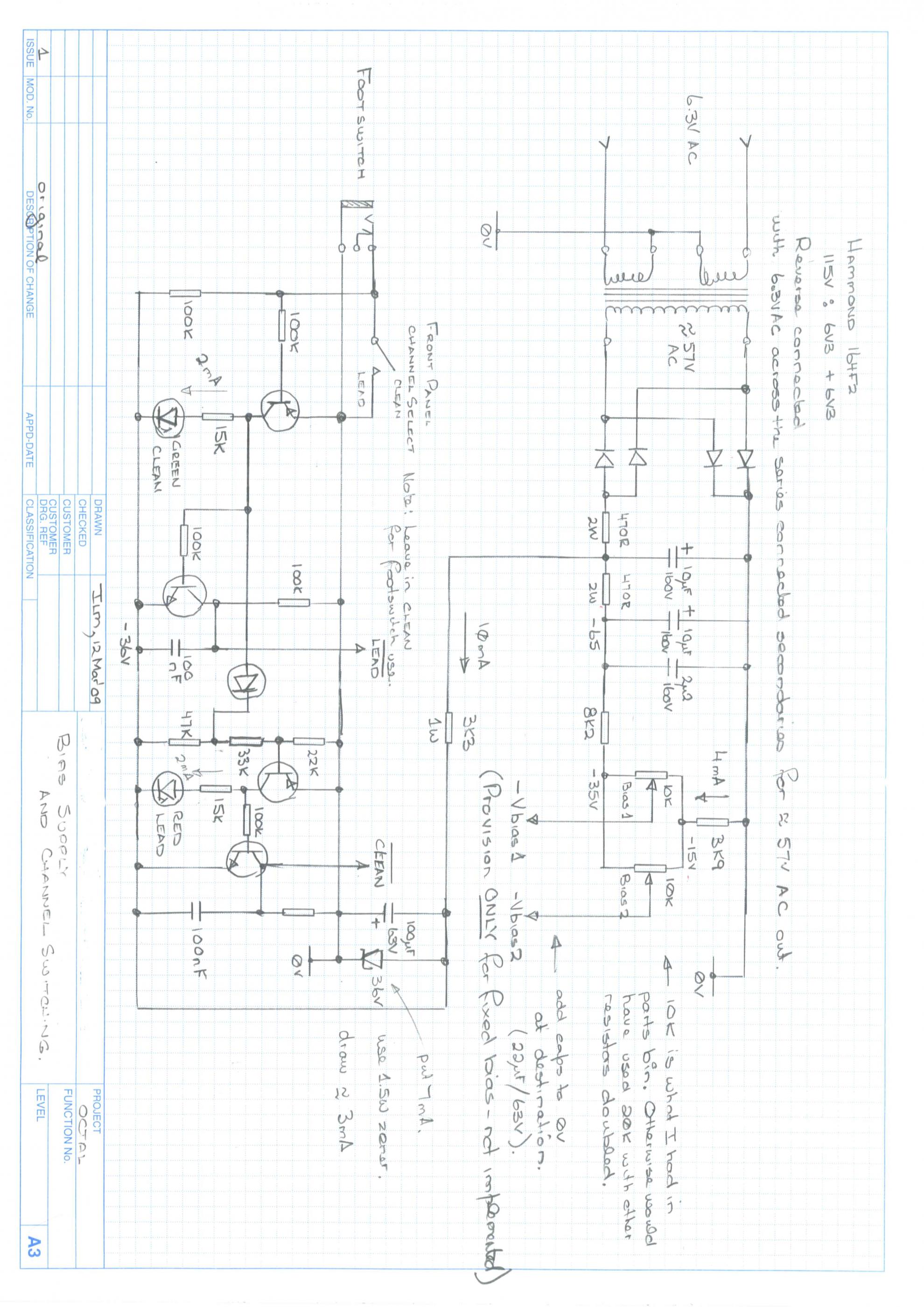

I made a few minor mods to the TUT5 schematic. I deleted the "Body" Control (mostly because I ran out of front panel space). I used a quad of 6V6 in to a JTM45 Output Tranny for the power section. The triode/pentode switching and the fixed/cathode bias switching I did on a per pair basis rather than on a per output tube basis.
The VVR circuits I've seen use an identical method of power control, that is mosfet level switching of the raw unfiltered but rectified supply.
If the amp is fixed bias you do need a tracking bias supply regulator.
These are my set to work notes showing voltages:
A quad of 1960's 6V6G for the outputs
Each output tube pair switchable between triode mode and pentode mode, and each pair switchable between cathode bias and fixed bias.
The power scaling adjusted anode and screen voltages to the output tubes ONLY, phase splitter/driver and preamp supplies were not "scaled".
I included the "Compression" or "Sag" control which is just a variable current limit and the Voltage control MOSFET.

Note in fixed bias how the bias tracks the B+ adjustment via the tracking bias regulator.

The idea of teh tracking bias is such that the output tubes are working on similar tranfer function curve at all levels. The "Drive Compensation" Control is there to balance preamp overdrive an dpower amp overdrive. When you power scale teh power amp way down in power you obviousley need to reduce the drive into the power amp.
By judicious use of the powerscale control together with the drive compensation control you can get VERY similar sound/tone from bedroom whisper to stadium crusher levels.
Here is something I scribbled up when explaining powerscale and compression (sag) to someone else - based entirely on Kevin O'Connors circuit.
Ian

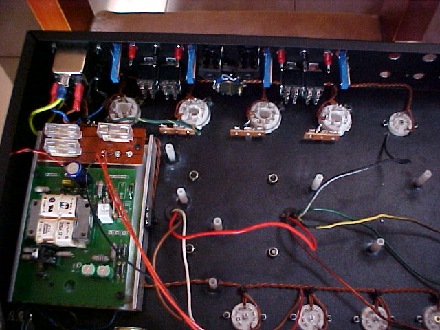

I originally posted this stuff at Powerscaling.com which has since disappeared. There was a whole build thread there.
I used Kevin's TUT5 schematics and board layouts and one of his powerscaling kits with just minor changes. Those changes were just my preferences. I've been tube audio hobbying for quite a while (particularly in HiFi Tube Amps) and am an Electronic Design Engineer in the day job so I'm confident and relaxed about making changes.
One of my HiFi tube amp designs over at DIYAudio has been built by 50 or more guys around the world.
It made sense to me to divide the output tube quad into 2 pairs and provide cathode/fixed bias switching and triode pentode/switching for each pair. The original standard provided this switching on each output tube. Since I was doing that the "Body" control which effectively puts a post phase inverter (post PI) "master" control on one side of the push pull to "pan" between push puull and a pseudo single ended was also left out.
Attached is a during the build shot, shows the output tube sockets, the bias adjustments and monitoring points and teh fixed/cathode bias switches and teh triode pentode switches. You can also see the powerscaling board. The blue things poking out from teh rear panel are 10 turn Bournes bias adjustment pots.
I used the same "Standard" preamp for my own guitar amp which is a single pair of 6V6 and no powerscaling. Also use all 6SL7 instead of 12AX7 for it.

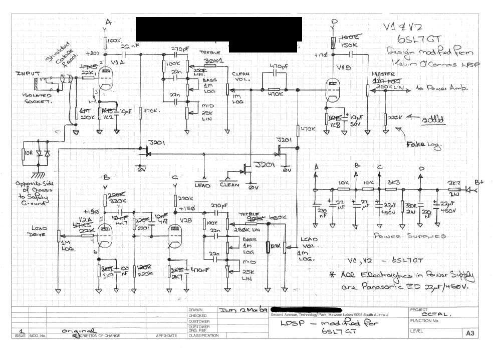

I ONLY have untidy schematics but here they are:
The Power Amp has some experimental stuff on it which was a failure, that is, current sources in the output tube cathodes for biasing, this worked but had the worst overload characteristics of any bias method I've ever tried. I ended up using fixed bias. Links are drawn as if that bias method was still being used.
Mods I would do today would be bigger grid stops on the output tubes (say 22K) and a 470K grid stop on the concertina triode.
