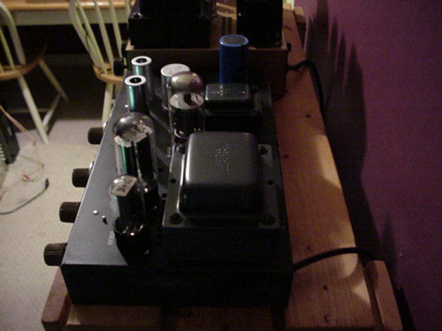

best thing to do is to tape it off and paint it. looks as good as removing it. and its faster 😀
Okay I inspected the amp really well with a flashlight and poked around a bit for loose connections. I found two which I would have not of found without a flashlight. I tried plugging the amp in again, but I am too scared to wait for something to smoke. I noticed that I didn't hear a sparkle from the rectifier tube which is good news. The power resistor gets very hott to the touch after 10 seconds or so. Should I try a higher watt resistor? Thanks again for your time.
I painted the transformers with Rustoloem Black Satin Spray Paint. The insulation looks alright to me. No more sparks from the tubes, but the power resistor still smokes alittle bit. Is it just because the resistor has gone bad? I also can't find the resistor's value which is 350 ohm should I go lower and get the 330 ohm or the the 390 ohm? Thanks for your time in this matter, Kevin.
The resistor does not smoke right away, but gets too hot to touch. I don't have access to a variac which makes the job much harder to figure out. I will try measuring the voltage across the resistor and from the transformer to see if that helps. Anymore suggestion would be great. Thanks a bunch for helping this newbie.
