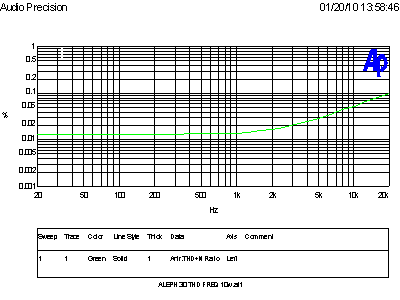

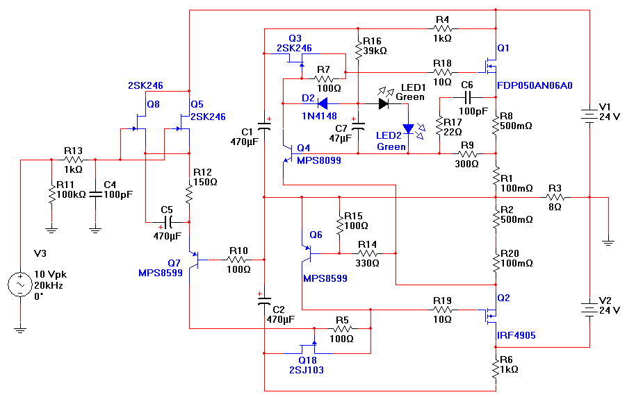

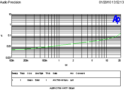

Here are the schematic and distortion curves of my SRPP power buffer what I built.
The bias current is about 0.75A.
The AC gain is about 85% in order to let it work in Class AB mode.
If the AC gain is 50%, it cannot work in Calss AB mode.
