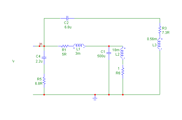

an amp rated to operate into a 4ohm speaker is much more highly stressed than a 2r0 test load.
Even 3r7 is not as severe as 8ohm reactive to 60degree phase angle.
I usually check the 10degree phase angle load at HALF the lowest value of operating speaker load.
i.e 4ohm 10degree and 8ohm 60 degree for an 8ohm capable amplifier.

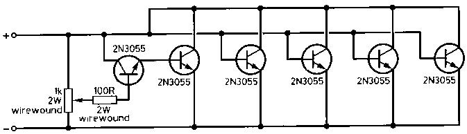

Here's a "transistance" electronic load that's infinitely variable. It can be jazzed up with voltage and current meters, a cooling fan, etc.
http://www.qsl.net/vu2upx/images/psu6.jpg

Okay, I thought the subject was power supply dummy loads. Duh.

Hi draynes,
Only your first two 2N3055's are connected correctly. The rest have a base to collector short, they are fancy forward based diodes. 😀

anatech said:.... they are fancy forward based diodes. 😀

anatech said:Hi KSTR,
Yes, but it should be a non-issue for this thread.
Hi draynes,
-Chris
Yeah, just noticed that myself after looking at it closely. I had gathered up the parts for this thing but had never got around to building it. Oh well, the concept is totally valid for DC testing.
At work I've used constant current electronic loads like this for battery testing. One project I got involved in some years back was manufacturing and testing thousands of battery backup supplies used in cell tower installations. The discharge testing phases were all done with transistance loads in order to maintain a constant discharge current.
I forget now which Asian company made the electronic loads we used, but they were essential for the job. Resistive loads would not have worked.

Yes it is. Consider feeding a pulsed signal in, or rectified music to test regulated supplies. You could also feed in white noise. There is no way the draw needs to be constant, just a known quantity. Faster transistors may work better in that case. You could even simulate a loud transistor radio and 9 V battery.Oh well, the concept is totally valid for DC testing.
This also eliminates errors due to connection resistance that come into play with resistors.The discharge testing phases were all done with transistance loads in order to maintain a constant discharge current.
